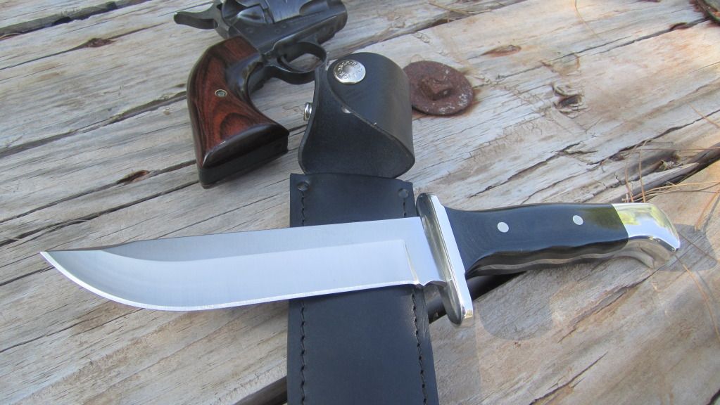

So by your definition the full tang of the 124 with the addition of a larger grip and pommel that covered the tang would turn it into a knife that was no longer considered full tang because it was no longer exposed?
Yes.
If it's not full tang.......it's not full tang.
If the tang is not full......it's only partial.
That should be easy enough to understand.
The 119 Special is a full tang, but it is not an exposed tang such as a 124 Frontiesman or any other similar knife that has a slab (two separate pieces) handle. The 119 tang runs completely through the handle into the butt which is riveted to the tang.

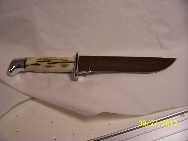

Full tang 124, just like a 119...120..and so on...it's just hidden...grind into the pommel about 3/8" from the end, and you'll hit the end of the tang
It does?:rolleyes:
Very nice partial hidden tang 124! I bet if you put it in a vice say next to a 124LE with full tang, the full tang would hold 2 to 3 times the amount of weight before breaking.
I think I will side with the expert, Bill Keyes. The 119 has a full tang. The tang does extend the length of the handle...and into the pommel.
How do you figure partial? What length designates partial?
Well if the tang does not go all the way to the end of a but cap like the 124LE, then it is partial, if the tang is incased in a handle then it is hidden, so you have a partial hidden tang on that model of 124 you showed. I have a 124LE My tang goes to the end of the but cap and you can see the full length top and bottom of the tang so it is full.
