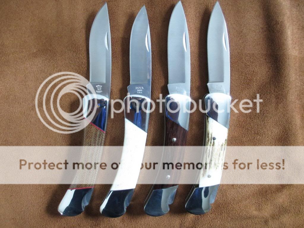

In looking at the few 500's that I have, I also noticed an evolution of the blade profile. On a stag handled script stamped knife, the blade is a symmetrical shaped "spear" point.
On another script stamp 500 with the laminated wood scales, the profile is close to spear shaped but with a bit less drop than on the stag one.
Then on a 500 from the set (in 2011) with linen micarta and BCCI stamp and S30V steel, it is a drop point with the same profile as a "build out" with white bone scales from 2010. Those two blades are also a bit shorter?
Based on what has been stated, the bolsters on the 2010 and 2011 models must be N/S, but they all look like the same metal visually.

Yes, the blade shape/ profile changes a little thru the years. My English script stamped models don't have near the belly as these more recent models Peter names. I like the shape of those from the Heritage Series
and though the frame looks stainless a magnet doesn't respond to it but does to the blade. My blade on that model is 3.125". ? DM

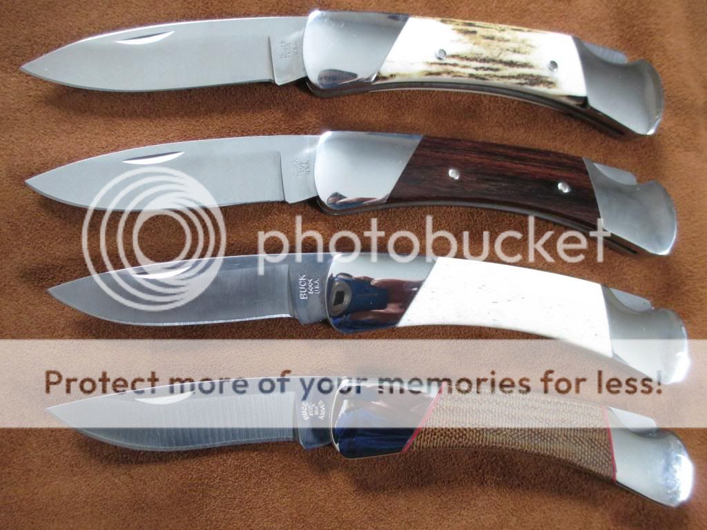

New and old together. It is not a good photo for comparison,
but I hope it helps.
Haebbie
I attempted to show the older to newer differences in the 500's. The stag and wood have the "script" stamp, the white bone is a buildout from 2010, and the micarta is from the "Heritage" set from 2011.
Peter

Haebbie and Peter, The bottom model is each of your photo's is the cat's meow for me. The changes are slight and suttle but enough. DM
