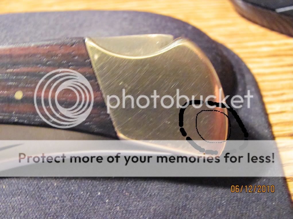

OK here is what I know. this knife does indeed have integral brass spring holder. It has 1 visible butt rivot on the left lower side of the rear bolster away from the rocker. The rt side of the rear bolster has no visible rivot. The pivot rivot is visible from both sides although your really have to look for it on the right side. The rocker is certainly brass and it has 2 tiny inlay rivots that are not headed. I think Flat is right with 3rd ver 8th variation except it specifically calls for 2 but rivots. Maybe 6th version-but I'd swear in court that there is no rt side butt rivot- I cant see one and take a good enough pic to show you but here is what I got.
whataya think?
Where's Goose when we need him?
I think it was him that had one with invisible rivets or at least one invisible rivet.
It is not unusual to have great difficulty seeing the rivets. It COULD be a sixth, seventh or an eighth.
It could even be a third variation.
The front bolster looks shorter and fatter than my ninth, but that could just be a camera angle thing.
If it's significant, it could get us into Fourth Version, Variation One........I think that's been your assessment since the beginning.
Is that a stainless rocker rivet on that auction knife, Or brass? The pics look stainless to me. I am with JB on it being a fourth or fith version.The stainless rocker rivet would fall into that cattegory. ! :)

With various discussions going on, I am not sure what knife is being talked about at any given time. I do know that the pictures of the knife that was the subject of the initial inquiry shows it to have a stainless steel rocker rivet. If Joes data sheet is correct ( and I tend to believe that he is usually correct) and since the first 110 that he lists as having a stainless rocker rivet is a Fifth Version, Variation 2, it seems improbable that the knife is earlier than a fifth version.

The eBay knife is no earlier than 4th Ver, 2nd Var and thus a 1971/72 production knife.

Did you take a shot at identifying Fritz's knife pictured above?
The front bolster looks thicker and shorter than my 3/9. Do you have a third version you can look at to see if the front bolster is preportioned differently from Fritz's?

Sorry Flat......I just read this confusing thread again and I see you did ID Fritz's knife.
Also see you don't have a Third Version.
Maybe somebody else who has one can chime in on the question of the front bolster preportions.
