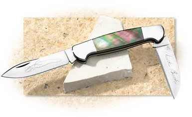

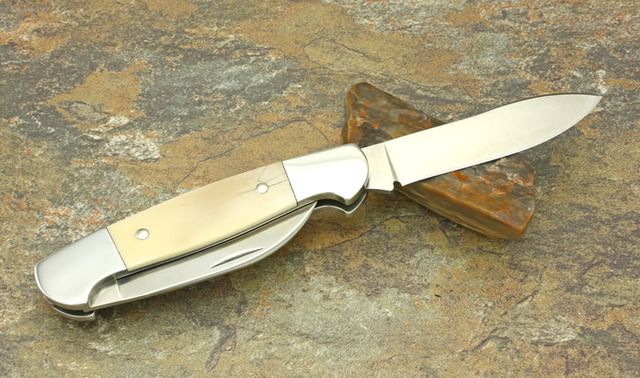

AG catalog photos. Two of the PLBs.
300
Thanx for the pics 300, interesting to note: these AG Russell offerings have two different blade steels!
The spear is 154CM, and the Wharncliffe is S30V...
These have nicely ground blades, as in nice and thin, and the frame is quite narrow...they will disappear in a pocket...
Sit, Lets just complete the circle on this.......The AG Russell Buck canoes are just as quality a knife as 95% of the custom builders, they are made in the Buck factory in Idaho, they cost slighty less than a lot of customs but not by much. But, you call up a store and in a week your really fancy canoe is in your hand......In all honesty some knives are just not my cup of tea, I know folks like Sit that love them. But in this case as a collector I would like to have them all, but I just can't make the 300+ cost. I can buy several 'old' black sawcut stockmen for one of those. My only example is a ivory scale second that had a crack at a scale rivet, it was 1/3 the price. The overseas ones, I hear are made well and are less than a tenth of the AG ones.
300
Not pictured in this photo is personal signature by engraving of Chuck Buck on one blade and AG Russell on the other, which is on all of them.

If you are asking about the blade steels, I would assume that is what AG Russell and Chuck Buck picked for their respective blades... I have one in stag , and one in Ivory ( my Ivory lacks the pin cracks :p )
Yeah, thats what I am asking bud. I guess I didn't realize two different people picked the steels for the different blades. Who picked the cpm154?
I'll go dig it out and check...
AG signed the Spear blade which is 154CM
Chuck signed the Wharncliffe which is S30V
Both blades are flat ground, and the fit and finish on this piece is stellar, if one is a fan of the Canoe pattern, this one is a Beauty to behold.
I just found this,
Chuck Buck and I have known each other for over forty years and have done business together for all of those forty some years. Along with Pete Gerber, Chuck and I are the "old guys" in the knife industry. Several years ago, we thought it would be interesting to create a knife to celebrate this long friendship. Since Buck® is in the business of making knives and I have been known to design a knife or two, we decided that I would design the knife and Buck would produce it in their factory in Idaho.
The design is a Canoe Moose, a double end jack knife, having a large blade at each end, in a Canoe pattern frame. The 2-5/8" Spear Point blade is 154CM at 59-61 Rc and is engraved with my signature. The 2-5/8" Wharncliffe blade is S30V at 59-60 Rc. and is engraved with Chuck’s signature. The highly polished bolsters and the liners are nickel silver and the handle scales are beautifully figured Black Pearl. Each knife is serial numbered (001/250). (Sorry, no choice of serial number.) Measures 3-1/2" closed and weighs 1.7 oz. Made in the U.S.A. Includes a black leather pocket pouch and ships in a black leatherette covered display box.
