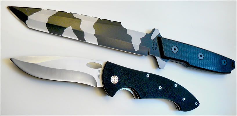

A few years ago, I bought some S&W Homeland Security knives on sale. They were huge slabs of decent 440C stainless steel with grounded tanto blades and a nice titanium finish. Not a great knife, but suitable. And Smokey Mountain had a knife that was a copy of the Homeland Security knife. Don't know what kind of stainless it was (probably 420) and it had a painted finish and a cheap sheath. It's no longer made, as far as I know, but I picked one up just on a lark! My wife used it one summer to dig up weeds in the lawn and then I cleaned it up to almost new, sharpened the blade and threw it in the trunk of my car. I don't think anything could destroy that knife, either that or the Homeland Security! But if I were going to baton any wood with a knife, it would be the cheap HS copy!
So whatever steel they were using could be used to make a tool as described above! Again, a sharpened slab of stainless steel with hand grips on both sides, a thick spine and a sharpened edge on the other side. What could be easier?
I also found a good deal on some Böker Plus survival knives before they were "tantoized." They had some weird serrations on the blade, but the blade itself wasn't something that could be easily snapped.
The Böker Plus was a heavy, sharpened piece of steel made for survivalists!
The Homeland Security knock-off (above) shown with an el cheapo 5-inch Maxum.
Both saw yard duty as weeders!
The S&W Homeland Security, a sharpened slab of 440C stainless with a
tanto point and a titanium finish. About as ergonomic as a goldfish bowel!
Compare the markings with those of the knock-off above. They even have
notches, though I doubt the blade will break!
