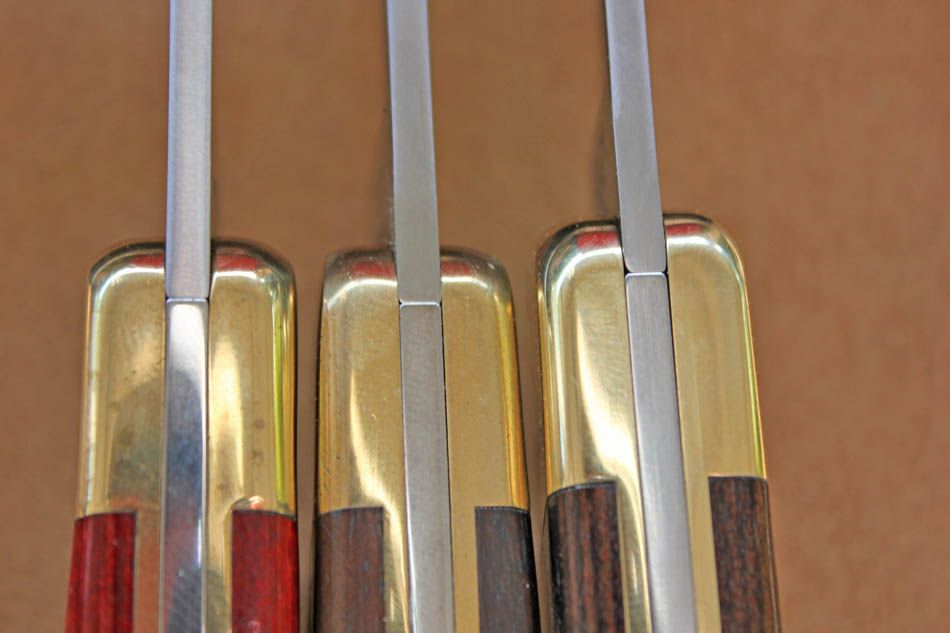

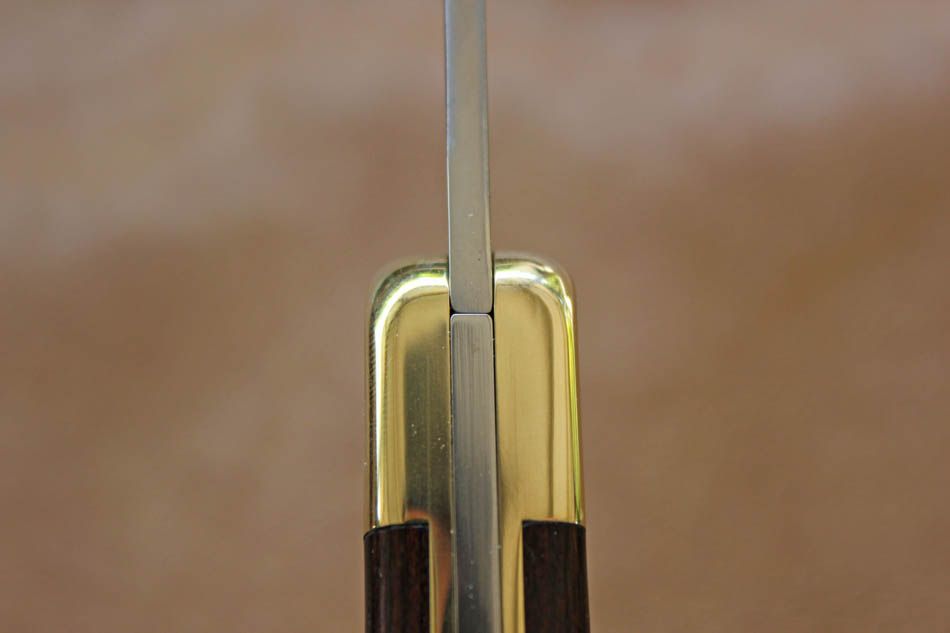

I also noticed that there is a definite "rounding" at the corners of the butt of the blade and the locking bar where they come together which I don't see in some earlier models. A flaw? Does it cause any issues? I have no idea, but it is there, and I wonder if it's caused by blanking dies wearing out or is it the result of other processes done to the blade after it's blanked?
I see this problem? feature? aspect? in pictures people have posted, but not in the 110 I bought last year at WW. Just the very slightest hint of rounding at one corner. Also, no blade wiggle. But I have only used it to cut meat, rope, and sharpen the odd tent peg. Need to give it a real test to see if it stands up to the one I have in 440C from so long ago.
I'd never noticed the rounding until I took a couple of close up photos with a macro lens.
Here's a quick (and perhaps a bit fuzzy) photo of three for comparison. The knife on the left is a fairly recent one from the Custom Shop when they were still stamping the S30V on the blades. The center one is from 1989 and the new one is on the right. They all have a bit of rounding of the corners but it far more evident on the new one.
Dave, mega-props for posting this.
To his massive credit, Jeff noted earlier in the thread that they are seeing a pattern too.
I know this has been a difficult discussion for some over the past several months or more and I can only imagine its harder for Jeff and Joe. Here's hoping they can get to the bottom of it. I'm confident they can.

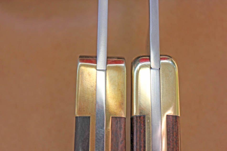

I'm going to look for one of my 4 dots next. I believe that's when they changed to fine blanking (with the change to 425M) and that might provide a clue whether or not the rounding is caused by the blanking process. I checked out but didn't picture a 3 dot but it's fit there is the same as the 2 dot, both are 440C and used the old blade shaping process.
New one on the right compaired to a new in box 2 dot. Quite a bit of difference.
the older one looks tighter than a Scot's coin pocket! Sadly mine wasn't even close to any of the ones you've posted..

I am wondering if Buck started laser cutting their blades rather than punching them out if that would help the situation
I remember a 110 sometime back with a sprung pivot, blade play and a broken tip but that one had been used as a throwing knife into a tree at the end of the long story.
So much for that theory. I dug out three 4 dots and they have the blade to lock bar fit just the same as the 2 and 3 dots.
It will be interesting to find out why the blade to lock fit seems so different on the newer 110s.
