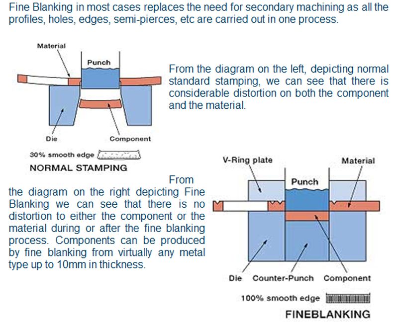

Could the rounding come from one of the manufacturing processes after the blades have been cut or blanked? All of my Buck folders have shown that kind of fit between the blade and the locking bar. Even my slipjoints have rounded edges in those areas. I've also seen the same thing on Case slippies. I just wonder if it could be happening when they are polishing up the edges of the tang.
As far as vertical blade play goes, it doesn't take much difference in specs to induce vertical blade play in a lockback. I had a Spyderco Delica 4 with vertical play, where the lockbar stuck up the tiniest bit. I was able to take the knife apart, and sanded the face of the lockbar ever so lightly, and had a flush lockbar and tight lockup. We're talking a hair's width of steel that was removed, and it completely changed how the knife locked. Even if all the lockbars are to spec after they come out of the machine, if they are hand finished it might explain why we see so much variation. That's just my theory at least.
The rounding seems to be on most of my 110 folders, everything pre date code seems to be more squared.
Does a laser-cut blade blank have rounded corners?
Good question. I don't have any idea which blades are cut using that method. I doubt it though as I now doubt that it's caused by the blanking process. I suspect that it's a result of processes (as SD just mentioned) performed on the blade after blanking.
The fine blanking method at least, appears to be designed to prevent that sort of thing.

Plumber, that diagramis great stuff! cheers for that.
