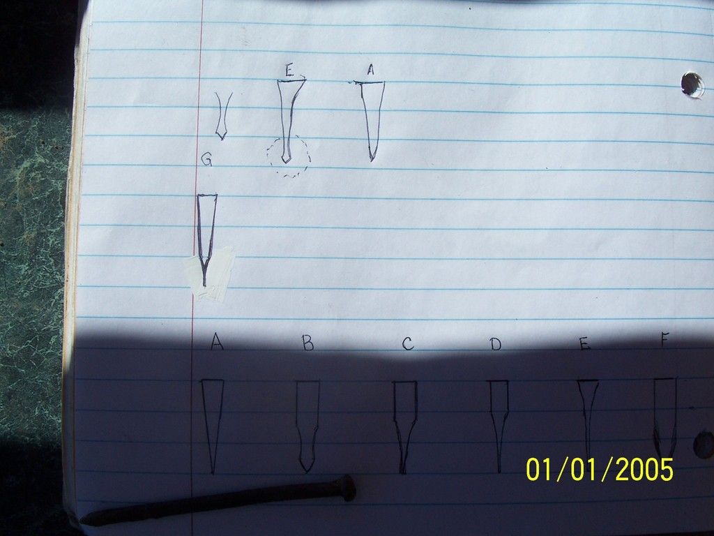

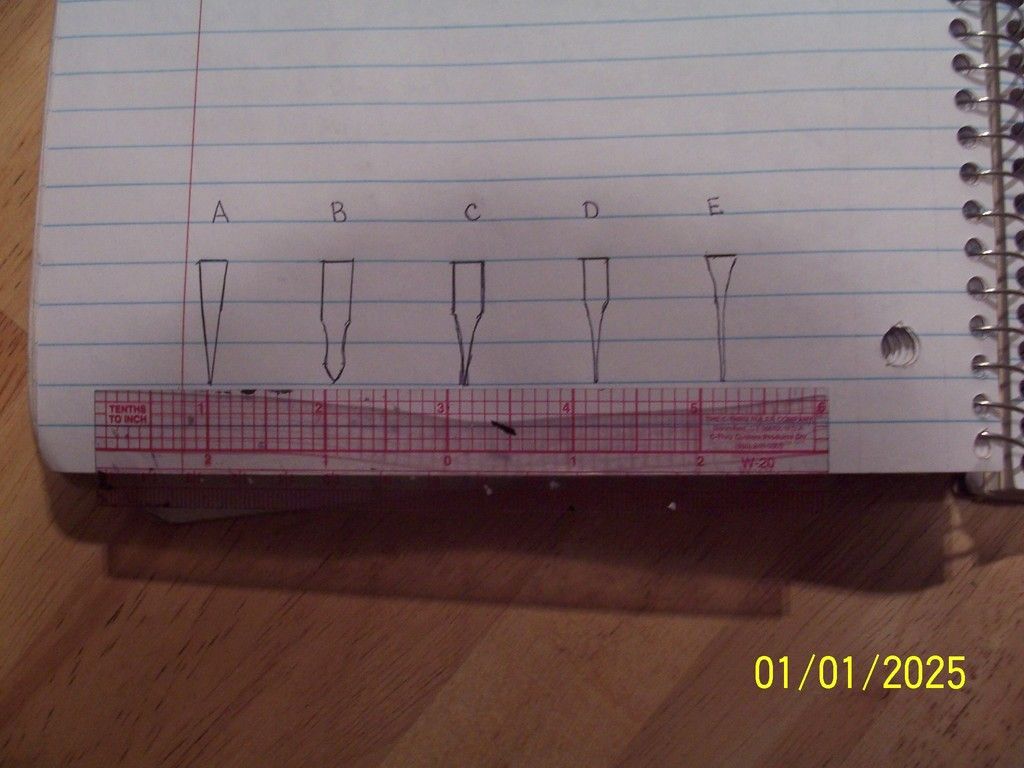

I've noticed some interest in Buck's grinds.
And thought I'd entertain some discussion in this area.
So, I drew out some of their grind cross-sections from early knives (1945) to Present.
Grind A was used in their early knives (model 117 ect.) and in their 60's- 90's slip locks. A full flat grind.
Grind B was used in their 100 series models and lock-back folders from 1962-1980. A semi-hollow grind. (a convex edge)
Grind C was started in 1981 with their 3 dot lock-back folders. A fuller hollow grind.
Grind D represents their Edge 2000 started in about 1993. A improved hollow grind.
Grind E represents a full hollow grind. Used by some custom makers. DM

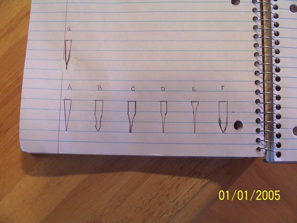

pinn, I didn't post a cross section of the grind from the time frame you mention of fixed blades. The grind I drew was of slip locks. I knew for certain that one was being used in that time frame. As I haven't held enough of those models to know for certain. I have handled a 104 and it seemed to be. Certainly not as convex as the knives from the 70's. There are other grinds I've seen on some other models (kitchen knives) they do that I didn't draw. So, not meant as a complete dissertation. DM
Joe, I'd say no. As there are folding models I have that the blades are not edge 2000 type. The Durado and Alpha Hunter come to mind. These would be thicker than 'C'. The thinnest ones I've noticed were on Bucklites from 1993-2000 and some Workman series. Type 'D'. DM
On grind F these being from old knives it's hard to say how much of the grind was changed from sharpening. But I would say from the model I examined which was in very good shape. It had a wee more taper at mid-cross section and flowed on down to a convex primary bevel. Then on G this grind is not seen much, a flat grind flowing down to a hollow grind except on very wide knives. DM

Joe, your questions are the type that folks on this forum discuss endlessly and have their reasons why they are camped in that flavor. I'm going to take the middle road, as I'm still testing a 'full flat grind' blade. However, as of today this FFG blade cuts well and right on par with Bucks edge 2000 thin hollow grind. I think either one performs fine. The full hollow grind is the one I prefer. As it's thinned out ALL the way to the spine and this allows for deeps cuts using less effort. But this grind is mostly Only seen on expensive custom knives. The other grinds have there place. It depends on what you're cutting or malleting. If I wanted a knife I thought I may use to mallet I'd make sure it had grind F or B. This may seem like a lot of grinds (and there are at least 2 more I can think of) but go over to the axe and hatchet forum guys and ask them about grinds on those tools. You'll have 12-15 grinds just for cutting wood and no one is using many brain cells giving you those. So, what you're cutting and what you prefer does matter with grinds. Then the steel and heat treat to compliment the package is of great importance as well. DM
Grinds A and E are my favorites. E slices insanely well and has a strong spine to support the blade. A slices as good, but where it shines is in softer material that is much deeper than the knife, or in cardboard. Think of a kitchen knife. B is interesting because in a hunting knife where you encounter bone, fine edges like E are easily chipped. B puts more steel behind the edge, thus giving it strength. That's my story and I'm sticking to it.
Doc, yes I think that was the thinking when these grinds were developed. Then that thinking dominated and was slow to change. I noted some dates of change: when Buck went to a fuller hollow grind in 1981 (grind C)that was the time Bob Loveless was making quite a name in custom knives and many took notice. Still, a slow change taking 20 years.Then Buck's edge 2000 started being seen 13 years later. Grind D. This one could actually stand with the full flat grind. Still, it took 50 years for that change to surface. And the full flat grind is a tough standard to beat. I like your story-- stick to it. That thinking has a standing. I'll offer a different take. A knife is steel. Very hard. If the edge is done correct there should be no chipping noticed when a bone is nicked with any grind. But as the edge bevel is increased cutting efficiency (think obtuse) is decreased. As edge angle is decreased (think acute) cutting efficiency is increased but strength decreased. Hence a chip occurs. So, we have to find the 'sweet spot' for our cutting tasks. DM
