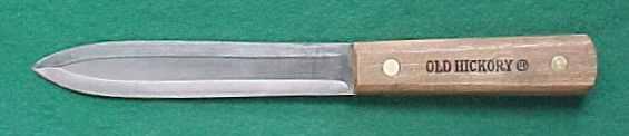

How about picking up an Old Hickory Sticker and getting a simple sheath made for it? As long as you keep it oiled up, it shouldn't be a problem.
The old hickory is a sliced hand waiting to happen. Its a straight uncontoured handle. With a straight square handle terminating into a sharp blade. What happens when you go to stab a boar and it moves its leg back causing you to stab a bone. Your hand will slide up the blade and you'll have a hell of a time patching yourself up.
With some handle modificiations it could work.
