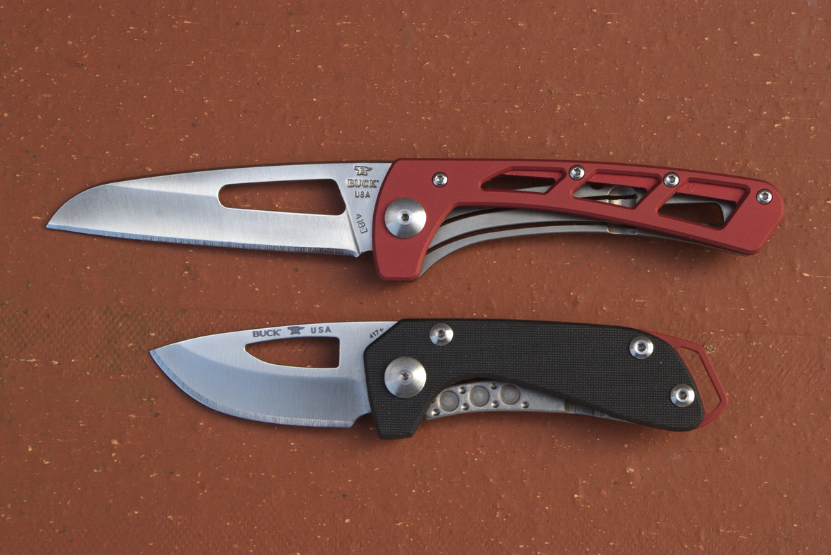

Size comparison with the 418 Vertex

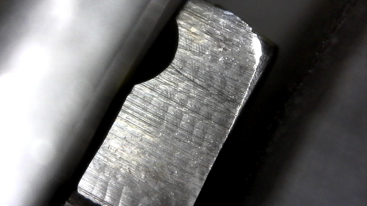

Second, like so many framelocks, the detent ball was hitting pretty abruptly against the lock face when closing. I've added many detent ball ramps, especially on Vantages to smooth out the closing. Yes, I probably voided the warranty, but went ahead and disassembled the knife and filed in a ramp. Closure is much smoother/seamless now. I'm not sure why more knife makers don't put these in from the start. Anyway, I discovered the Budgie is running on what appears to be nylon (Nylatron) washers. I've seen similar washers on the Vantage Force models. I'm hoping they get silky smooth with time and use.
Detent ball ramp - view of lock face
Detent ball ramp - view of tang

Second, like so many framelocks, the detent ball was hitting pretty abruptly against the lock face when closing. I've added many detent ball ramps, especially on Vantages to smooth out the closing. Yes, I probably voided the warranty, but went ahead and disassembled the knife and filed in a ramp. Closure is much smoother/seamless now. I'm not sure why more knife makers don't put these in from the start. Anyway, I discovered that the Budgie is running on what appears to be nylon (Nylatron) washers. I've seen similar washers on the Vantage Force models. I'm hoping that they get silky smooth with time and use.
Detent pressure makes or breaks a knives ability to flip. On a non flippers I guess it isn't as important but functional.
