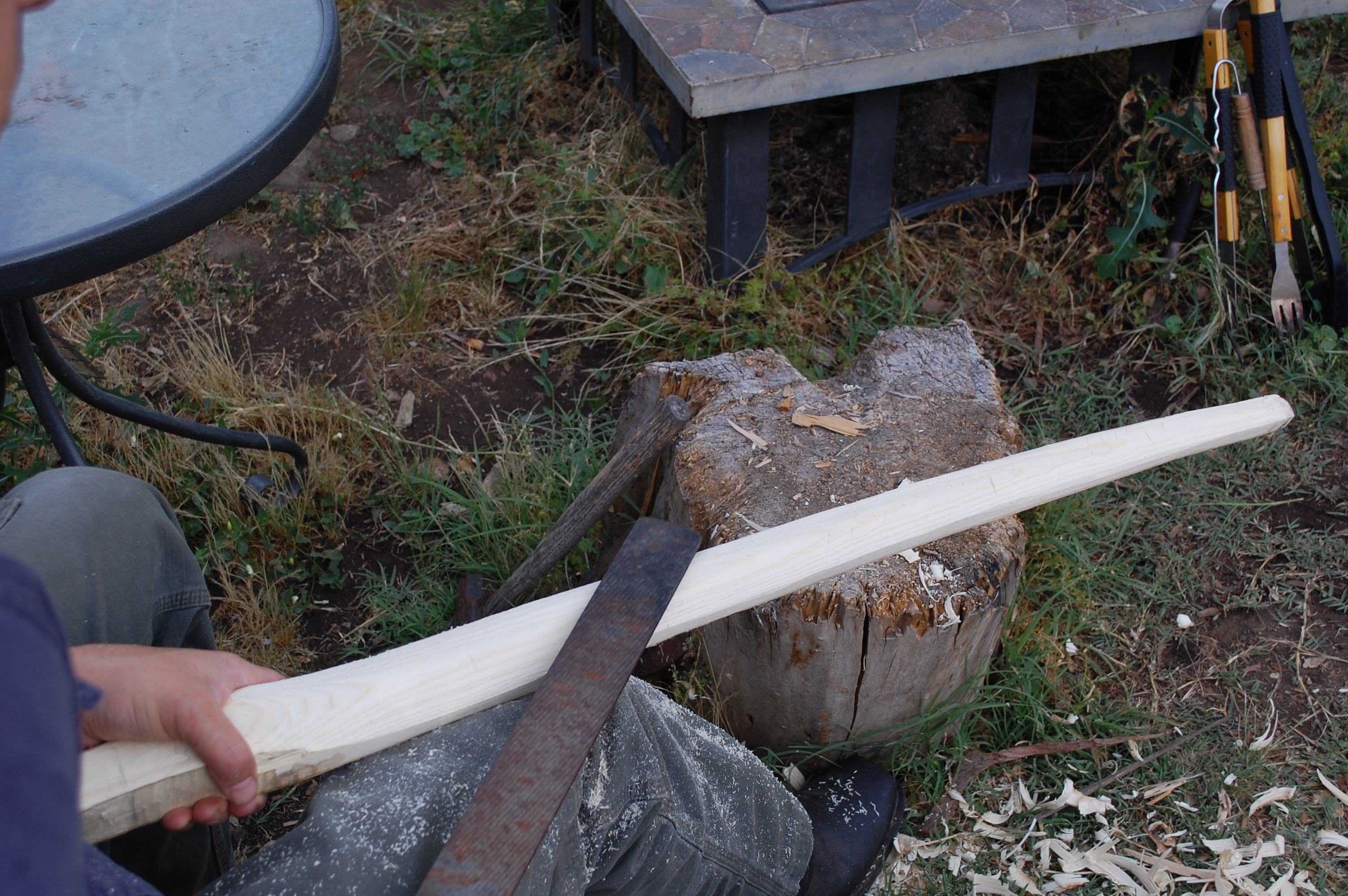

Here's the stave, roughed out and beginning to resemble a bow. This is a beautiful stave, no knots, straight grain, no bugs, and well worth the price I paid. Now that the basic shape is there, it's time to be really careful! One over zealous strike of the knife and the whole things done, as sure as if the bugs got it.

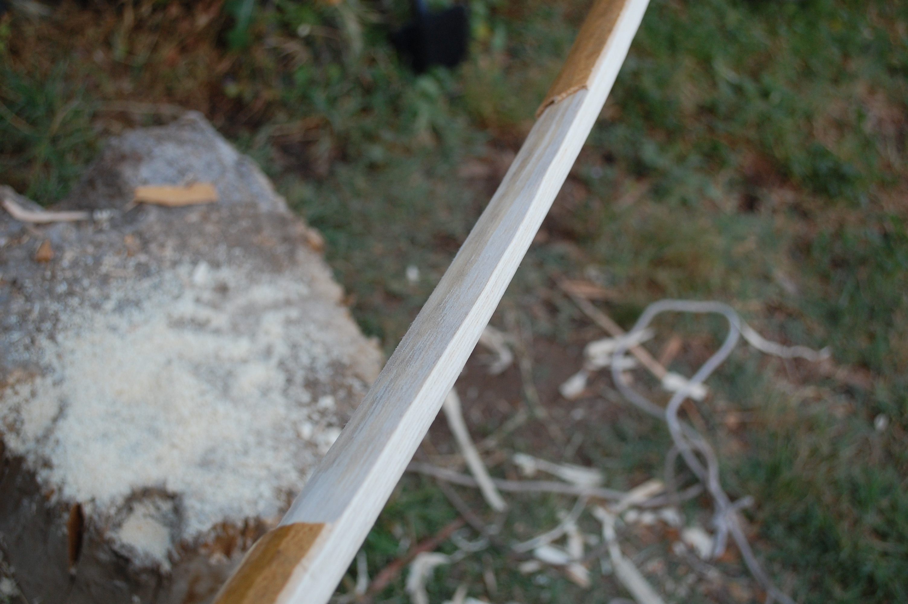

I've got the stave in my red neck bowyers bench, and am planing the chop marks off, leaving the limb smooth and even. Notice the paper thin, almost transparent shavings. That's what you want at this stage.

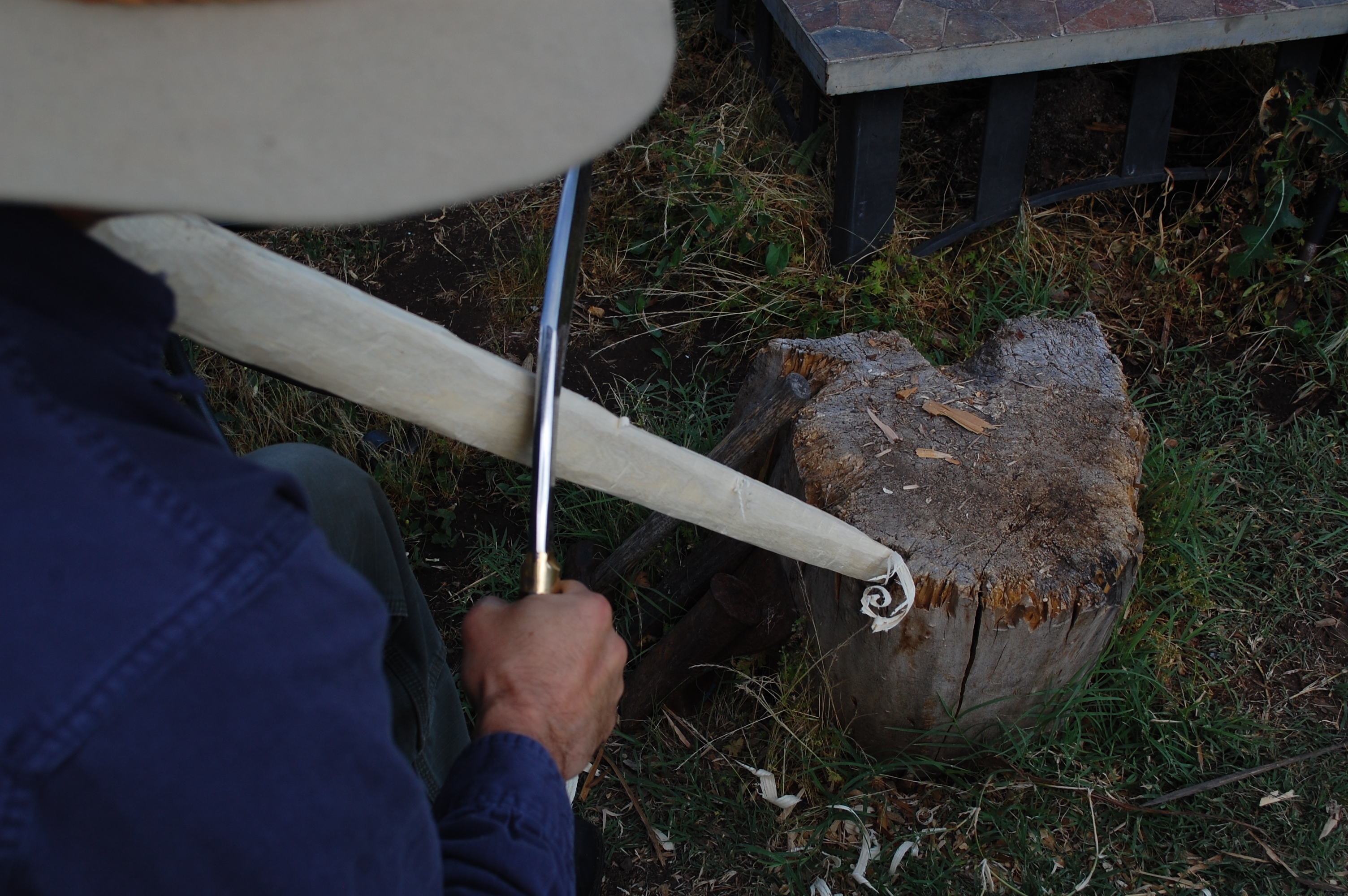

Well everyone, I haven't given up on the project, so here's an update. There is still too much wood on the limbs, so I'm removing a bit with my khukuri.
If this looks dangerous, that's because it is! This is a very controlled drawknife action, smoothing out some rough spots.

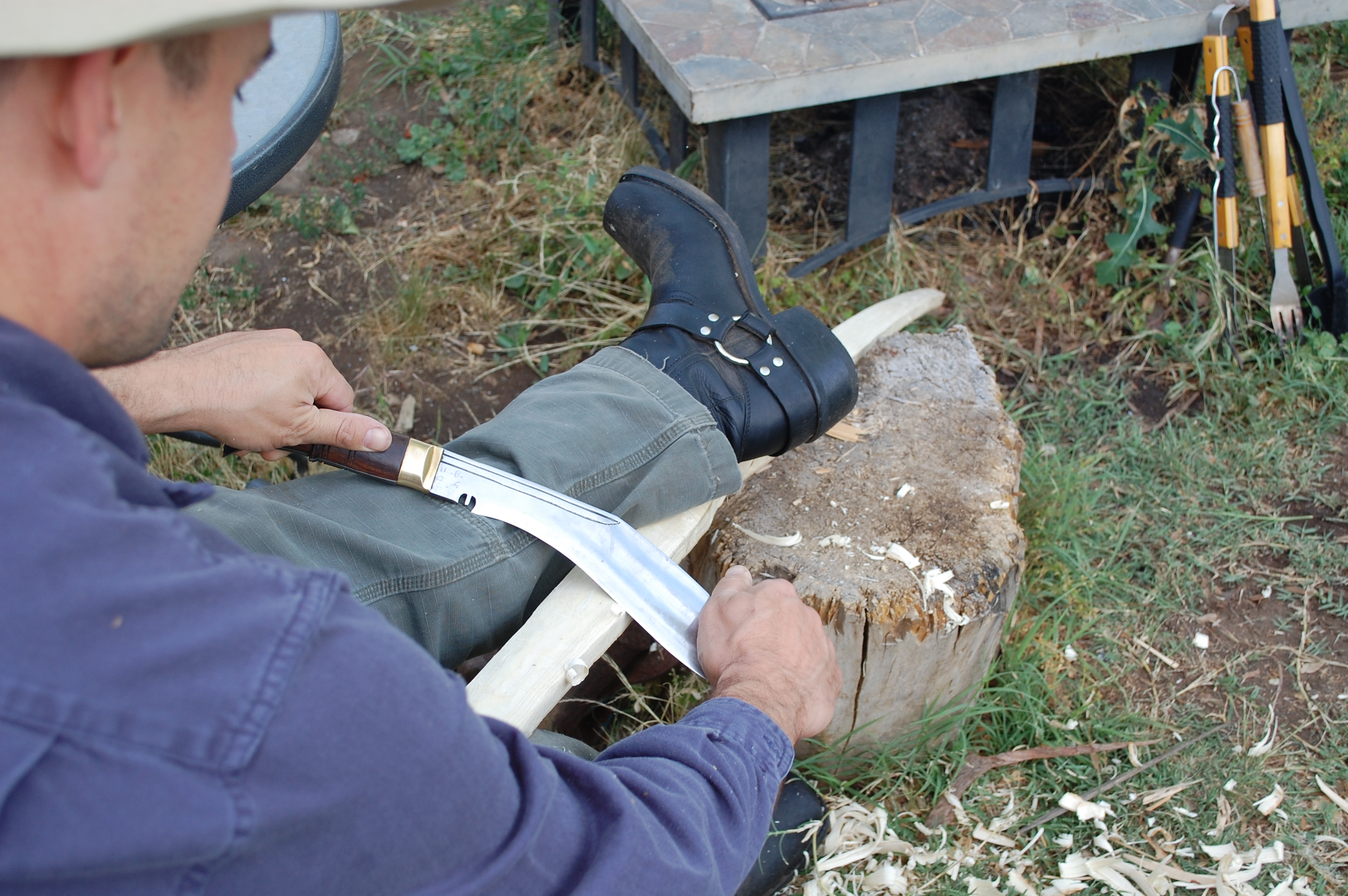

At this point, I've decided to start using a farrier's rasp to smooth out some chop marks, and in general remove wood in a very controlled way. I'm at the point where it would be too easy to take too much off in any one area and thus ruin the bow. I'll be using the rasp and khukuri interchangeably from here on.

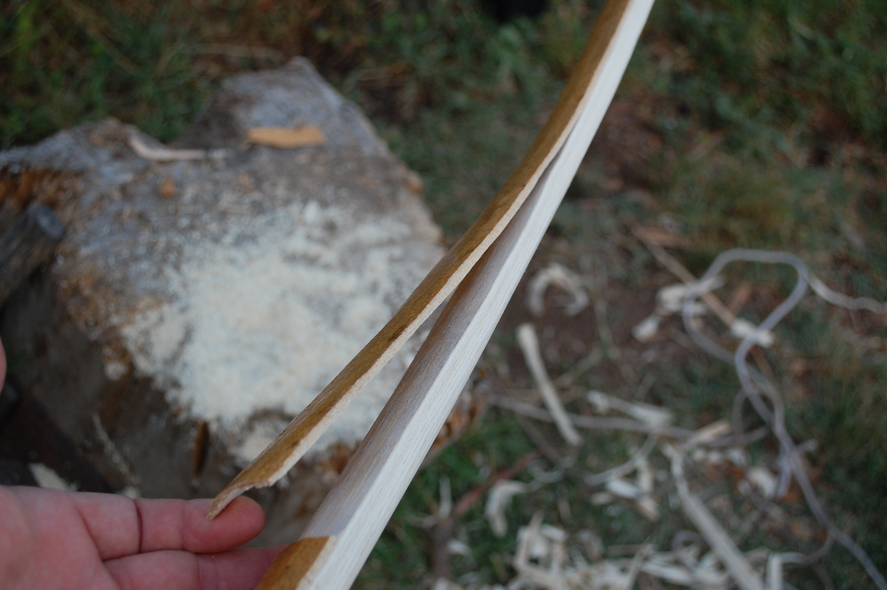

I've finally removed enough wood to begin floor tillering. Tillering is the process of teaching the wood how to bend without breaking. As I bend the limb, the inflexible bark begins to pop off the back of the bow. This is where you have to brace yourself for the sound, because it sounds for all the world as if you just broke your stave when the bark lets loose.

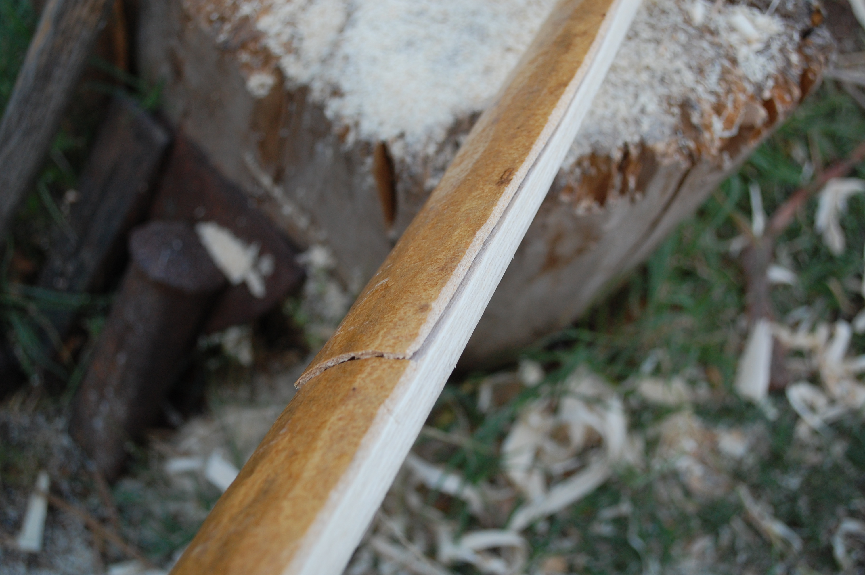

Just lift the bark off and remove.
This is the beautiful thing about working white wood. What your seeing here is the back of the bow. That is one, perfect ring that I don't have to mess with. Just get the bark off, and there you go!
From here on, it will be a careful process of tillering, limb symmetry, and keeping the centerline intact from both limb tips through the handle. Target weight is between 45 and 50 lbs.
