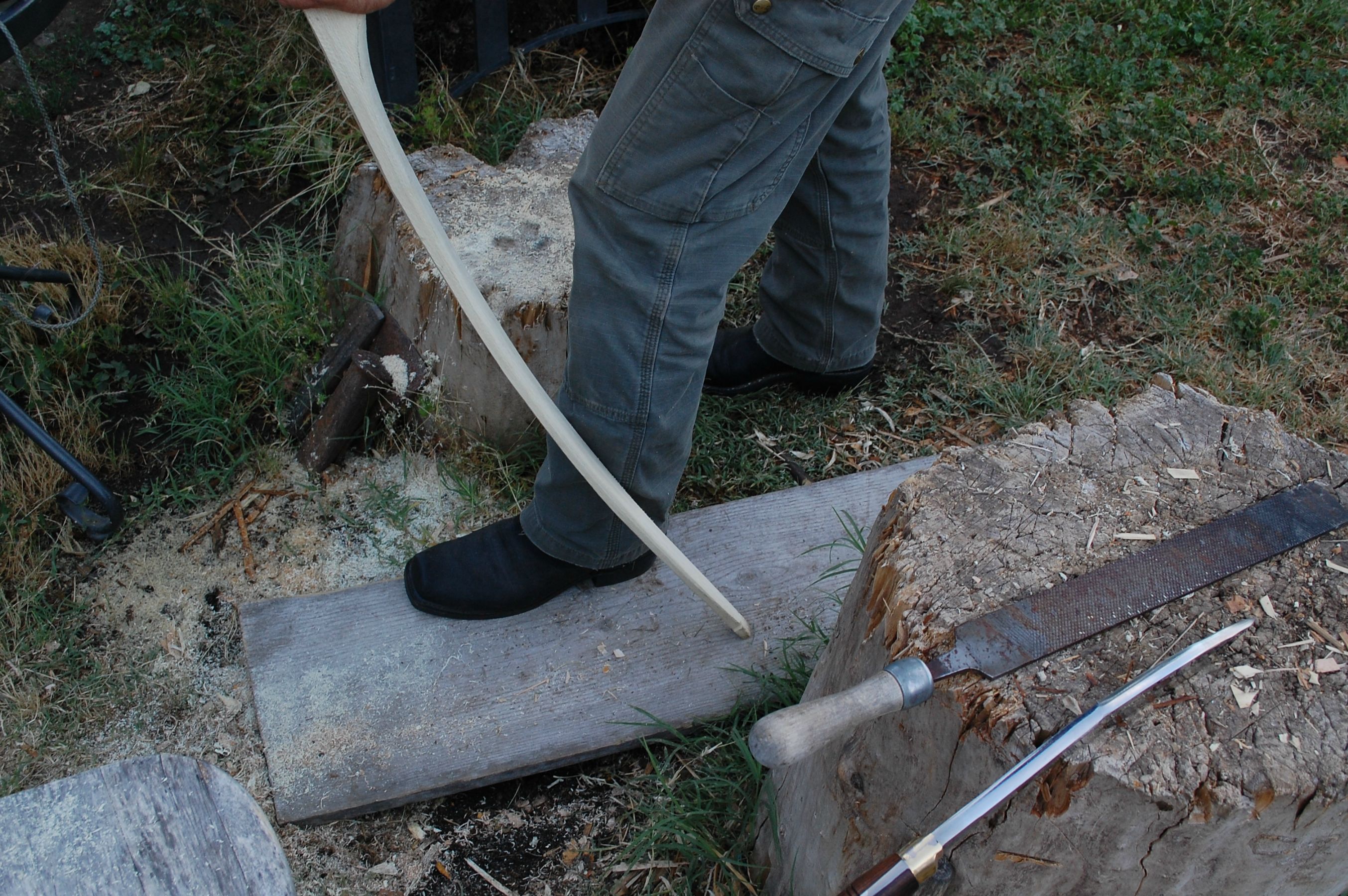

At this point, I'm floor tillering, which means I'm putting the tip of the limb against the floor and putting pressure on the handle section until it bends a bit. I keep doing that, marking out any flat spots, until I have a graceful bend from handle to tip. For zeroing in on the final draw weight, once I put a long string on it I will only draw the bow to the draw weight desired. Then I will remove some more wood from the limb, exercise it, and then draw it to draw weight again. As wood is removed, the weight should be the same as the draw length increases until you get to the desired draw length. I'll be working on it some more tonight, so I may have some more pics up tonight.
Ok, I had a chance to get back to it tonight. This is floor tillering; the first step in getting the wood to bend. The bark is completely off at this point. I flex the stave 20 or 30 times everytime I take wood off the limb.

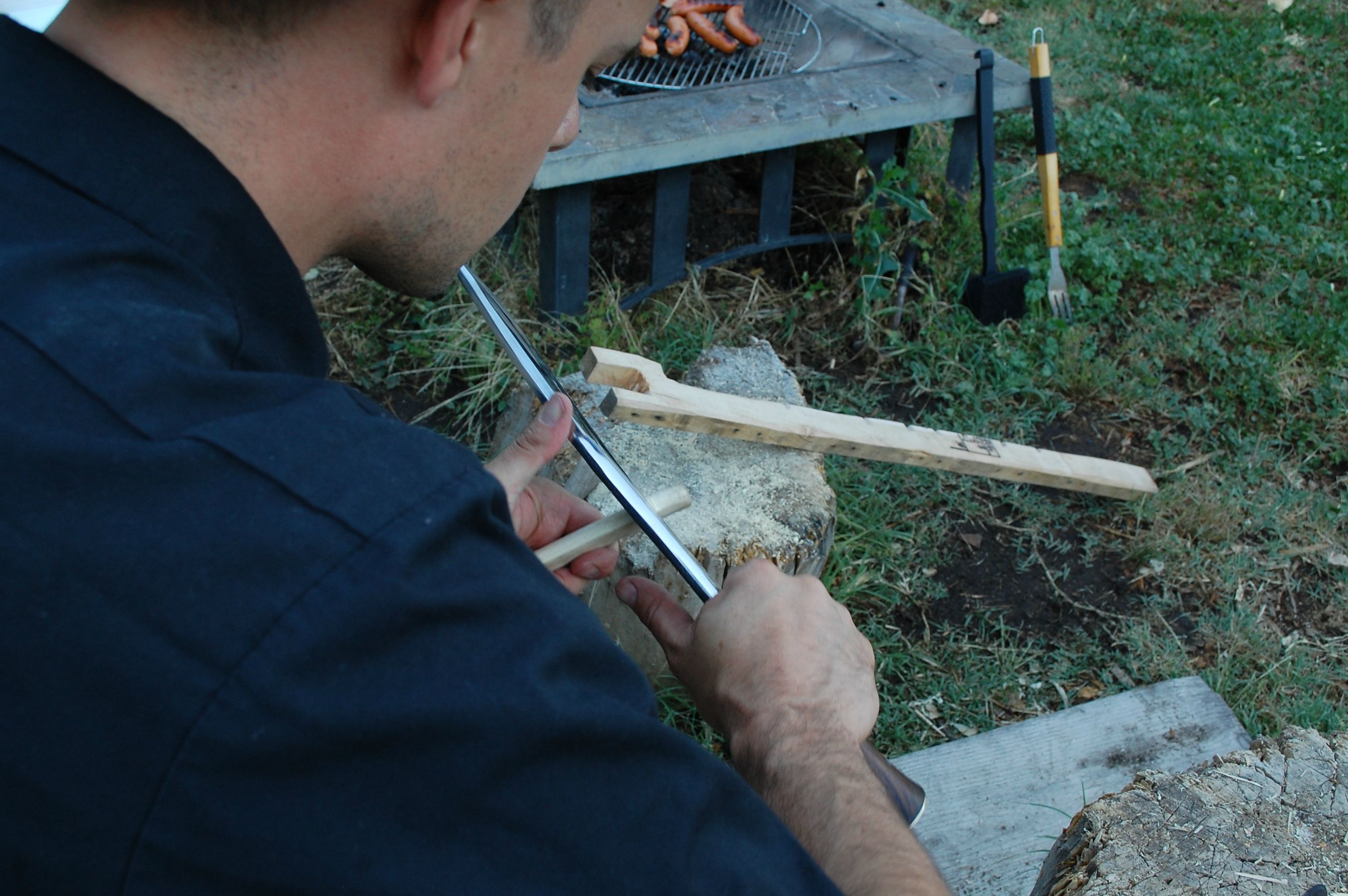

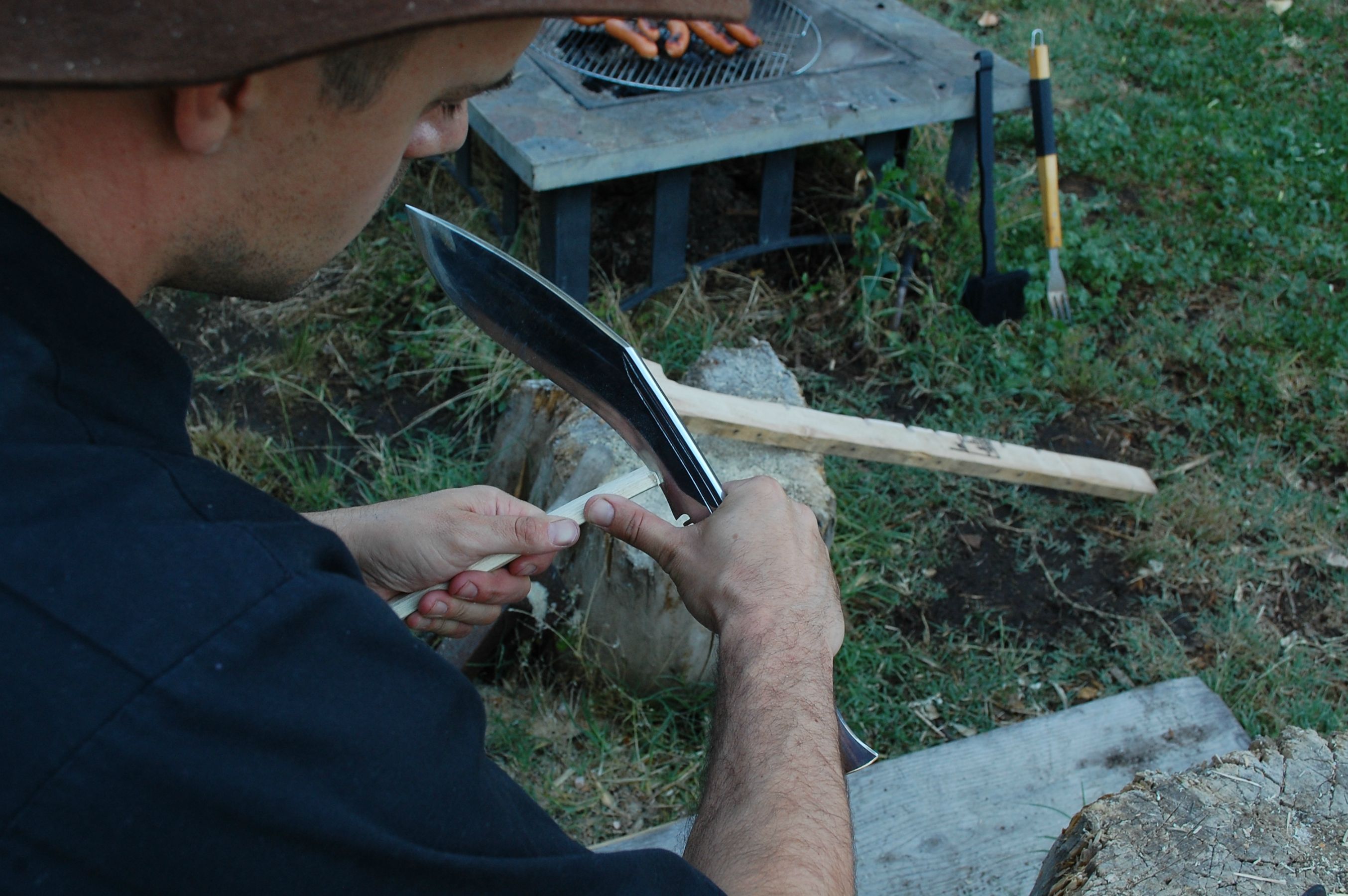

Now, I'm ready to make some notches so I can get to work with a tillering string. Anyone who tells you that you can't do fine work with a Khukuri flat doesn't know what they're talking about!

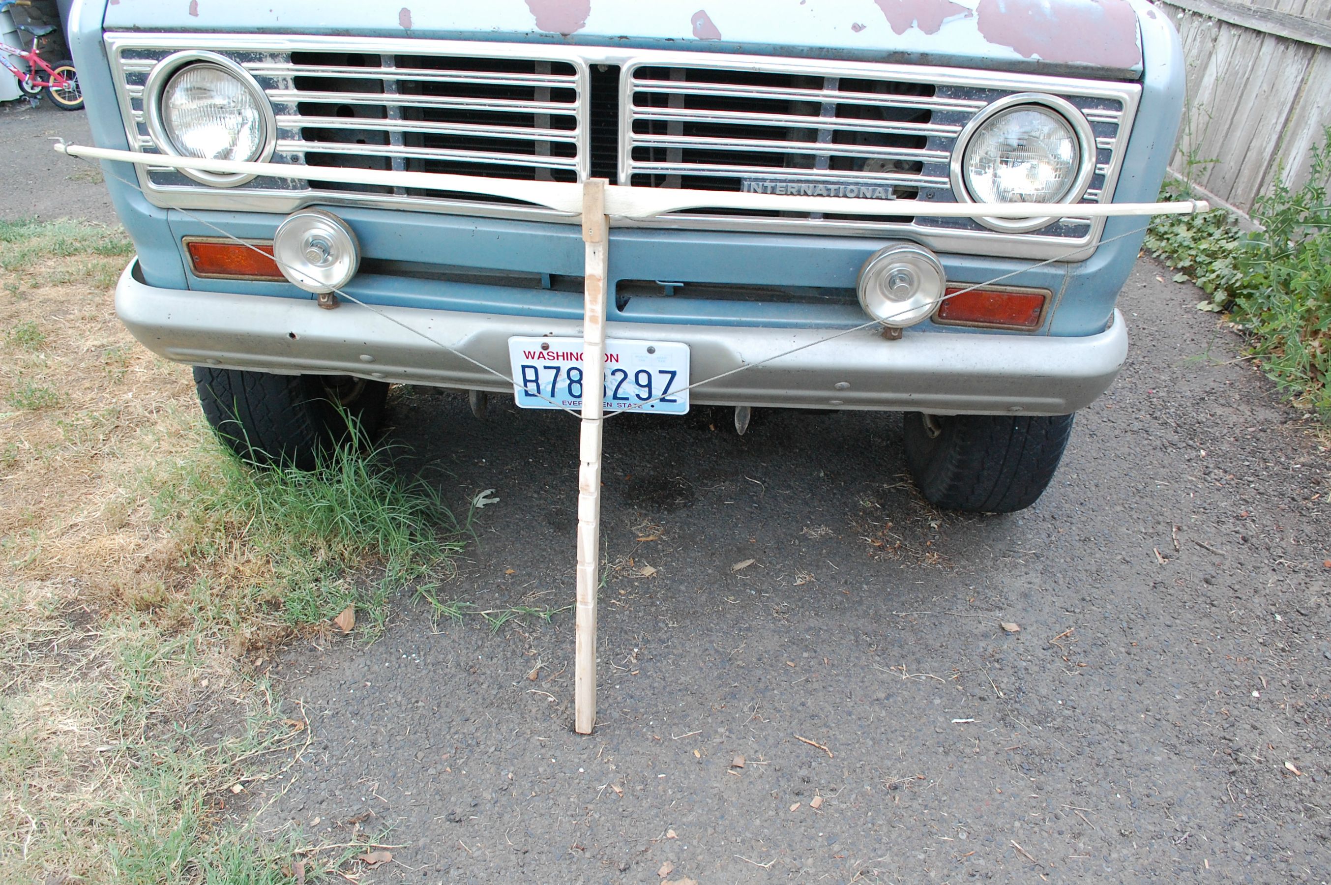

This is a Bowyers' Knot. Very easy to adjust as we will be shortening the string as we go.

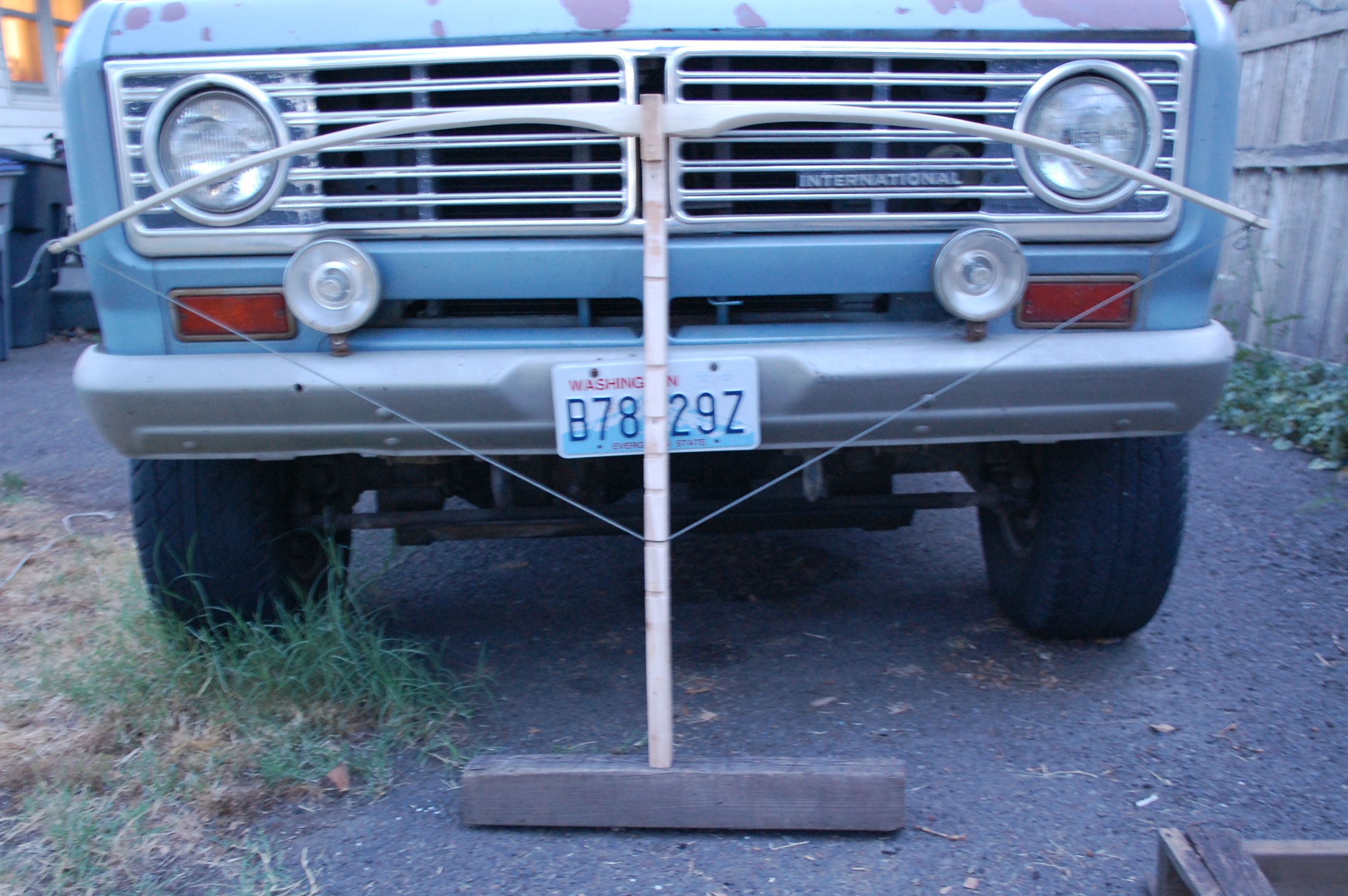

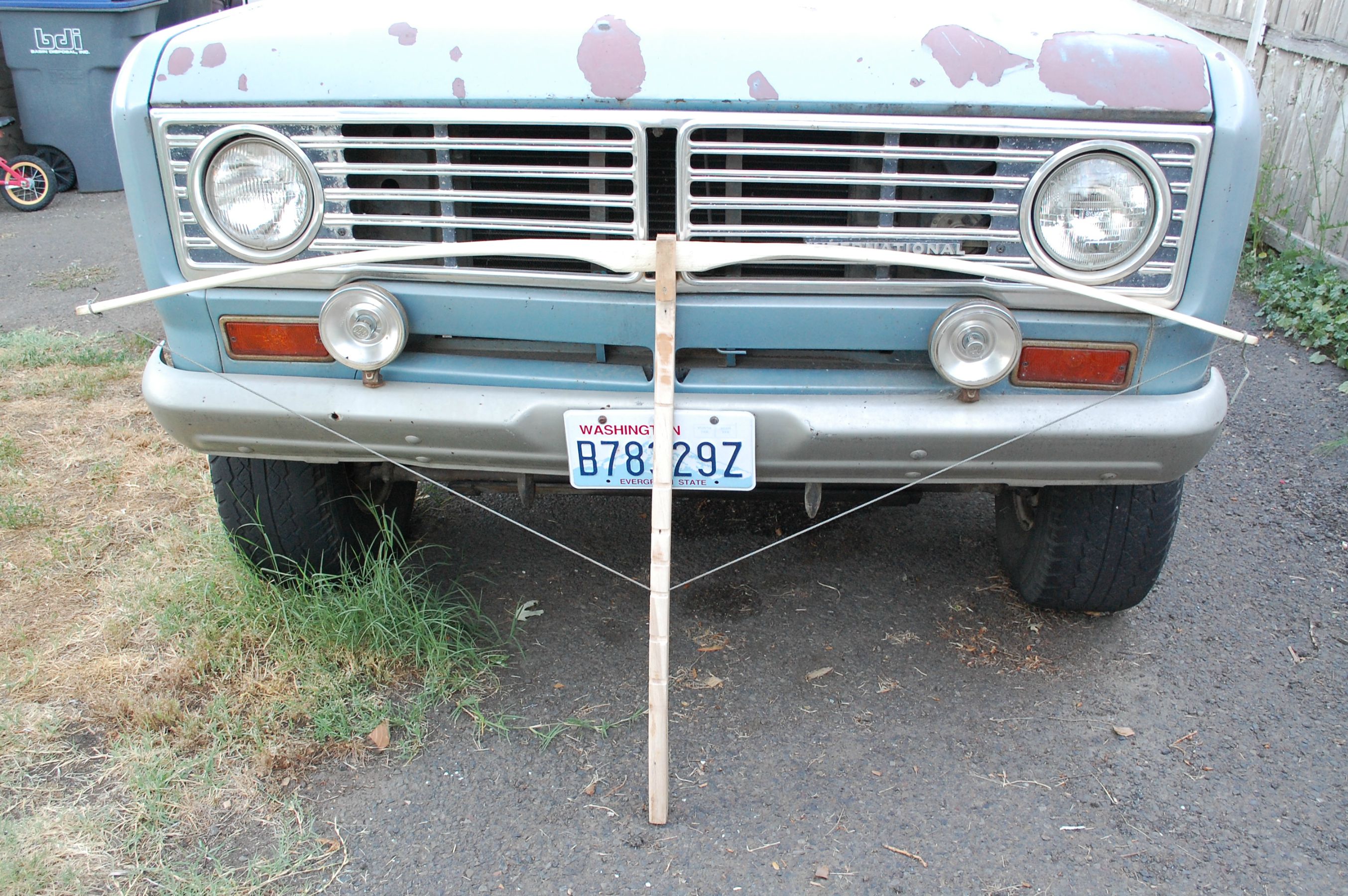

Now it's on the tillering stick (just made that tonight!) and this is where it's time to be careful. The grill of my truck makes a pretty good gauge for checking the tiller! You will see that as I draw the string down the stick, I adjust the string making it shorter every time. Once I get to roughly brace height, I'll make a bow string for it, and continue to fine tune the tiller.

As a gauge it does very well, and easily leveled with inflation/deflation....much easier than adjusting the wood....

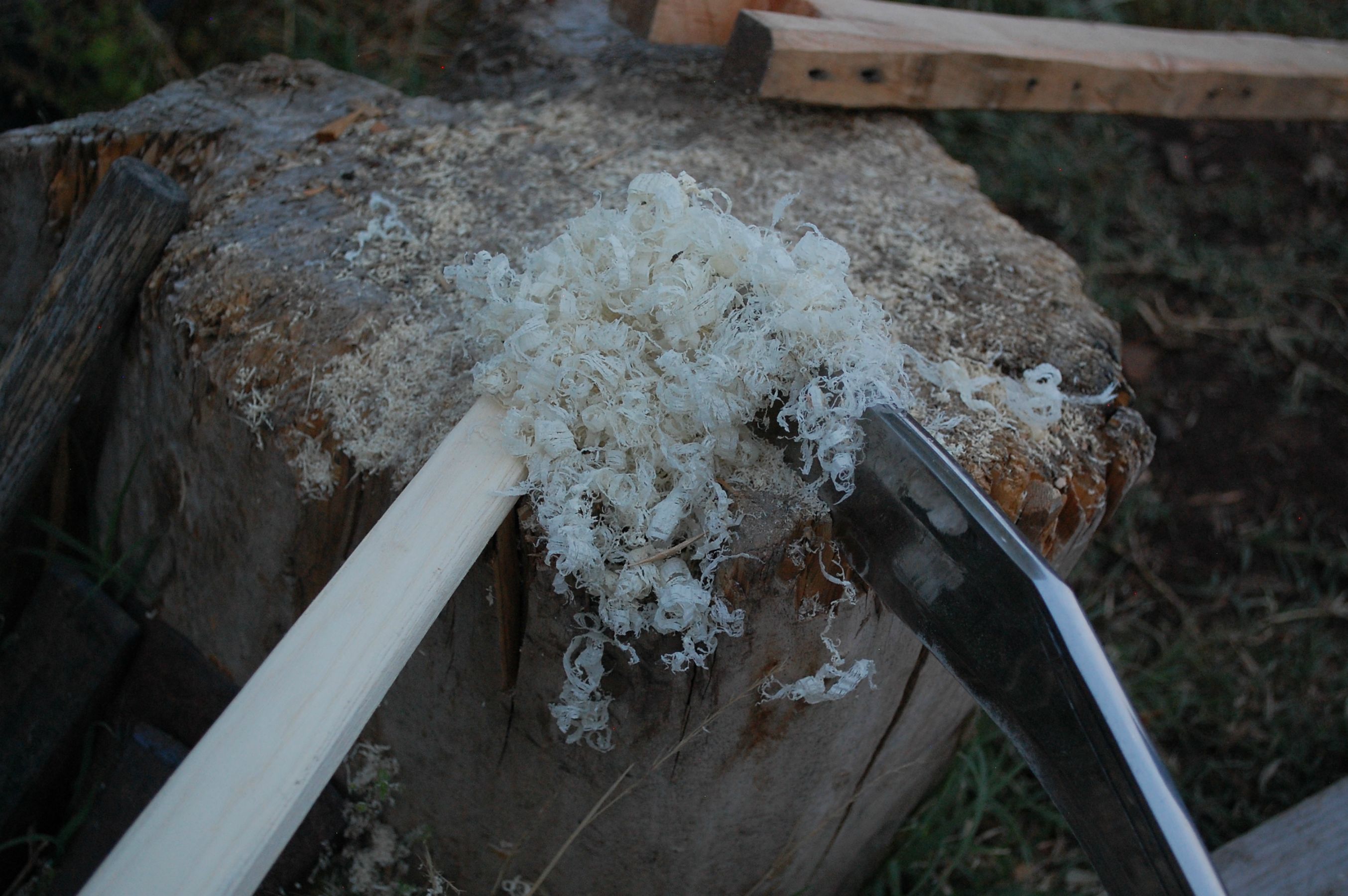

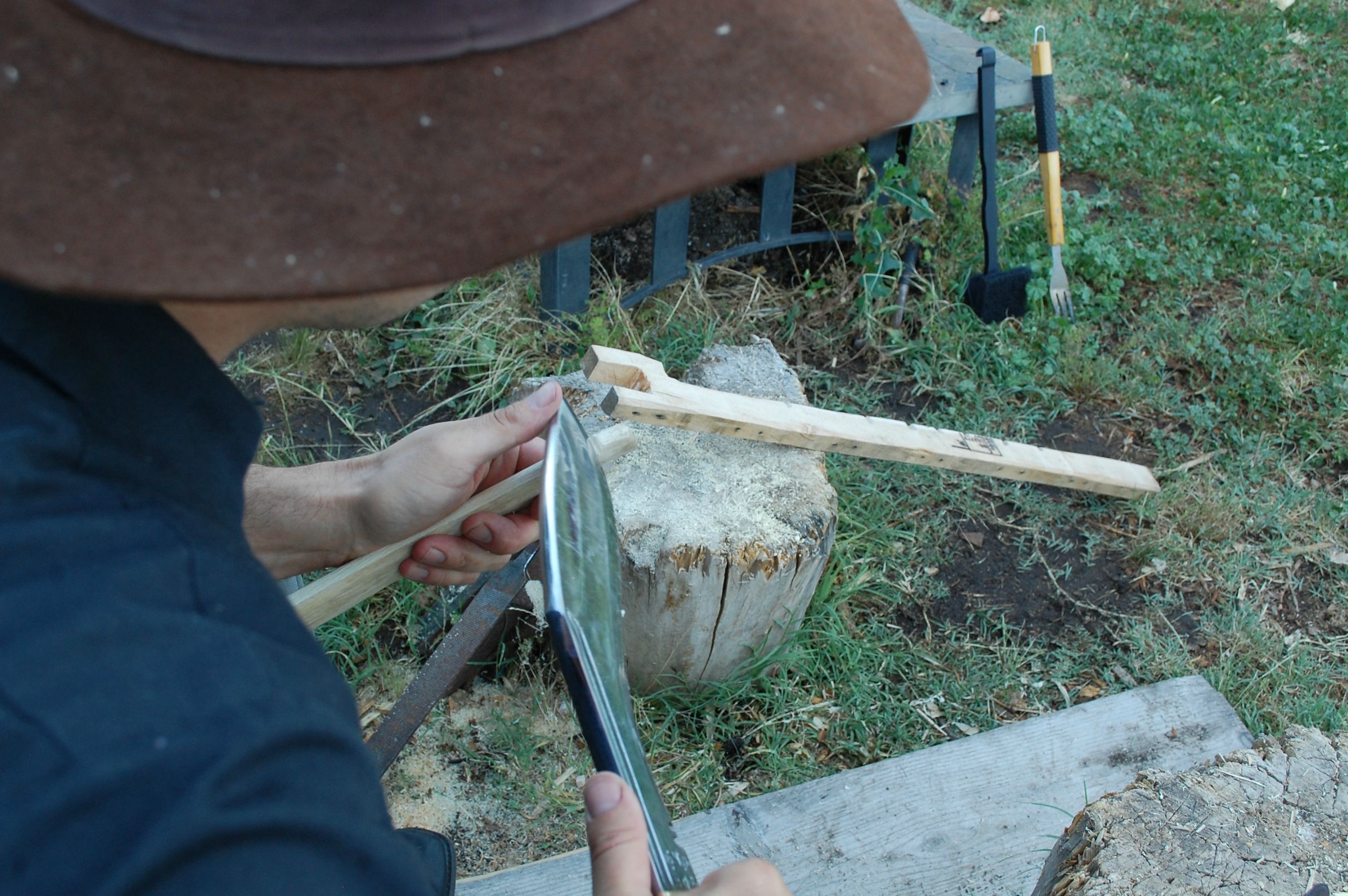

I'm down to fine tillering now. I jumped into it a little too early before, but at this point, all I want to do is take off paper thin shavings. I'm doing about 15 passes with the Khukuri, and then flexing the limb 15 times.
I'm now just about ready to make the bow string. I'll shorten the tillering string a bit first, and try to eliminate some of the flat spots in the limbs. So far, so good.

I've got a pretty good feeling about this one. The stave has looked really good all the way and although this is the first time I've worked hackberry it seems to be a very flexible bow wood. I've exercised the limbs hundreds of times at this point, and the stave is holding almost all of it's original reflex. Something weird and unseen can always go wrong but as long as I'm careful this should turn out fine. Right now I have to make sure I don't develop any hinges, and that I don't over stress the limbs at any point and avoid compression fractures on the belly. That, and I also have to make sure that the string centers through the handle. That's why I've left the handle section and tips a bit thick. As I dial in the tiller, they will become much smaller.
Really love the thin curls. Patience seems to be a major key to success in this skill as with so many others. You talk about flat spots on the limbs. is that because if they are flat instead of matching the curves around them they pick up more of the stress when the bow is flexed? so in a sense even though they are thicker they would be the weak point in the arch?
That is going to be a gorgeous bow. Hopefully the new owner will keep the pictures coming after he acquires it too. Looks like it is getting close to the finish work now...or am I too impatient and it has a while to go yet? LoL.
The flat spots I mentioned are areas where the limb is too stiff, and more wood needs to be removed from that area. If you remove too much then you end up with a hinge, which means that part of the limb is too weak. Hinges are bad, particularly if you end up with one near the handle. It's going well, but not close to finished. I'd say at this point it's halfway towards having it ready to shoot. After that there will be some time spent finishing it up. That said, I did set the stave aside for a couple months. In terms of time put in, I'd say I've got about 6 to 8 hours into it so far.
