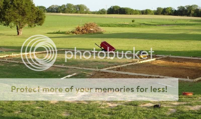

I am taking on a new project. This will be a 24'x30' metal building with a 24'x15' carport on the front. I have never built one before. I will have the help of my nephew and neighbor, both of which are fellow firemen. Here is the progress thus far. Here is the forms for the slab. I built the pad for it a couple of years ago when we built the house.

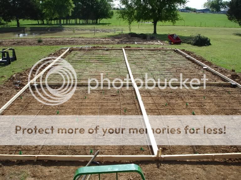

Here is another pic after I put down the rebar. Ready for pouring.

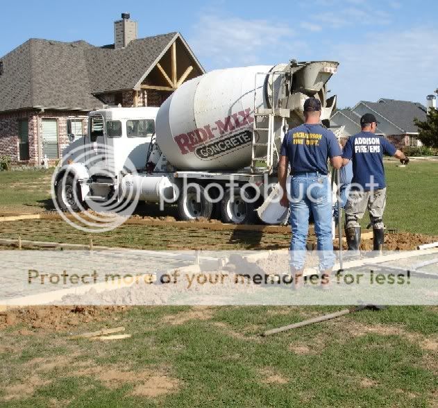

Well, here we are ready to go to work. The truck has pulled up and we are about to gird up our loins and get after it!

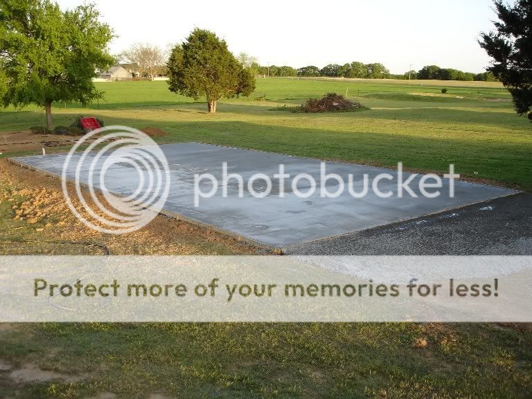

Well, here it is, my first concrete slab! Not bad for a few knuckleheads that don't know any better. I saved about $2000 bucks by doing this myself.
I will order my building next week and we will get started on welding it up. I have roughed in one water line, and a drain line. I will do the electrical later. So far, so good:)

And when I say you need to pack , I mean "pack" I mean to rent one of them big push packers and go over the sand in layers...pack-pack-pack...
Then, rebar the stuffing out of it!

Around here, they don't pour on the bare earth...they lay at least 4 inches of crushed stone first, then the rebar...
Yes, I dont know what the building codes are where a person may live, but mostly you have to show that you got down below the top soil and then put in enough bedding.
I think my shop was built before modern building codes and they got away with dumping cement right onto grass.
First I'm gonna learn how to do thumbnails! instead of big pics.
Next, we are not in a city jurisdiction, so we are kinda winging it! The pad we built this slab on was built about 2 years ago when we built our house. You can see my pond at the back of my place. We used the hard red clay from the pond site to build the pad for my house, and for this spot. The last couple of years the clay has gotten hard as rock. There is about 2 to 3 feet of hard clay here and very level. There was a little grass growing on there and we poured right on top of it. Hope that's not a problem. Oh well, it's just my storage building. I did put lots of steel in it. Maybe that will help.
The guy in the Addison shirt is me, and yes I had my Nighthawk all day!
My buddy with the Richardson Fire shirt was using his trusty Bucktool. We're both Buck guys.
