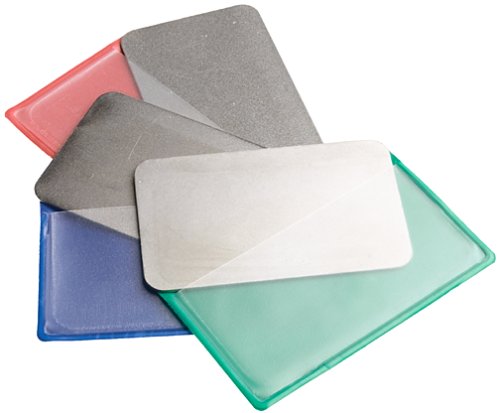

Here's my solution.
DMT Credit Card sharpener. Provides fast touch up of m
