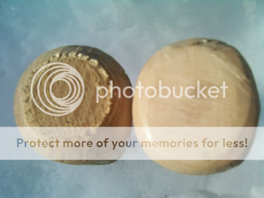

Here is a photo comparing chisel handles made from Hard Maple and a particularly porous piece of White Ash.
Not a super clear photo, the camera seemed to focus on the snow more. But it does illustrate the point- Ash and other open grain woods are more likely to have a delamination type break than a more closed grain wood.
There is a whole lot going on here. FortyTwo blades artical was dealing with ring porous conifers, and the difference between early and late wood. The picture above of GPigs is showing us the difference between a ring porous hardwood (Ash) and a diffuse porous hardwood (Maple).
What I do know for sure is that you can't violate growth rings without also violating grain. How many diamond shaped patterns did the original poster have in the upper part of his axe? Not sure, but I bet it was not good.

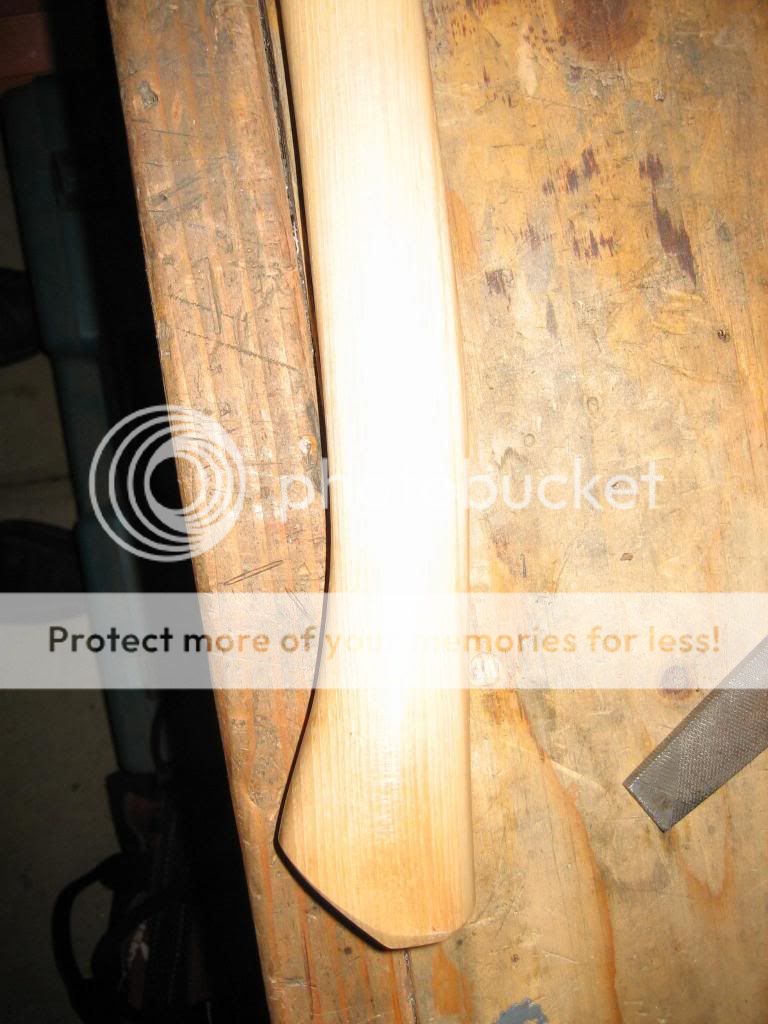

Wow,I had no idea this would spark such a debate. I did here back from Council today via email.It was prompt but not what I hoped for. This is there response copy and pasted.The spec for the axe does not call for a particular grain alignment. We have found that the grain orientation should not affect the use of the tool with normal use, especially on the shorter handled tools. We do use specific grain orientation for our Velvicut line of tools as they are a premium product but we do not guarantee grain orientation for our regular line. If you do wish to return or exchange the axe, please contact Curtis at Omaha Knives where you purchased the tool. Thank you. Wel now I have a decision to make. Use it as is, buy another handle and hope for the best or exchange for a Gransfors Bruks small forest axe. Here are a couple of side shots where you can see the grain runout.

I wouldn't be happy about it either, but I would just keep it and use it. I'm sure it'll be fine and you'll eventually forget about it the more you use it ;)
Contact Omaha knife just as an FYI. They will tell u the same thing. Then use it. It won't be an issue unless u over strike or really abuse the hell out of it.
On a short axe like that I wouldn't be too concerned, though it does seem to have runout in a high-stress location. I'd do like Operator said and contact Omaha Knife then just go ahead and use it in the event not being able to secure a replacement.

In my experience grain orientation matters very much. ALL of my ax handles over 20 inches long or so that didn't have proper grain orientation failed along the grain eventually. The only failures I've had on proper grained handles is from the wood near the head getting too damaged from overstrikes and the like.
The combination of poor grain and heart/sap wood in that handle would make me send it back in a heartbeat.
This handle failed after less than an hour of use, and it never got struck against the wood I was chopping.
I think that the manufactures insistence that grain orientation doesn't matter is simply their way of trying to be able to use less expensive, poor quality handles. Because a lot more people buy axes than use them, they get away with it.
Considering how much time and effort it takes to rehang an ax, I think it's crazy to accept anything but a near-perfect handle.

That's a great example of some of the crappiest hickory you could possibly come up with. It has mostly the porous, fast spring growth. The bands of summer growth are tiny, almost nonexistent. That handle may have been doomed regardless of the grain orientation.
