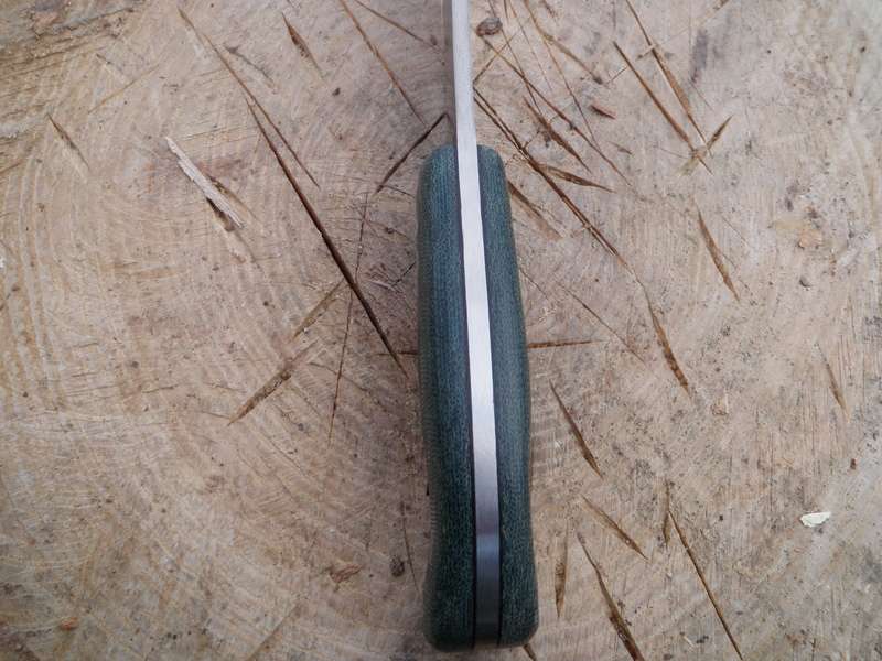

Here you can see the smooth and subtle contours of the knife.
Excellent job on the finish, no glue or tool marks.

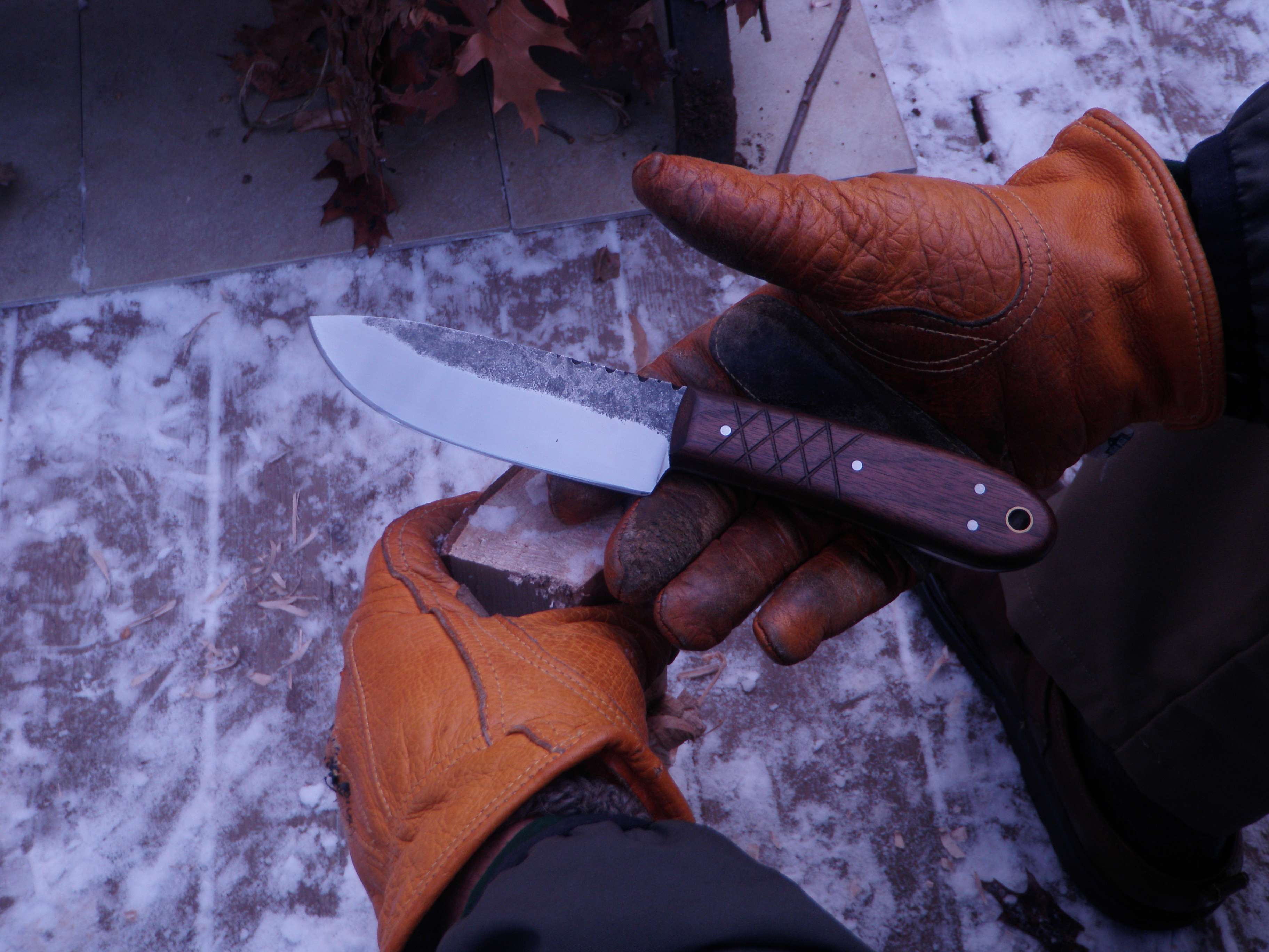

The first thing I noticed about this knife was the superb fit and finish. I could not find a flaw. The contrast between the hand rubbed finish and the forge marked flats is striking and very stylish. The file work is even and eye pleasing.
The edge albeit on the thick side is even through the length of the cutting edge. The point, while flawlessly executed is not pointy enough for proper drilling due to the thick grind.
The handle on this knife is about near perfect for my hand and tastes. It is a simple yet elegant mating of wood and steel. Tasteful pin work and cross hatching give this knife a pioneer look to it. I could not help but call my younger daughter “half pint” while testing this knife. No palm swell, just evenly radiused edges all around that gives good purchase for hard use yet is nimble for good control and repositioning in various grips. I could work with this knife for prolonged periods. No hot spots in any of my favored grips.

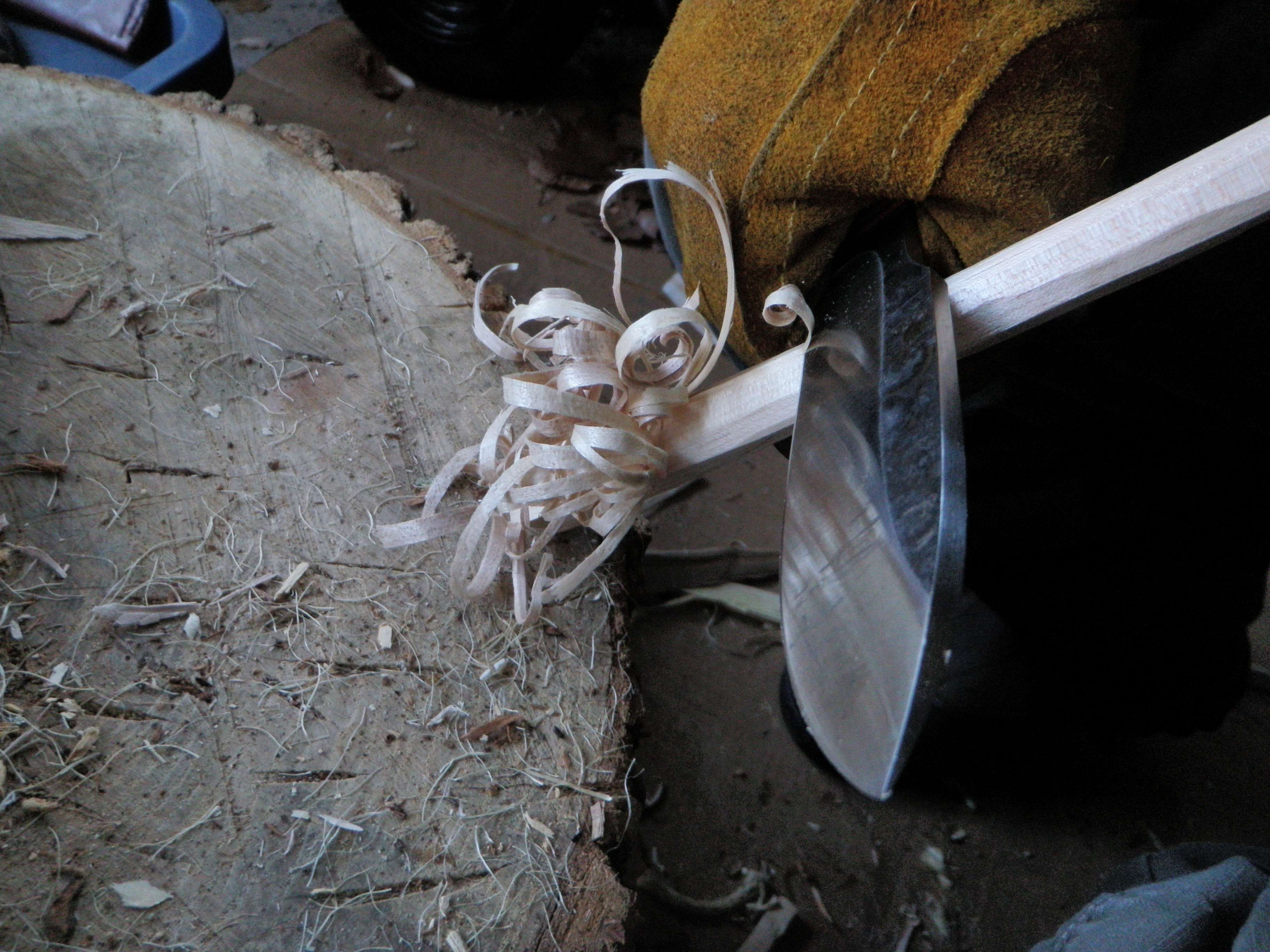

In notching and whittling wood that thick secondary bevel really hurt this knife. It wouldn't bite into the wood very well, at times it frustrated me. I have no doubt in my mind I could have knocked the shoulders off the edge in no time with a stone, and have this knife shaving wood like a champ.

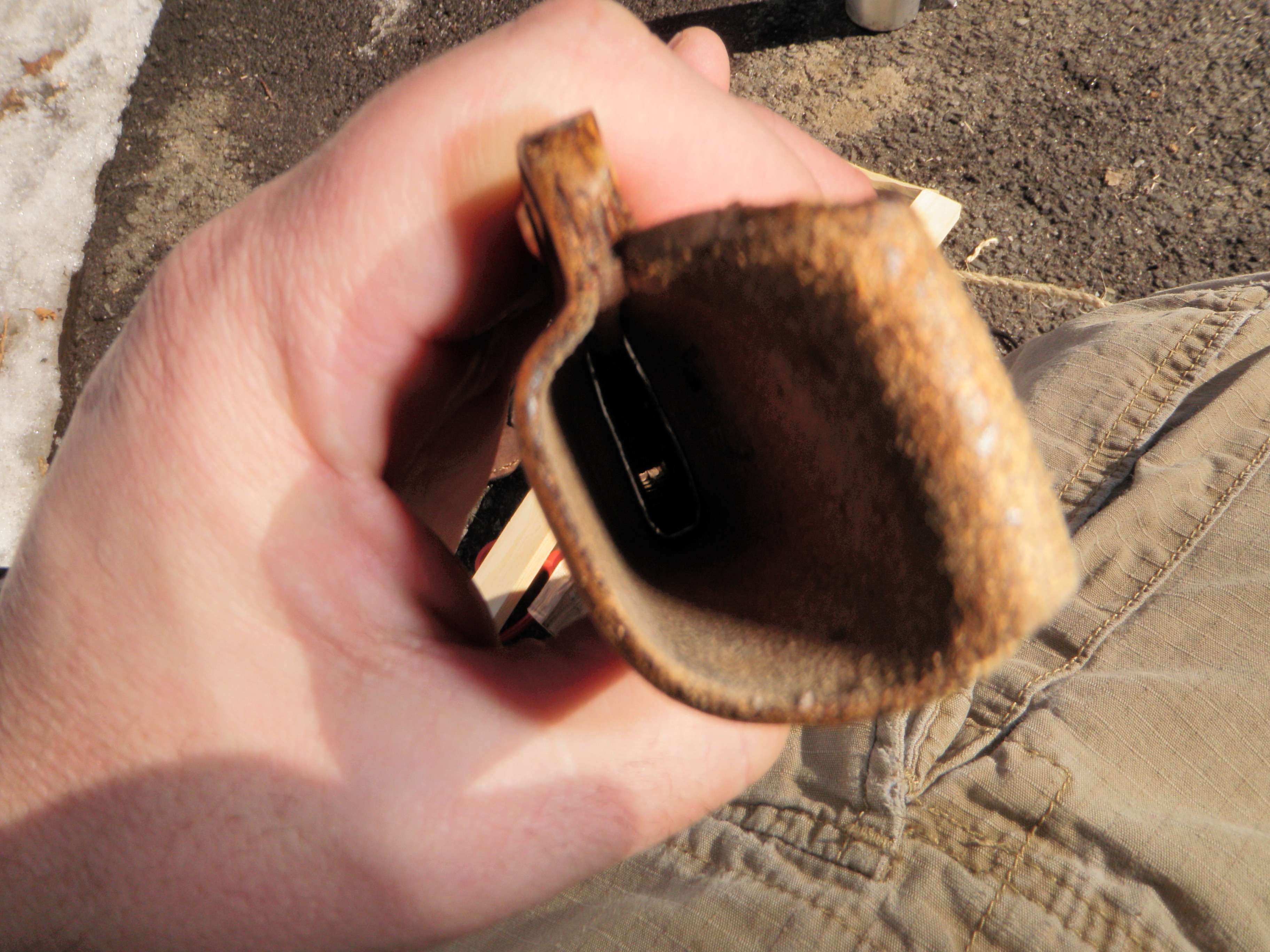

The sheath was a classic pouch style. The edges were smooth and the stitches were solid. A good secure sheath.

Here's a good pic of the perfectly even ground, but thick edge.

I had a little trouble with fuzzing this stick as well.

The sheath was also very original. Stitching was very nicely done, edges were beautiful, and had a great finish. It is actually quite nice to look at , too bad it doesn't hold the knife in place.. I am sure Mr. Turley will correct that when he gets the knife back.

Here's a pretty good look at the grind and that bit of handle that bothered me a little in the chest lever grip.

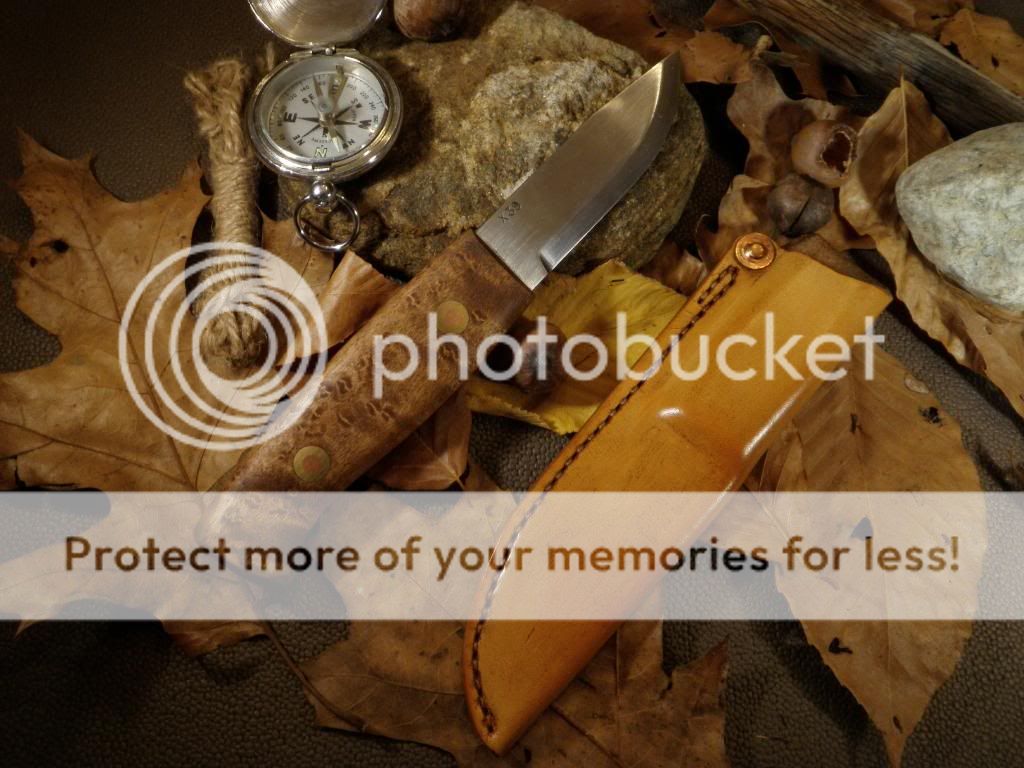

Please find enclosed my submission to the Bushcraft Knife Contest. The particulars are as follows:
The knife has a blade about 3 1/2" long, handle about 4 3/8" long.
Blade: A-2, Stock removal
Handle: Maple held in place with copper pins peened into brass burrs. The tang of the knife, while hidden is still quite broad, and extends past the second handle pin, the extent this is almost a full tang knife.
Sheath: Hand sewn leather with an aluminum insert to prevent the blade puncturing the sheath in a fall.
Special feature is the striker/scraping edge on the spine of the knife near the point. I usually choke up on the blade with my fingers when using this edge, handy for striking ferro bars and scraping things that would otherwise damage the edge. The knife and sheath were completely made by myself.
Well guys, have fun and thanks for taking the time to do this….
