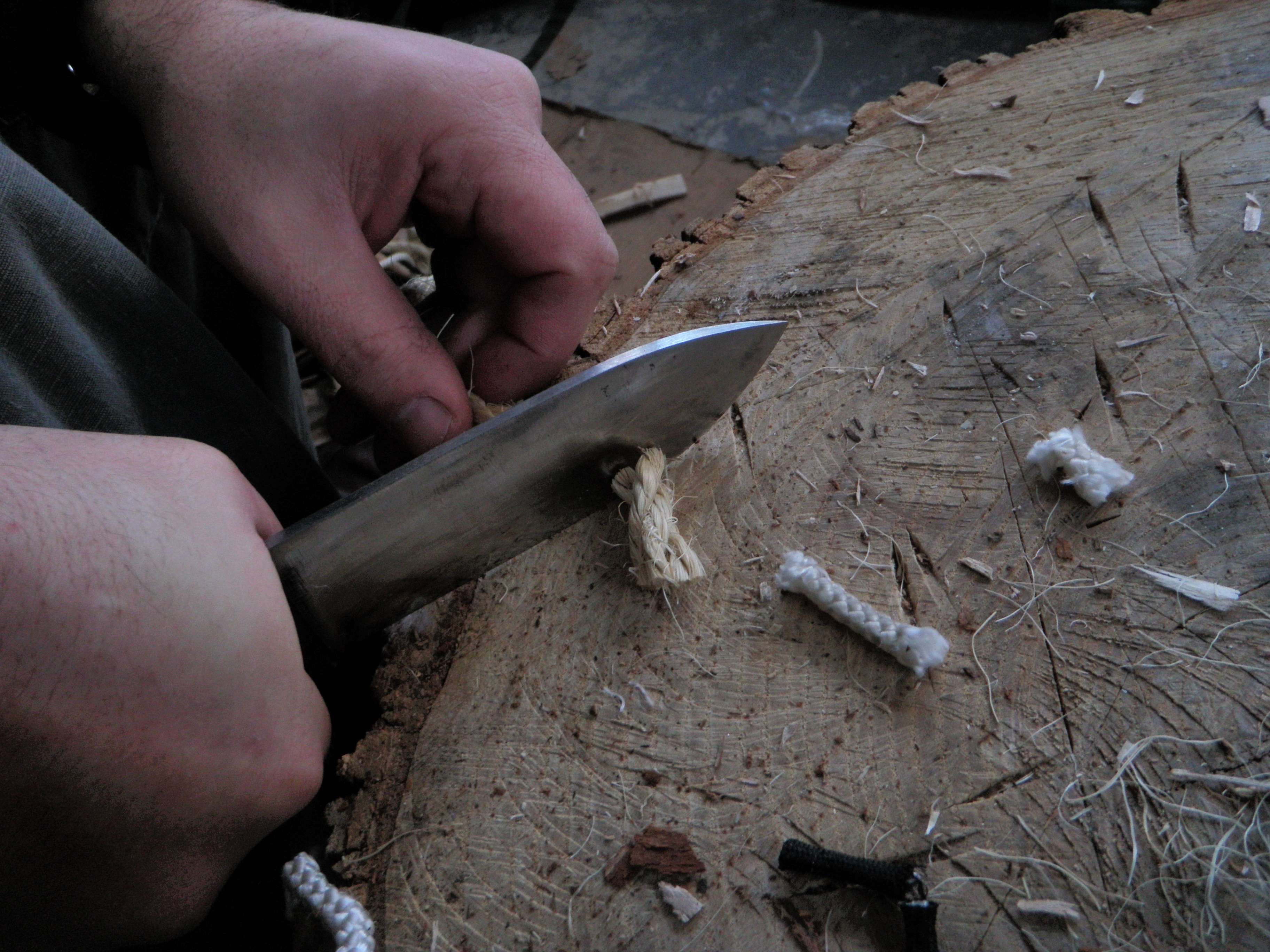

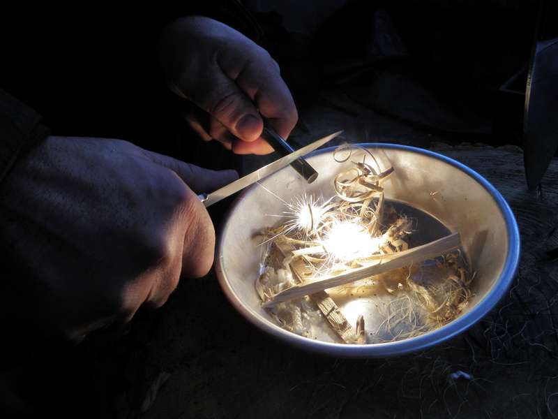

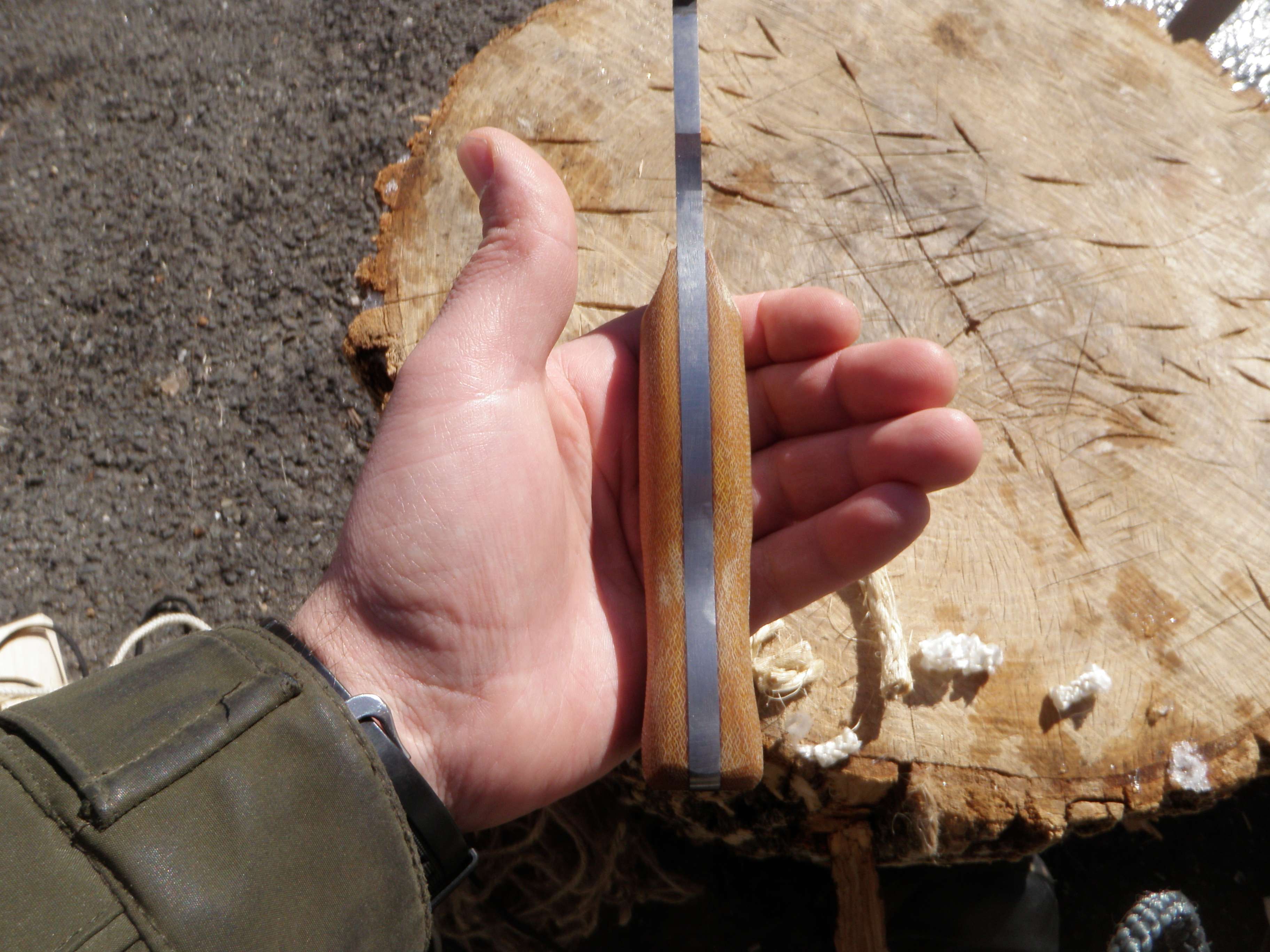

Here is another knife that I didn’t feel has a bushcraft / woodcraft look to it. Looks more like a camp Kitchen knife to me. However the maker obviously feels it would make a great woodcraft/ bushcraft knife so I was excited to use it.
Fit and finish was pretty good. The handle was fit to the tang perfectly and all the pins were flush. The wood had a nice finish to, not very polished as to leave a good grippy texture.. The curves of the handle were nice and subtle and made for a comfortable grip. The handle was wide and not too thick allowing for a very secure grip with gloves on in the sub freezing temps in which we tested it. The maker took care to round off all parts of the handle, which made it extremely comfortable in all the grips I use for Bushcraft.
The blade had a full flat grind which was very nicely done. The stock was about 1/8th thick and evenly tapered down to the secondary bevel. The secondary bevel wasn’t perfectly even, but the maker knocked off the shoulders and made it very very sharp!
The sheath was very nice. A deep pouch style with some nifty tool work. It had a great finish and the stitching was good.
From the time we started testing the knife it was clear that the maker made this knife to be used. It went through the cordage very quick. When it came to battoning the smooth thin grind pushed right through the hard maple. In whittling the thin edge bit in petty deep and didn’t need allot of pressure behind it despite the wide blade. The tip was pointy and sharp. The maker took care not to thin the tip too much, so it was strong. The knife drilled really well.
The balance of the knife and shape of the handle made for quick and easy transitions between grips.
Again I still look at this knife and see a camp kitchen knife, however it performed very good at all the tasks we gave it. I would have total confidence if I had this knife on my belt for an extended outing in the woods. Great job Chuck Cook!
I loved the look of the wood on the handle, however I if I owned this knife I wood have to make sure I oiled it frequently. Due to my dry forced air home there was a bit of shrinkage in the wood. The maker has had the knife back for a couple of weeks and has already reported that the wood has started to come back. So that’s great news.

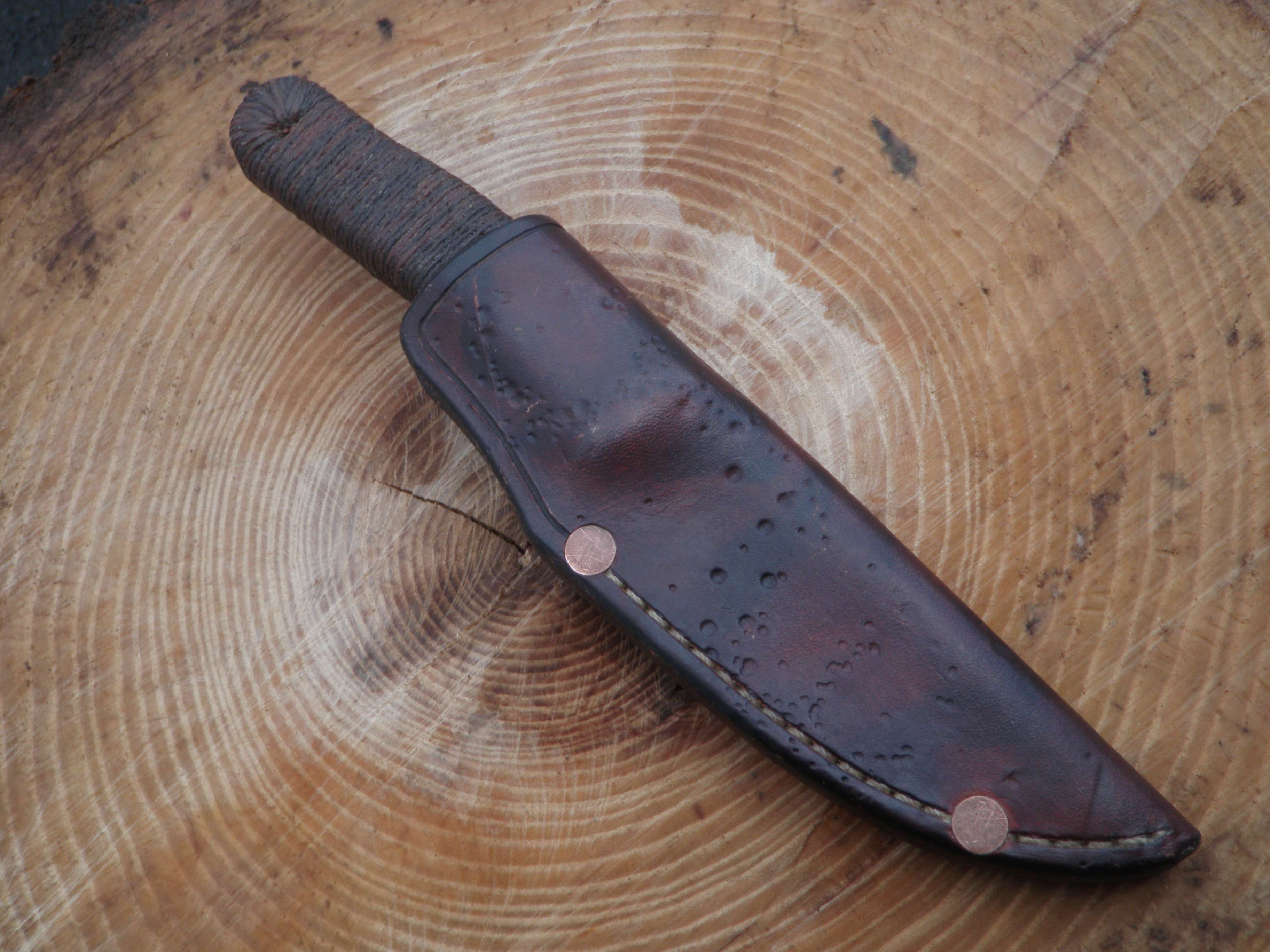

Handle is leather backed, hemp wrapped and epoxy soaked. Turks head is handmade grass cordage.
Sheath is 10oz hand stitched, riveted and wax dipped.

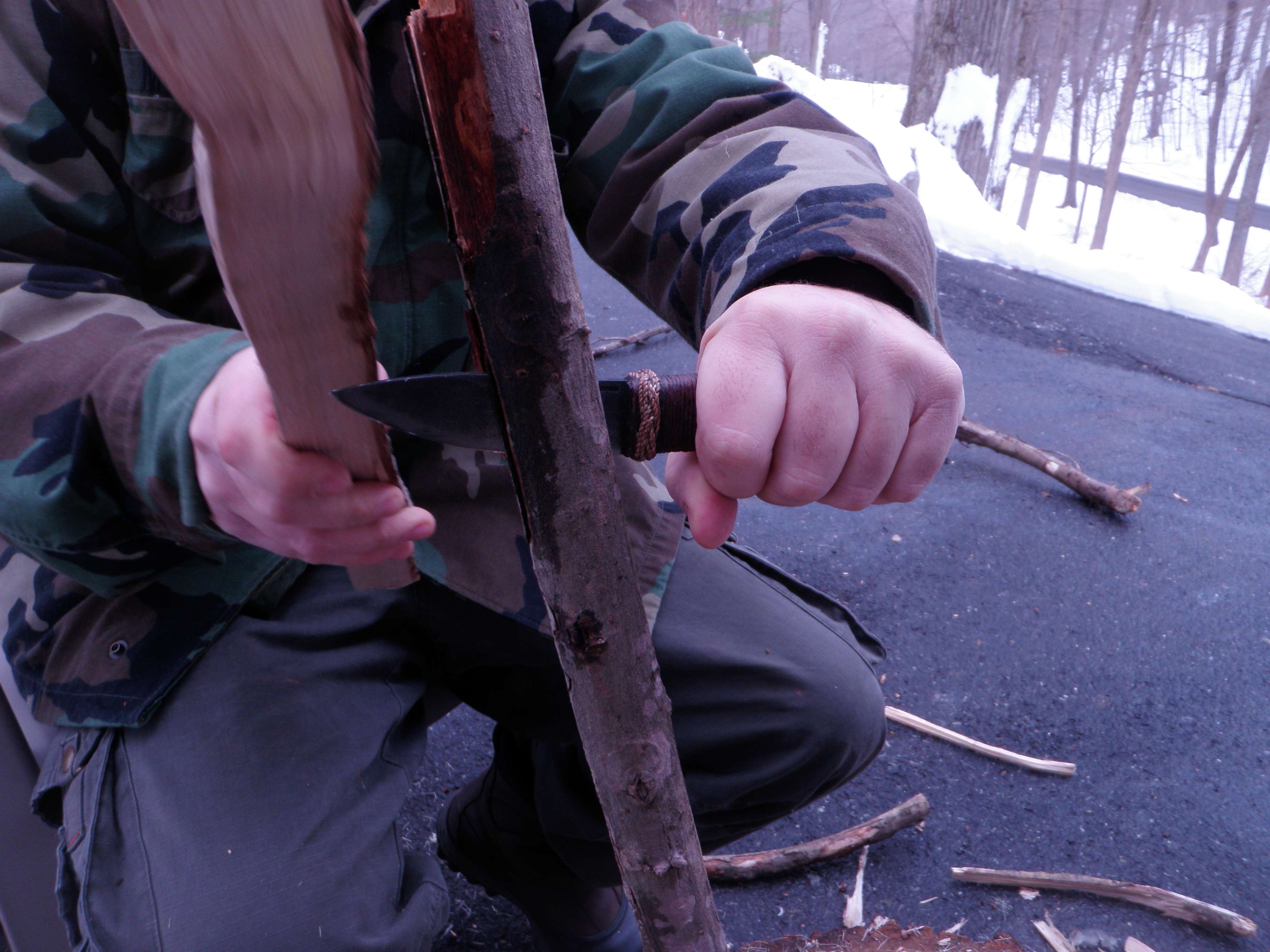

I was very curious to get to handle and use one of Rick Marchand’s knives. I have been following his evolution in skill and style for a few years. More than any other maker that I know, Rick’s knives ride a Zen wave from concept to creation. Along with respecting the elders and letting designs flow into him from the universe, Rick seems to reverse engineer his knives from an actual cut.
When I first received the knife from Tony, one of the first things I noticed was the level of commitment to an idea and to the most flawless interpretation of that idea. One would think that when going the rustic route, there would be quite a bit of room for error, but if this knife is any indication, Rick takes none of that room. The knife is a work of art. The sheath is a solid, secure, stylish and simply beautiful.
In the hand it is very nimble and well balanced. The grip is very secure. There were other knives tested that were more comfortable. I feel that for me it was a matter of thickness and that is subjective. The only issue arose when I was drawing the knife with cold hands. The texture made my palms feel a bit raw. Aside from that I was able to perform all tasks with panache. That’s right I said panache on WSS.
The blade performed so impressively. The continuous curve and virtually no ricasso make the most of its 3 ¾” length. Super sharp with its slightly convex grind and mirrored micro bevel, it has the right geometry for easy cuts, carving, whittling, sapling cuts and batoning. There was no perceptible loss of sharpness after all of our testing. One of the most interesting aspects is the diamond cross section, allowing a maximum of lateral strength while keeping the weight to a minimum. It is a feature that could easily have been omitted and probably not even be noticed but embodies a maker’s integrity.
Overall this is one very impressive package. It was a true pleasure to use, carry and test this knife. I have to be honest here and say that it was the knife's looks that attacted me but its performance is its true beauty. This is a tool that will give you a lifetime worth of service and would be an heirloom to pass on to the next generation.
Big Mike's review oF Rick's knife
Wildertools.
I had trouble getting my hands on this knife, from the beginning Tony made it clear that he was in love, and I think Marcelo had to use slight of hand to get it to me; it is a Savage Package, the blade, the handle, the sheath, everything about this knife looks great and works well; the biggest surprise was the handle, it worked better then I expected, it did not seem to attract or trap debris, and contaminants like blood and Tony's drool washed off easily; I will own one of Rick's knives some day soon!
Wildertools by Rick Marchand.
I had the pleasure of meeting Rick a few months ago at the Custom Knife show in N.J. That was the first time I got to hold this knife. Allot of things went through my head when I got this knife in hand, but apart from how unique and beautiful the knife looked, I mostly couldn’t wrap my head around how natural it felt in hand. I was always under the impression that a cord wrapped handle was going to be too thin and uncomfortable to use, boy was I wrong.
Lets talk fit and finish. I have handled a few fully forged knives before but never one as nice as this. The grind was perfectly tapered from spine to edge. And that edge, from pics you may think it has a secondary bevel, but it does not. Rick spent allot of time hand sharpening this knife polishing the very edge. I do that with allot of my knives, but I can never get it as perfectly even as he did. The finish on the knife was excellent. It had texture, and a look as if this knife was made a hundred years ago. I have never had a knife with so much character built into it.
The handle was what really got me. It was wrapped completely in hemp, extremely tight and perfectly even through out. Inside the hemp was a strip of leather on each side which gave the handle some girth and contour. The maker then finished it off with some cordage made from grass from his backyard and tied in a Turks Head knot. The whole handle was epoxied and hardened.
The sheath completed the package. The leather was very thick and finished to perfection. The stitches lie perfectly even in their own channel. Large copper rivets help secure it and add a touch beauty. The opening of the sheath was designed in a way to increase tension, and is slotted in the back end so that the knife will not cut into it while withdrawing the knife. It is form, meets function, meets beauty in one package.
Okay, yes I think this knife had the best fit and finish of the bunch, but a good woodcraft/bushcraft knife has to be allot more than pretty. It has to cut good, offer control, be easy to use, carve very good, have a sharp, but strong tip, and most importantly to me be comfortable while doing all those things.
In cutting this knife was outstanding. Again with no secondary bevel to hang it up, so it went through cordage with minimal force behind it. The continuous curve from tip to ricasso made for a very strong performer in slicing and power cuts. It bit deep in to wood when I wanted it to and was easily backed off for finer whittling. The grippy texture of the wrapped handle aloud for smooth transitions between grips and lets talk grips. The back curve of the handle was oh so comfortable in the hammer grip and reverse grip. The slight contour and smooth tapering made the chest leaver grip a pleasure. The thin profile of the handle and the blade made choking up on it a dream. If your one of those guys that likes a guard, the Turks head knot acts like one!
This knife was extremely easy to use and performed about perfectly in all tests I put it through. It was second in comfort for me only to the Bruce Culberson.
Since Rick has won these challenges in the past and I knew I was going to buy this knife, I beat on this knife pretty hard. I crossed battoned some nasty maple, smashed the butt of the handle with a batton, while driving the tip into wood. I even did a little prying. This knife is not all looks, it is built to be used! The wrapped handle is very strong and resiliant.
