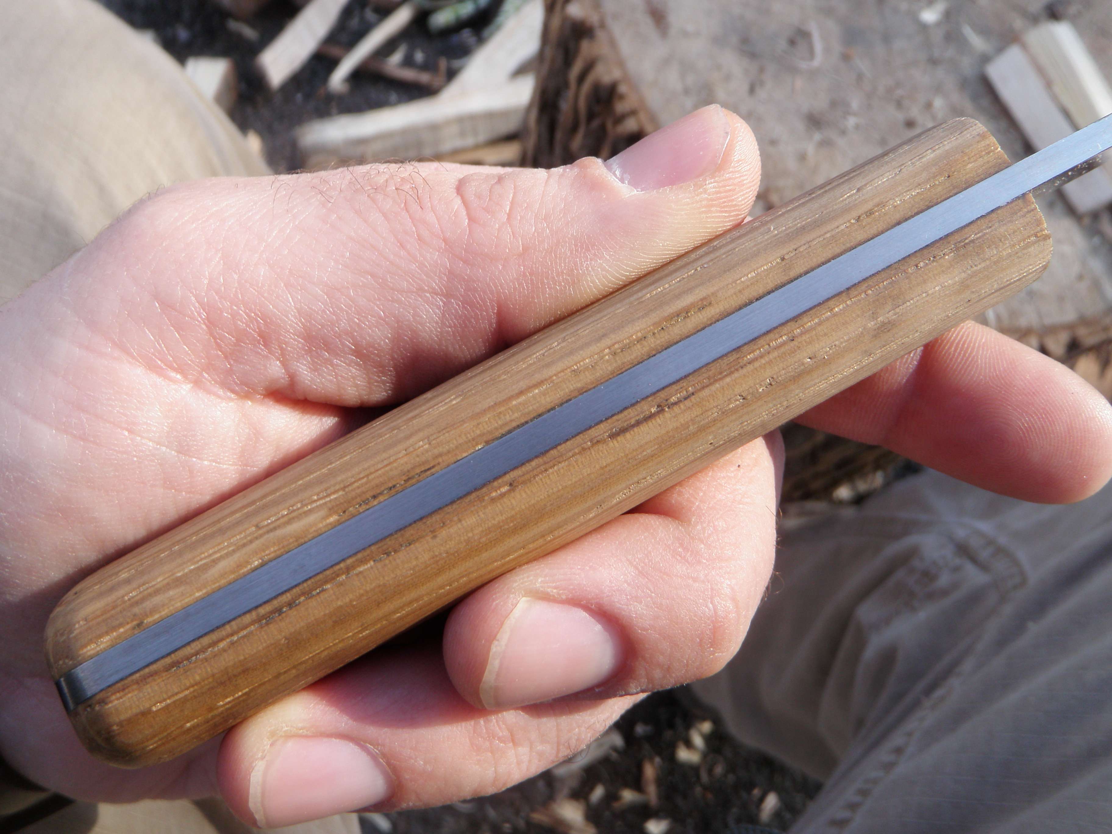

The fit and finish of the knife: The wood handle was perfectly flush with the tang, pins were sanded flush. A little dark circle around the lanyard tube, but not bad. The wood handle was rounded nicely every where except the top. The handle slabs were symmetrical. The finish of the wood was good, it may benefit from another soaking in linseed oil.

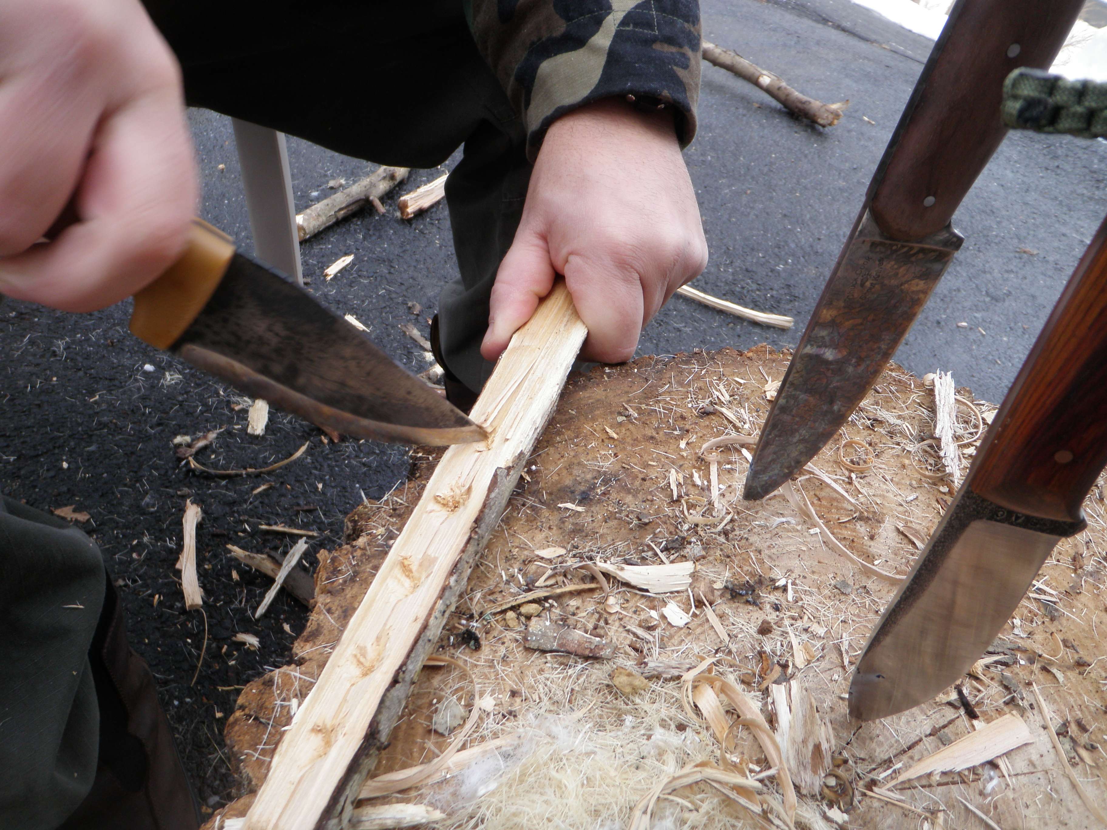

Okay, lets talk performance! In a word: OUTSTANDING! The sharp scandi cut through all the cordage with minimal effort It bit deep into wood when you wanted it to, and was easily controlled for detailed tasks. It battoned small stuff great, but obviously you weren’t going to split anything big with this small knife. The spear point made for a superb driller as well. It was a strong knife through out the use we gave it. It was very comfortable in the hammer grip and the finger indent gave it serious control in that grip. It wasn’t that comfortable in the chest leaver grip due to the sharp 90 degree edge of the handle. Reverse grip was okay. The spine was very sharp for striking firesteels as well as shaving wood. Extended use of this knife was not necessary because it made short work of all tasks…

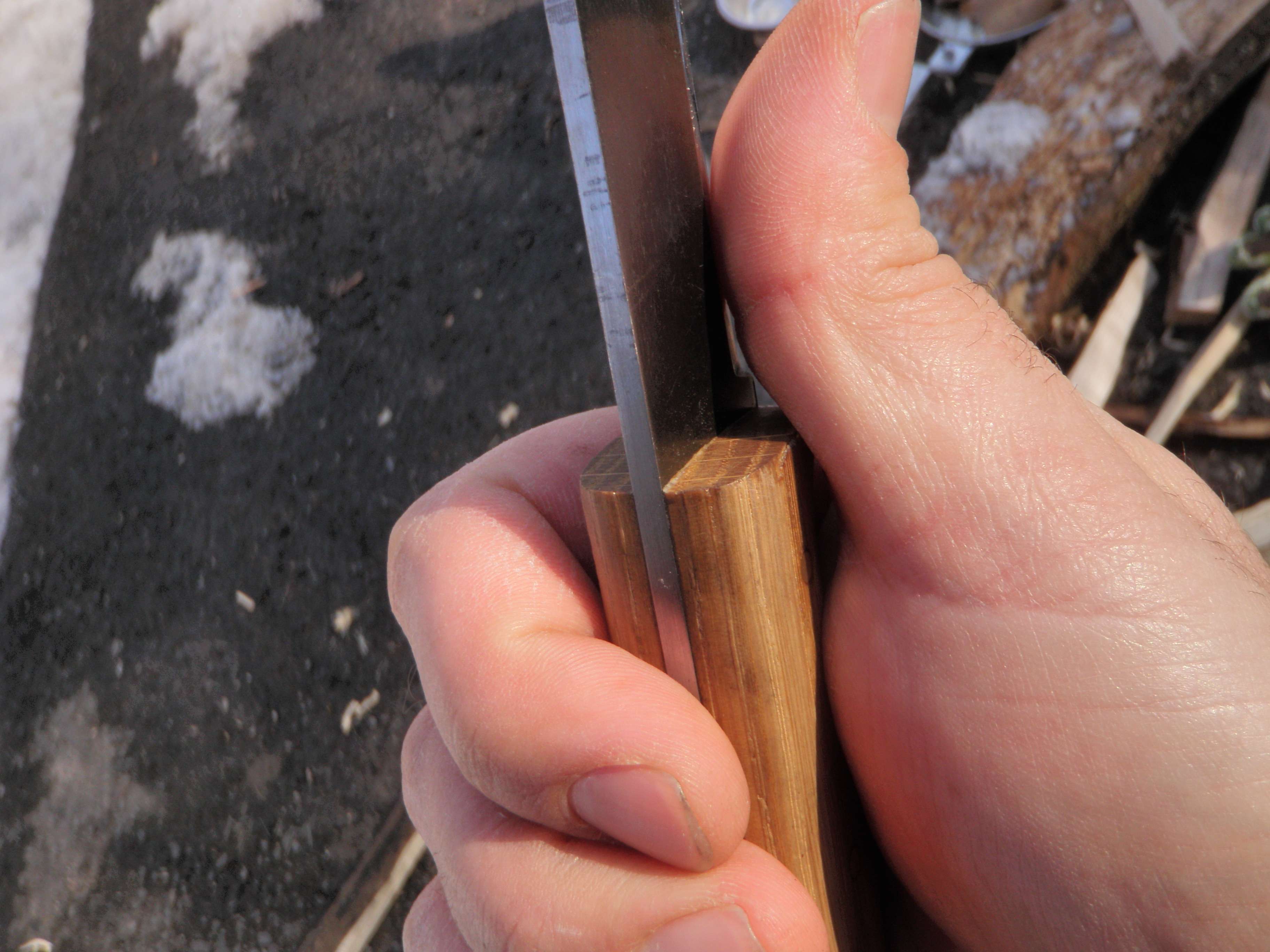

I wish this part was rounded off like the rest of the knife
A good full size handle
Even hard Maple was easily curled

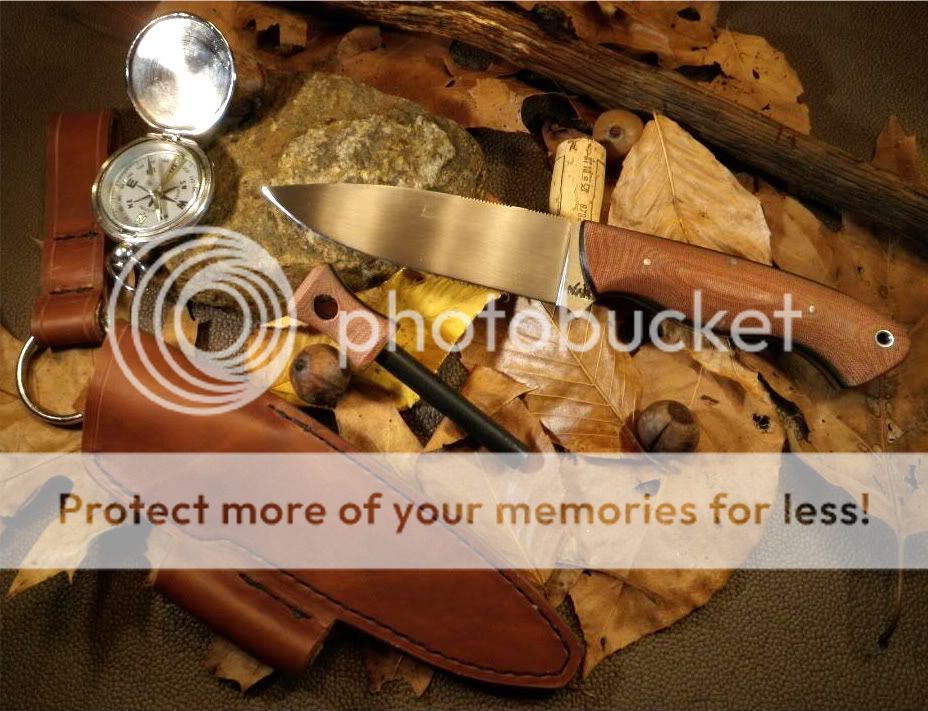

NWA Knives by Nick Allen
Mantis
5/32” D2 tool steel heat treated to 60 -61 Rc.
4 3/8” cutting edge
9 ¼” OAL
1 3/16” wide @ widest point
Natural canvas over black paper micarta handle
Stainless pins and tube
9 oz. leather dangler pouch type sheath treated in beeswax
Matching firesteel
This knife was designed for everyday use while out in the woods. The blade is a full height flat grind. A standard v-type secondary bevel is put on as I feel this is the easiest to reproduce. The spine is square for easy striking of the firesteel. The handle is contoured for comfort in nearly any position.
I chose D2 for its ability to resist staining and its amazing ability to keep its edge for an extended period of time.
His one should also handle kitchen and food prep very well with the full height flat grind.

To the eye, this doesn’t look like a bushcraft knife. This knife is reminiscent of a scaled down mountain man’s knife. The knife is nicely crafted and there are no issues with fit and finish. The lines are pragmatic yet stylish in their simplicity. The mesmerizing pattern of the mustard patina adds a unique look and an element of protection from corrosion. The sheath is well crafted and pleasing to the eye with its basket weave pattern.
Fit and finish is very good on this knife. As mentioned earlier, there was a tiny bit of shrinkage where the wood meets the tang but nothing to cause discomfort.
The blade is pure function at its core. The thin full flat grind makes this knife a superb slicer. Whittling on soft and hard woods is easy and precise due to the excellent edge geometry . The point is very well suited for drilling into a hearth board. The nearly 5” blade makes batoning easy.
The Handle is well suited for tasks ranging from carving, slicing, scoring, scraping and skinning. The subtle contours make this knife very comfortable and despite its slim profile, I did not experience ant hot spots or fatigue during prolonged use.
Overall this is a well executed cutting tool that would give anyone effective performance in the woods.
