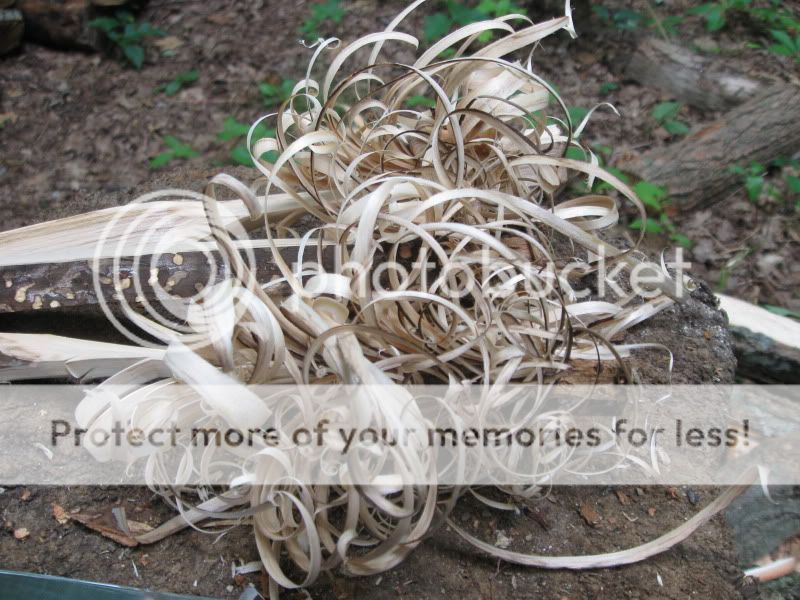

It was a very good workhorse at PWYP! The thick handle slabs and thin flat grind made it an instant hit with all the fabulous whittling that it was able to do! The knife made extremely long distinct curls while making fuzz sticks, yet was able to throw the thick chunks of wood quickly while making a spoon. I did not have any problems with odd grinds or re-sharpening, as it held an edge very well while working some serious hardwoods. The four pins were laid out geometrically, right in line with each other and the overall handle design was well thought out, not rushed and improvised. The little details like these really set Walter apart from many other makers. The grind was neither to high nor to thin, and did not mis-behave while doing what a knife should. It spat out fine carvings with no problem, and the knife was still able to handle the heavy stuff. Walter made quite the knife, while listening to customer demands when he envisioned this cutting tool. My only complaint was the sheath, which it sounds like Tal is already helping out with. I can't wait to see what become of this maker!!!!!

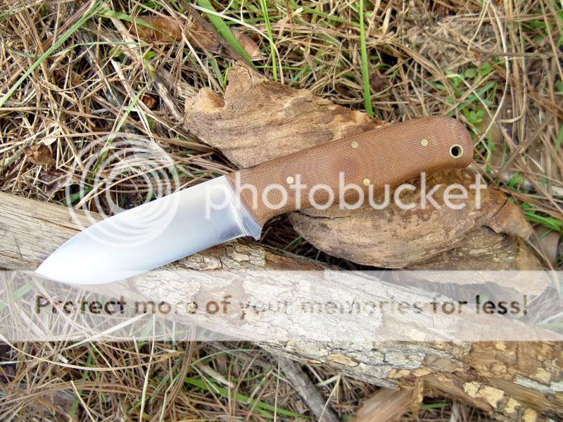

Fit and finish on these knives is not flawless, but very good nonetheless. The scales are flush with the tang all the way around, the pins are very carefully laid out, and the scales are symmetrically shaped. The primary grind is smooth and even, and wonderfully thin at the edge. The edge itself is a nicely done convex bevel with a high polish that is gently transitioned into the primary grind, leaving no apparent shoulder to create friction when cutting. There are a few coarse grind marks that are just barely visible on the edge side of the tang, which is the only real finish issue.
The sheaths that come with the knives are spartan, but attractive in their own right and extremely functional. They are sturdy and hold the knives securely. I prefer a dangler sheath, but these are a prime example of a well made sheath in this design.

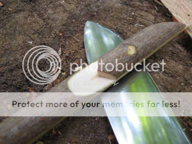

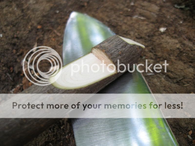

These knives are both excellent cutters due to the terrific cutting geometry they have. They have high, thin grinds that terminate with highly polished convex bevels. This results in lightsaber-like performance when cutting wood, food, and other things like cardboard and cordage. Walt has done a terrific job in creating a very good cutting edge, which is one of the most important aspects of a knife.
The handles on both knives are contoured very nicely. They are a bit larger in diameter than I prefer, but I have strange tastes. They are thoroughly comfortable, and after some extensive use I never had an issue with any rough spots, hot spots, or awkward hand positions.
These knives make feather sticks, cut notches, slice apples and hotdogs, and baton kindling with ease.
The biggest drawback of these knives, for me, is purely a personal style preference. They have wide blades that terminate in a fairly bull-nosed tip. I much prefer a narrow blade with a pointy tip (The mora #1 is an excellent example exactly the sort of blade shape I love). I would be very excited to see Walt's interpretation of a blade shaped like a mora, and I'm sure that he would execute it wonderfully. Blade shape wise, these knives don't really do it for me. Tony knows my preferences (since I whine about how wide his blades are all the time when I get to handle them :D), but asked me to get in on this passaround anyways, and I'm glad he did. :thumbup:
