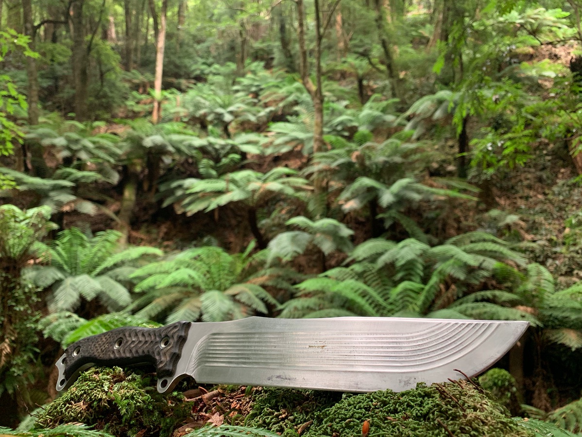

Ok, promised photos. Starting with the choppers. The top Busse, a Forsaken Battle Mistress, gets the work done with brute force. It works, and I love the Bowie design. The CPK wins here though, it chops the best by far between these two, and that's by design with the special S-curve grind and attention to overall cutting geometry. Both of these knives are cut from ~1/4" thick steel. However, the Scrapyard 1311 at the bottom is a sleeper; it chops very similarly to the CPK, in part owing to its thin stock and thin edge (for a Bussekin). And it's a relatively "budget" knife too, hard to argue with that (it was less than half the money of the other two).
