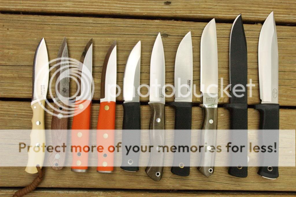

In the current Busse line I think the CABSLE comes closest but it is not scandi if that is specifically what you are looking for.
For me the Skookum Bushtool in 3V is the best in that size / style. I have yet to find anything that cuts like it. The Spyderco Bushcrafter has a superb handle but the Skookum is a better cutter.
I think part of the secret of the Skookum's cutting power, in addition to being a true scandi with no secondary bevel, super sharp, is the continuous curve of the cutting edge, just like the Fallkniven H1, another very good cutter despite being fairly thick. (3, 4 & 5th from left below)
Perhaps Busse could do a scandi-vex. I have a Liten Bror in 3V, it is scandi-vex and is also a wicked little cutter.

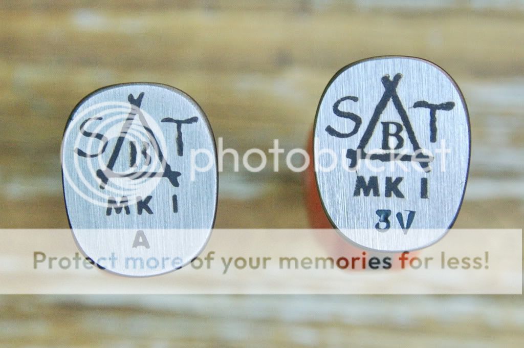

Your collection never ceases to amaze me! Which model of the Solomon do you prefer, the a or 3 v.
Thanks
Thanks
Thanks. I am ashamed to admit that I don't know. I have never really done any comparisons of them and more often than not I did not even know which one I was using. I just grabbed one without looking and used it. But except for a few very prominent characteristics of specific steels, as of yet I am still quite ignorant about the nuances of the different steels due to lack of sharpening skills and not having placed much focus on observation of the finer nuances yet.
Rod Garcia's (the maker) impressions of each of the steels can be found on his website. He will be infinitely more knowledgeable than I.

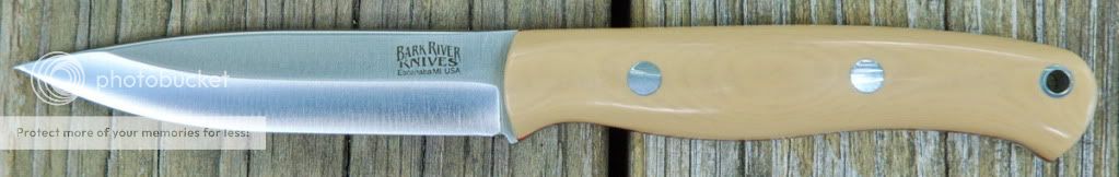

If you can find one, Spyderco did a limited edition in collaboration with Woodcraft.It's called the Woodcraft Mule in CPM S30V.
Here's a pic of one made by a fellow member here, Samid. I borrowed his photo.
