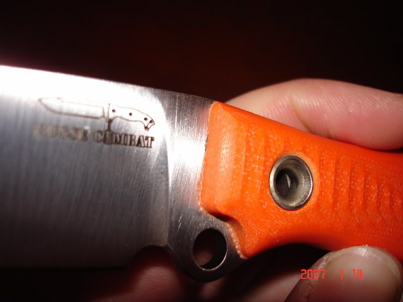

Below is a picture of the edge of the G10 handle scale.
Notice that it seems to "bleed" onto the blade, like it was not sanded smooth on those edges before application to the tang.
Here is a picture of the front handle rivet.
When driven, it was not driven perpendicular to the knife, and as such, it does not mate flush with the handle scale on one side. Compare this picture to the one above and you should be able to see a difference.

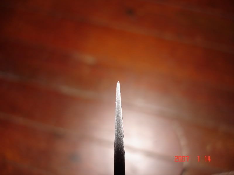

A picture of the tip of the blade
You should be able to see two things in this picture. First, the edge is pretty obtuse. The knife is sharp, but again not scary sharp. And second, the edge is not ground even.
None of these cosmetic issues affect the performance of the knofe, except for the obtuse edge geometry, but I've got a stone, will sharpen.

:D Yes it looks quite imperfect, but b4 you just throw it away let me email you my mailing address. I love imperfections;)

Having had a Busse with a tip that looked like that one, I can tell you from experience- call the shop and they will tell you to send it in and they will make it right- and they will, too. I'm sure they'll replace the rivet as well. It is a shame that they have these issues, but they are A+ at taking care of them.
Besides the other imperfections, the blade is ground like normal busse blade. It has a asymetrical edge where one side is convex ground and the other flat. The one side is always going to be overground, almost all busse blades are like that....I think thats right. Now the other imperfections. Thats another thing.
The use of the asymmetrical edge on Busse blades has been discontinued for years. The edge on that Game Warden is not supposed to be ground like that.

Question: Is it really so that unevenly ground edge makes no difference in performance?

PatriotDan, what I meant was that the knife is sharp, and the uneven edges do not take away from that sharpness. Besides, a stone and some elbow grease can take care of uneven edges.

What grind is it now then? because most of my busse's are not ground evenly on both sides.
Very rarely do I get a Busse/SRKW with an evenly ground edge, but that is not an asymmetrical grind. That is just crappy edge grinding. An asymmetrical edge is something unmistakable. One side is ground very high and acute, the silver edge grind is four or more times thicker than a regular edge when you look at it on one side, the other side is normal. Asymmetrical edges are awesome and scary sharp. I have a friend with an asymmetric Basic 7 that is going to post the picture soon.
For the heck of it, just checked my few Wardens (6).
One has a slight case of uneven grind (noticed at the tip...similar to Hlee's picture but not as extreme). Two have a tiny bit of what he describes as "bleeding" from the micarta handle onto the blade. The rivets on all of mine seem perfect to me.
The "bleed" problem was solved with about five minutes' effort -- a bit of sandpaper and an impromptu metal tool took care of it with almost no effort. I was extremely careful so as to avoid scratching the finish...

This thread caused me to re-examine my three small Busses, GW, AD and HD. All three appear ok with the exception of one of the rivets on the GW which extends beyond the edge of the scale material when viewed at a 90 degree angle. Looks like it might need a return trip.
I looked at my GW, and it has a little minor "bleed" of the handles where it wasn't sanded, but I kinda like it.. Gives it character.. I'll always be able to pick mine out of a crowd!

Mine had that. It was pretty easy to remove. It did have a new one though, maybe somebody can explain it to me. Underneath the orange slab there is a definite black something (marker, powder, something that won't come off, looks almost like sharpie marker) that is bleeding out. I could send it in, but I have come to accept that Busse's don't alway have the best FandF and it doesn't make any difference in use. Just curious what it is.
