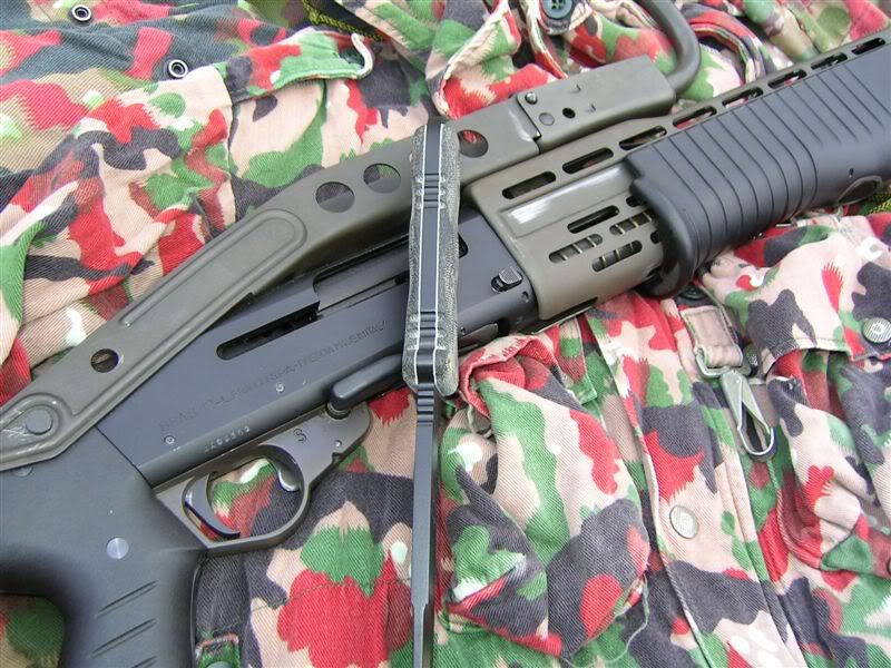

Gentlemen
My TOPS B.E.S.T. with a hunters point in CM154 - CRYO Heat Treated 2X Rc 58-60 Black Canvas Micarta.
Cheers,
André
