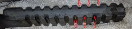

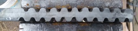

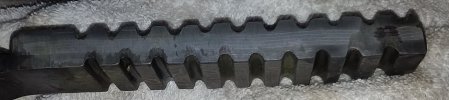

I decided to do a ladder pattern using a billet I had laying around. I'm not 100% sure, but I think this is 3 pieces of 25 layer 0.125" 1084/ 0.140" 15N20 separated by 0.140" thick layers of 15N20.
Here's the billet while grinding the grooves:
Looks like I need to go a bit deeper here:
Ladder grooves complete:
Stay tuned...forging planned for later today (if the wind stays down, but there is a winter storm forecast starting this afternoon).

Looks like I was wrong about the initial billet makeup.
Here's the billet after a quick, 30 second dunk in acid:
It looks like this is two 25 layer damascus pieces separated by 4 layers of 15N20.
It also looks like I need to do a bit more grinding/filing at these spots that don't go quite down to the 15N20... 6b.jpg

BillyO, looking at the etched billet I'm not sure what I'm seeing. I can clearly see the 4 layers of 15N20 in the center (that is the 4 dark stripes?) separated by the thin shiny stripes. What are the thin shiny stripes? The 25 layer Damascus on each side is the dark part that doesn't show any layers?
I can see where you wish the grooves for the ladder pattern to extend into the 15N20 layers for the better contrast. As deep as those grooves are is there any danger of cold shunts when drawing out? If so, how do you prevent them? Do you use flux as you're drawing out to help the grooves weld as they are drawn out?

Hi Sam. If you grind everything down to that, then yes. But here's what I'm thinking this is going to turn out like:
Those thin lines are just light shining off the weld line.
Yes :)
Patience, Grasshopper.....;) (I'm merely quoting Karate Kid here because it was the first thing that came to mind, but in no means want to imply that I'm a Master.:rolleyes:o_O)

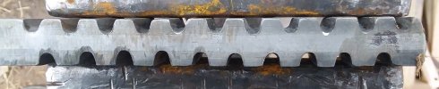

So here's where we are today, this looks better:7.jpg
And here's how to help prevent those aforementioned cold shuts. Along with careful forging. 8.jpg
Ending up with this before going into the fire:9.jpg

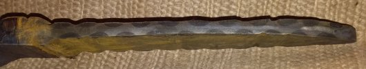

Starting to make progress:
Getting closer:
Almost there:13.jpg

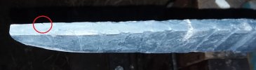

And.......here's where I hopefully learn that I need to listen to that voice in my head a few heats ago at around 4pm when I thought to myself, "It's starting to get dark. Perhaps I should stop now."
Then I thought, "The forge is hot, let's see if these shop lights are bright enough to forge by."
And here's what happened a few heats later when I noticed this:15.jpg
Apparently I wasn't careful enough.:(:poop::thumbsdown: Fortunately it's at the tip and I've got enough left to cut it off and move on...:rolleyes:

Good afternoon, all. Hopefully you're having a better one than me:(.
Here's the update after an hour or so.

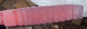

First thing to do is clean off the forge scale to see how well I did avoiding those aforementioned cold shuts.
Looking towards the tip, apparently I either didn't bevel the edges enough (as shown in post #9) or pay enough attention while forging. Looks like I've got a bit more clean-up to do. Hopefully they aren't too deep.

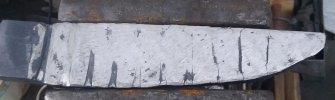

Here's what a cold shut looks like as you grind it away, gotta get rid of those dark lines!
I didn't take a picture of what the billet looked like with all the cold shuts ground out, but other than the one at the tip, they were all fairly shallow and I didn't have to remove much material for them to disappear.
Unfortunately, I came across this in the middle of the billet at the spine:18.jpg
After a bit more grinding:
You're getting longer, not shorter:mad:?!!? Grrrr...... More grinding:(...
Dammit!!! it's getting longer, not shorter!!!!
At this point, I'm now about halfway through the billet and it's been obvious for a while that this isn't a cold shut, but rather a poor forge weld at the multi-bar/15N20 junction...

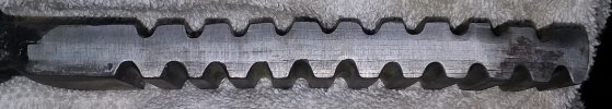

Hello all. I decided to clean this up a bit to see if there's salvageable steel here (and I think there might be enough to resume this in a couple of weeks...)
Sam Dean Sam Dean - Here's what it looked like after another quick etch, maybe this will give you a better idea what I was shooting for?20191220_151539.jpg
