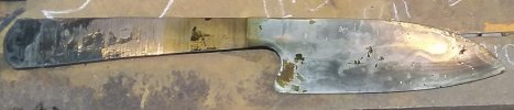

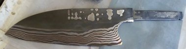

I'm not sure I'm following why. I built it this way so that the pattern will look like cloudy skies over a river. I was thinking tapering it at least to around 3mm (0.125") at the tip.I would not taper it since there is a core along the spine and you certainly would not want to grind into it.
Perhaps I should have noted that the sketch of the billet was not to scale, but I am a little worried that I didn't make the outer 15N20 layers thick enough. The original stack was two 0.070" thick pieces of 15N20 on the sides sandwiching 3 pieces of .125" 1080 in the center.If you taper the blade you may grind right through the outer layers and expose the darker core. This would run your "cloudy skies over the river" thing.

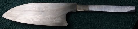

When you drill through thin material, do you use a backer block of wood or something similar?it was a real pain to try to get a reasonable hole drilled into it....
yes. it wants to get about 3/4 of the way through drilling the hole, then tries to wrap up the material around the bit. smaller holes no problem .... the bigger holes like 3/8" are what cause problems.When you drill through thin material, do you use a backer block of wood or something similar?
