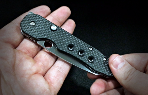

I've been looking forward to the Sliverax since it was announced; a Spyderco-made compression lock flipper is really appealing to me. Since it's been in the wild, one of the complaints about the Sliverax -- one of its shortcomings -- seems to be manipulating the compression lock. When you actuate the lock with your finger in the "natural" position, your finger blocks the blade from closing properly. You have to push the lock bar further towards the rear of the knife which, aside from being a bit "unnatural," also requires a bit more force to actuate.
A button-actuated compression lock solves both of these issues. It "forces" the finger into the optimal position and provides more leverage for the push.
I own two button-actuated compression lock knives. The first is the old Solo SO-05 that was sold by Spyderco. This implementation of the design is, imho, pretty flawed. The second is the Smock Knives SK-23 (a flipper, by the way). The way Kevin Smock did the button-actuated compression lock is really both simple and effective. I would love to see Spyderco do one like this.
I don't have my knife with me at the moment for pics but you can see the lock design at 2:02 in this video.

I can't imagine that it would be too difficult (as a design exercise) to take a left-hand PM2 (for instance), mill the liners & scales a bit differently, add the plunge button, and - voila - button actuated compression lock! You're still pinching the mechanism, but it requires less hand movement to close. No need to collaborate with anyone; the compression lock is Spyderco's design.
Could be fantastic...
Exactly. The way Smock did it couldn't be easier. It's an extra hole in the knife plus a button that attaches directly to the liner with one screw.

I also have the Smock and think it is the best implementation of the compression lock by a long shot. I’d love to see in in Spyderco‘s lineup.

The compression lock is so good already I wonder if people don't realize it could be better. One other advantage of making it button actuated is that it is flawlessly ambidextrous.
I was just looking at a lefty PM2 in a store today and thinking with a left side scale from a righty PM2 and a thumbstud off a cheap beater knife, one would be but a couple holes away from making it a reality.
