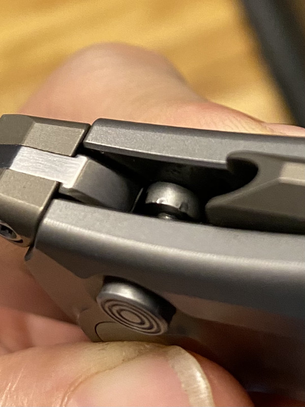

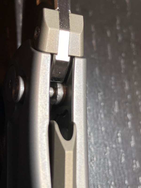

I have this sumo for a couple days now. I’ve noticed there’s a lot of wear on the corner of the barrel of the button lock presumably from open or closing when the tang of the blade hits it. But Jake claims it was hardened stainless steel but how come it gets so much dings? Will that prematurely fail?
is this something i should be worrying about?
I have a Mordax that doesn’t shows any wear on the outside of the barrel of the button lock whatsoever.
I have sent an inquiry to Jake Hoback and have yet to receive an answer back from him.
The button isn’t stationary, it will get more nicks and ding as it rotates from time to time when pressing on it.

looks like manufacturing defect, the reason i say this is the lock does not travel beyond the back of the blade otherwise the loch would not disengage, second, the wear marks are not consistent, and third the button retracts with a spring and it is not strong enough to retract it that hard, just my observation/opinion, have a good day and thanks for listening

That is a shame to hear. I hope it is not a defect. Currently trying to be in contact with my dealer and Jake to see what do they think of it.
I’ve noticed this on a few of my button lock knives and it’s usually caused by a small burr on the back of the tang, where it contacts the lock.

I've talked with a fellow member @Weasipoint and it seems his has those markings as well not as pronounced like mine does but definitely there. Perhaps, that is the nature of button locks. But my Mordax doesn't have any though. Yes there is a small burr that is created and it affect the action a bit.

That definitely doesn't look right, there shouldn't be that many dings on a button lock, it's only a matter of time before that fails. The burr on the radius of the tang sounds like an issue, and the button may be softer than it should be.

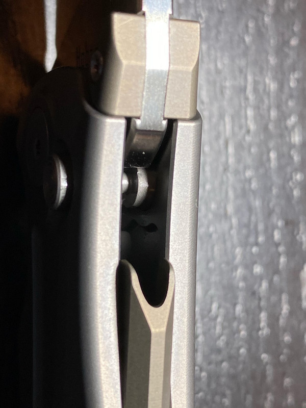

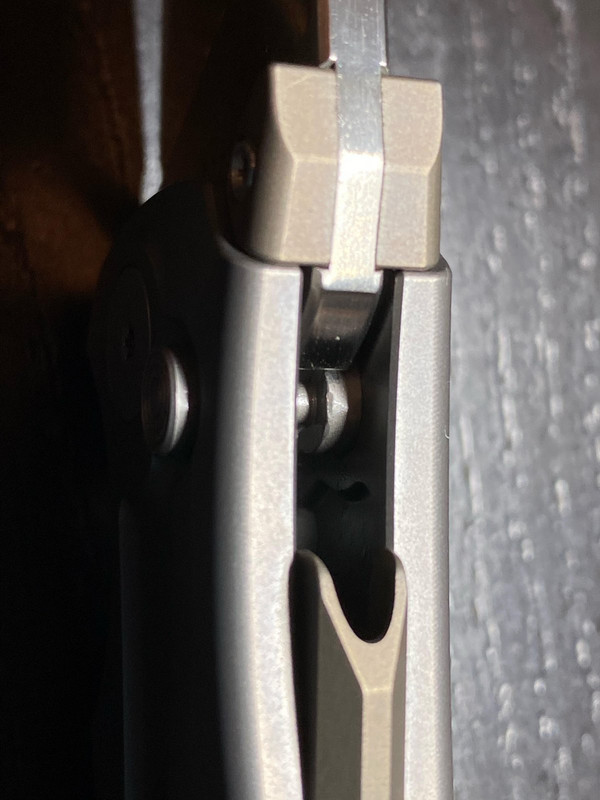

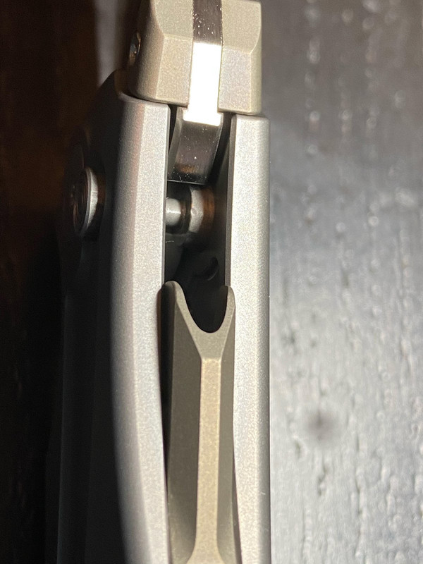

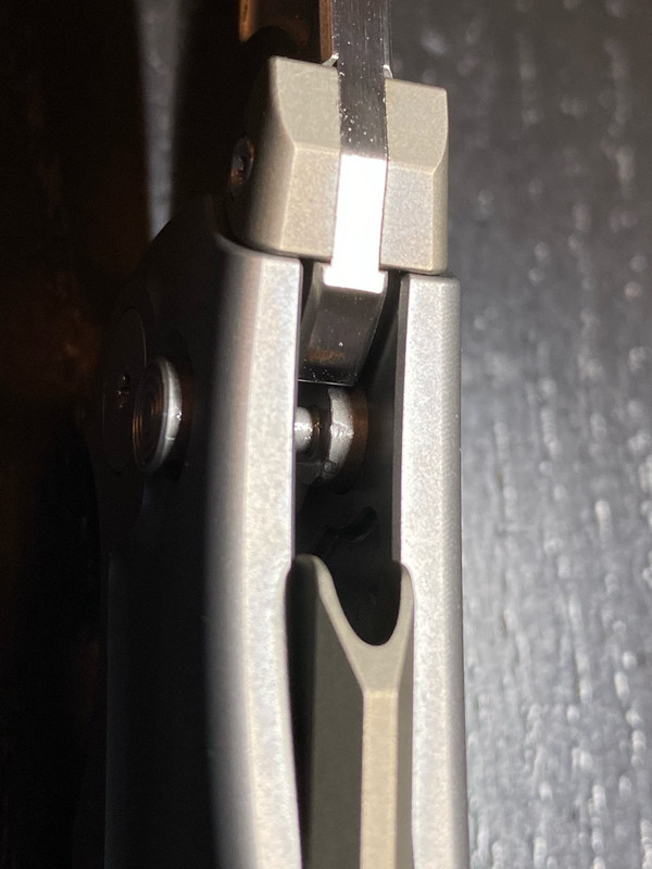

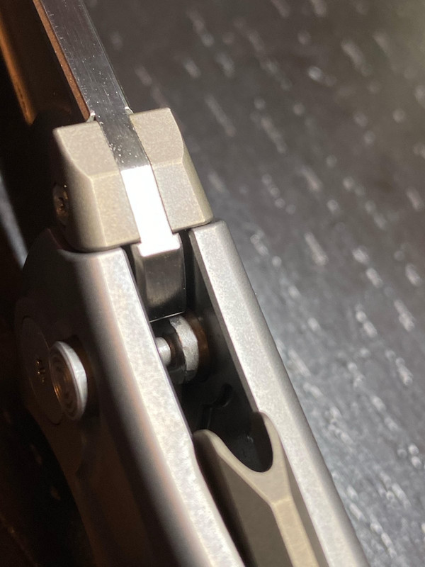

Here is some more clearer pics. My dealer replied:

Wow, that's not good. It almost looks like the button lock is titanium or unhardened steel...
Wish it was Ti as it would be much more stronger than stainless steel. I believe it is 17-4 PH SS. Jake claims its hardened stainless steel but i dont feel its is hardened at all.
Strength alone isn't what you need for those locking pieces, though. You need hardness and wear resistance in a material that won't gall. Titanium is stronger than most stainless grades (tensile/compressive strength) but will not stand up as well to the specific loading cases encountered by the locking pieces. Hardened stainless steel would be far superior to 6Al-4V in this instance; the problem seems to be that the steel simply is not heat treated correctly or at all.
Yes you’re probably right. In my mind, i was thinking about those titanium frame locks which has always been okay around. Though, they all are carburized to protect them from galling. If i would want this button to be Ti, it needs to be carburized as well but i dont think the button would work that well as the carburized surface is way to rough for it to slide through the hole. Also, my guess is this button is unhardened as well.

No so far it is still rock solid. But it hinders the action a tiny bit due to some burrs unless i press the button deeply so button wouldn't contacts the tang.

I had such issue with my Kershaw Launch. Similar marks were all over the button, the lock wasn't working properly, I could unlock the blade by hitting my knee with the spine, at least in some positions of the button.
The button was replaced by customer service. Since then I havn't had any problems, there was some issue with the material or the heat treat, probably.
I wouldn't call those marks "wear" (metal rubbing against metal), I'd call them impact or strike marks (metal hitting metal).
It looks to me like the blade is hitting the lock and causing indentations. My guess would be that the lock isn't properly hardened.
