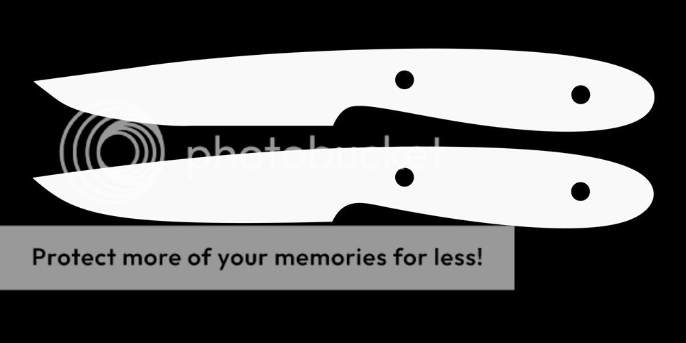

Excellent ideas! :thumbup: I truly envy you folks who can generate drawings like the one you posted. Gorgeous knife!! I did a trace of it and if you are interested in seeing how close my method converts over into your CAD program shoot me an email & I'll send it to you. Took about three minutes to do.
I have your file. It came in with no problems.
This image is a profile of the trace juxtaposed with the original.
The bottom image seems to be a more fluid profile. The top image is more angular and doesn't flow as nicely around the belly of the blade and the spine around the tip isn't as clean a curve as the bottom image. There's a slight difference in the guard areas as well.
Knowing what little I know about autotrace programs, I wager the bottom image is the original.
It's pretty close though. I think it would be a way to get close to what you want and then tweak the vectors to get a final draft.

You are correct. I'm especially impressed you saw the difference in the choil.
At no point was I debating Larry's ability to trace something (though to my eye, the trace is not quite there yet, though that could be a translation error in his export settings), my point was this: People need to be very careful how they incorporate CAD in their knife build process because creating in CAD can be a cumbersome and unnatural environment and frequently leads to awkward designs because the CAD tool drives the design.

In EZ Cad's defense, I think the profile discrepancies are insignificant if we assume that the blank would be cut via WJ. (Because a WJ blank needs a little clean-up).
On the other hand, Nathan machines his blanks, so his application is a bit more demanding.
EZ Cad - I opened your dxf files (thanks for the email), and they did seem clean and problem-free for the circa-1995 Flow waterjet software that I use. 3 minutes is certainly fast.
Nathan/clw3/Patrick,
I am thrilled that they came out as close as they did! I had no way to verify it except how Nathan suggested (short of actually cutting them out). Thanks for the input! As to the EXPORTing causing the discrepancies I doubt that. Please keep in mind ... I really whipped those out. What I EXPORTed WAS IN FACT what I drew up. A person could do a much more "fluid" file by taking a little extra time and ZOOMing in on the nodes to verify how they "flow" prior to EXPORTing. I'm really excited to know that this process will work to be able to generate files that can be cut out as multiple blanks. Thanks again for your input. :thumbup::thumbup::thumbup:
