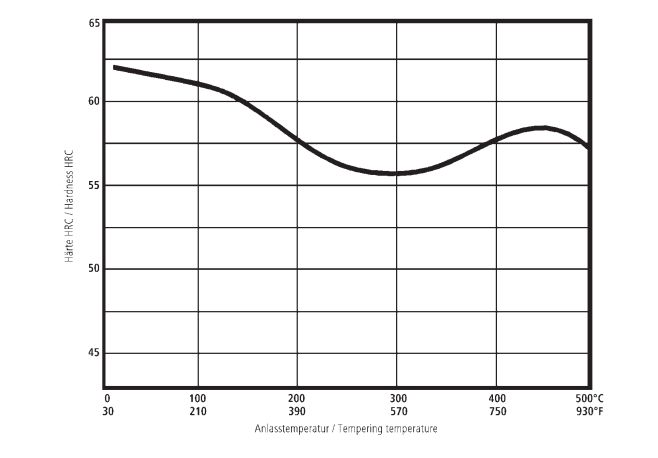

What's the point of the 175F tempers on N690 and 8670 in your chart? It seems a little low but maybe I just don't understand.
Mike
I’ve made a few. Kitchen knives in 8670 tempered that low, and they work great. The N690 was based on the chart from aks. Other steels were tested at Rc61/62, so I was aiming for the same range for the N690.

I believe that for the N690 the 175° are not farenight but rather degrees centigrade. In this way I find myself perfectly with the times that I usually use and with which I reach hardness of 60HRc.

You have to log in to see the heat treat info, but this chart shows Fahrenheit.
https://www.alphaknifesupply.com/shop/n690-stainless-steel That might be a mistake though.
I see. I'm going to guess that the AKS supplied heat treat for 8670 and N690 are industry standard rather than customized to max hardness, as I know 8670 can hit much higher numbers than shown with a hardening temperature of 1525F rather than the shown 1600F. Also, I had in my head that tempering below 300F did not do much. I guess the toughness testing will answer that question, though!

Warren is this the curve of which you write?
There's also this graph in the CTS XHP datasheets showing that tempering at 200F hits a local maximum toughness point.

I think it's worth looking into these really low tempering temperatures to get the best performance for knives. Even getting 1-2 extra hardness points out of stainless steels help.
