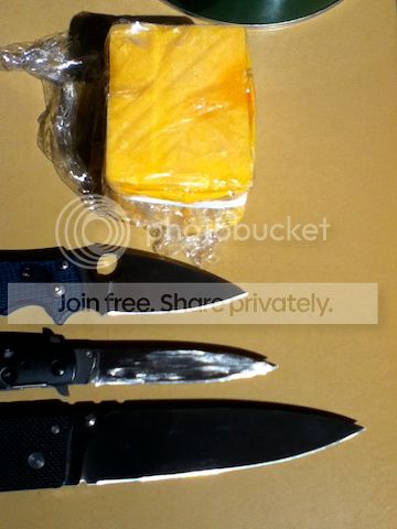

Any way . . . how you gonna slice blocks of cheese and bread with that little sucker ? ? ? ?
Go bigger I say
Sorry the photo came out so weird / blades foreshortened / the blades are not black but they look it here.
