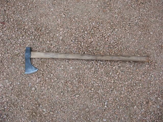

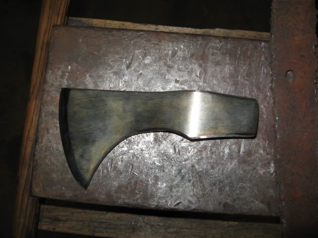

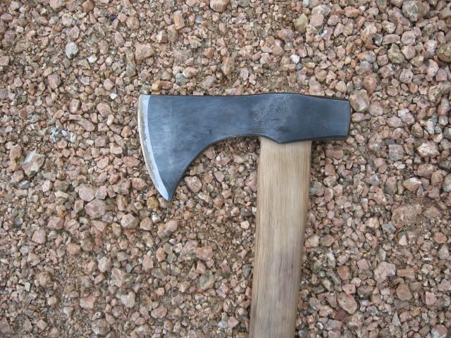

I completed this last night. It's for myself to help clear brush, but it's a good camp ax size. It's forged from heavy duty pickup axle, cleaned up by grinding, and heat treated. The handle is kind of hastily done, shaped down from a cruiser ax handle.
I'm still going to play some with the grind of the bevel.
I think it has darn sexy lines. Must be the sideburns on it. :) Had two folks already order one for themselves just from seeing it in my shop. Gotta get busy!

Hi Storm Crow, great work. Can you tell us more, size of the head, the bit length, the weight, poll size etc. Did you forge it by hand or use a power hammer.
Best regards
Robin
Thanks, guys!

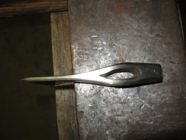

Robin - The eye was punched with my homebrewed hydraulic press and the rest was forged on my homebrewed power hammer. I'll try to get more dimensions.
I like the lines. It looks like it will do what you ask of it. Look forward to the details Pipeman asked about.
I was not able to get a scale to measure it today, but the other dimensions are:
From end of the poll to the cutting edge is 6 9/16". From top of poll to bottom of poll is approximately 1 3/8" at the eye, and 1 1/4" at the face of the poll. Width of the poll is 3/4". Distance from top of ax to bottom of sideburns is 1 1/2". Distance from top of ax to bottom of beard is 3 3/8". All corners are bevelled slightly and the face of the poll is gently crowned.
It's quite light. I got the grind adjusted on the bevel, and it cuts pretty darn well now. :)
