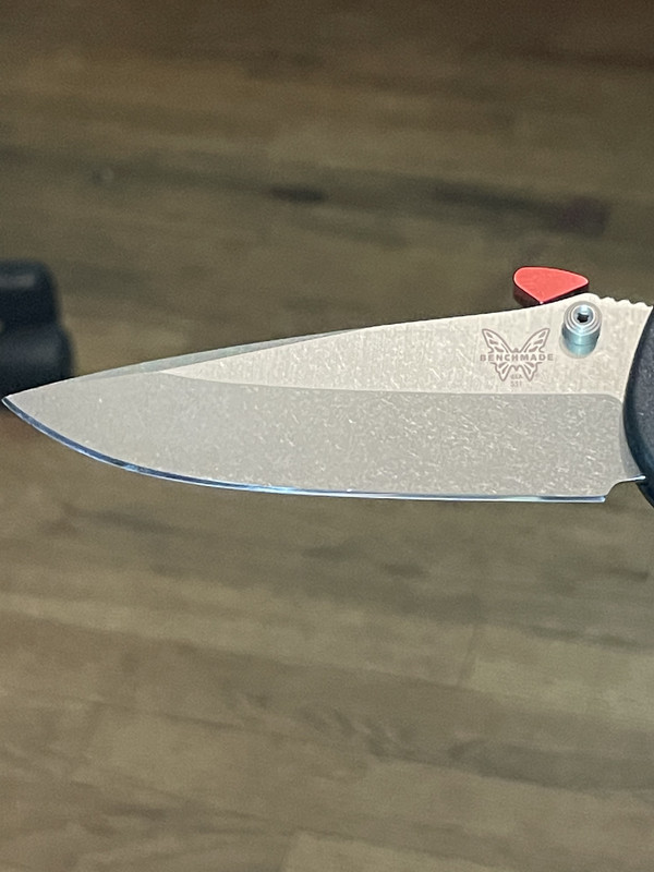

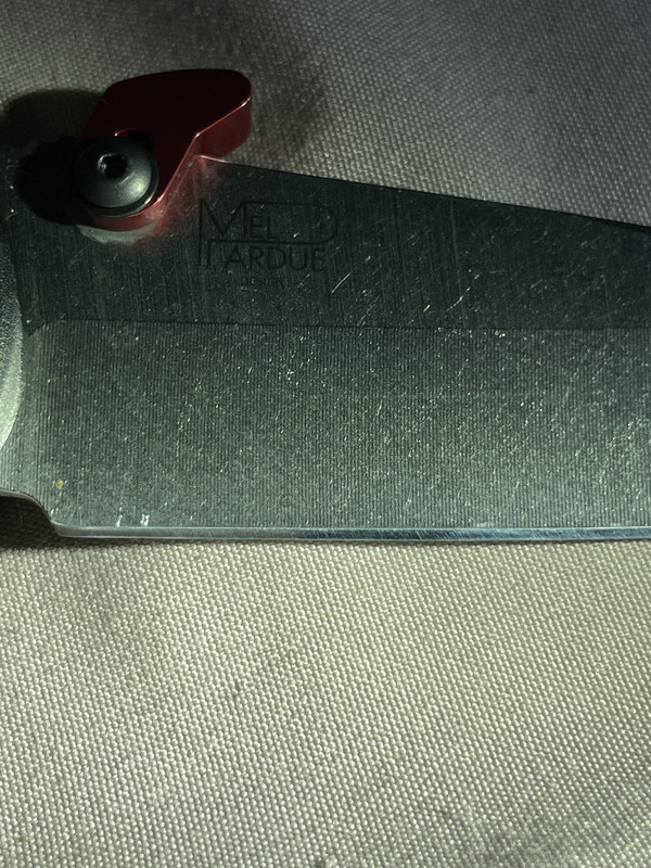

CAN’T GET A DANG MIRROR EDGE!
Are there any other tips or solutions. Maybe spend a more time on it?
You could try and spend more time on it I suppose. Are you cleaning the blade and the stones before each try? It is possible that there are small contaminates falling off of the lower grit diamond and then being ground into the edge with the 600 grit. Its curious that the deepest scratches are coming from the 600 and not the 320. If thats not a problem either spending more time on it OR getting another stone that would stand in for it. It would require significant investment on your part to get the gritomatic stone holder for the system and getting new stones in different grit ranges. Depends on how important that mirror polish is to you.
After a week of testing the x method I believe the scratches are coming from the 600 grit
I can easily believe that. That's the reason why I don´t use diamond plates for sharpening anymore. However, I use diamond plates all the time to flatten my whetstones. Maybe you could replace that diamond plate with a suitable coarse ceramic stone and see what happens.
btw when i buy a new production knife, typically the edge is super sharp (I'm always impressed because tbh oftentimes I can't reach factory sharpness thru my freehanding skills lol) while the bevel has a rough-looking finish, with visible grind lines. also think of Stanley utility blades, for example: their bevel finish looks like 350grit wth??
when it's time to resharpen the new knife after a few weeks of mild use, the lowest i go is 204M. or sometimes i doht even go lower than 204F. one can grind with these ceramic stones! either dry or with oil.
these stones grind away those exfac grind lines (which are deeper than your pictured scratches!) and leave a scratch-free finish. after 204UF, the bevel looks mirror polished. no scratches.
basically i am saying... if i want scratch-free mirror polish, my method is: never use anything lower than 204M (that's around 2500grit?).
what you can do: go back to the finish as seen on your photos. then grind with 204M to get to the bottom of the scratches. then grind with 204F. then 204UF. the finish should be free of scratches by now and mirror-ish enough.
the rest is optional (paper, compound, strop)

I find that the hardness of steel is a big factor here. Visible scratches appear so easily on soft steel. A laminated Mora blade is a good example. The soft outer layers get more scrathes than the harder steel in the middle. I really like to polish super hard Roselli UHC-steel. I don’t get any unwanted scratches on that UHC-steel. That cheap knife in the video most likely is really soft.

I do realize that the scratches aren’t consistent if that makes sense. Sometimes it’s from the 1000 and sometimes from the 2000 I think you guys are right about the metal particles but I don’t know what it could be from I wipe the blade consistently but still get scratches. If you guys would like to see my latest work just ask
Do you wipe the stone down consistently, this may help. I always like to see other peoples sharpening results.
