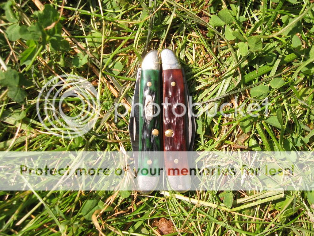

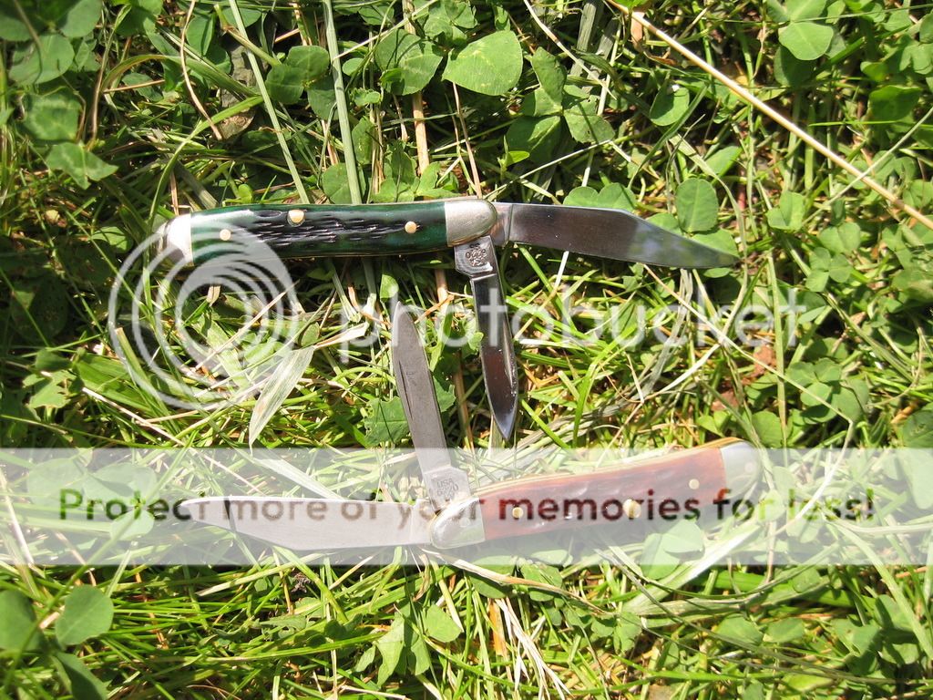

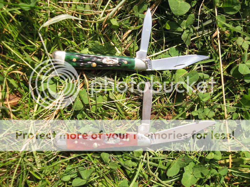

Some pics. Notice how the SS bermuda green bone, being a pocket worn version, is more rounded, and therefore a bit smaller than the regular peanut.
