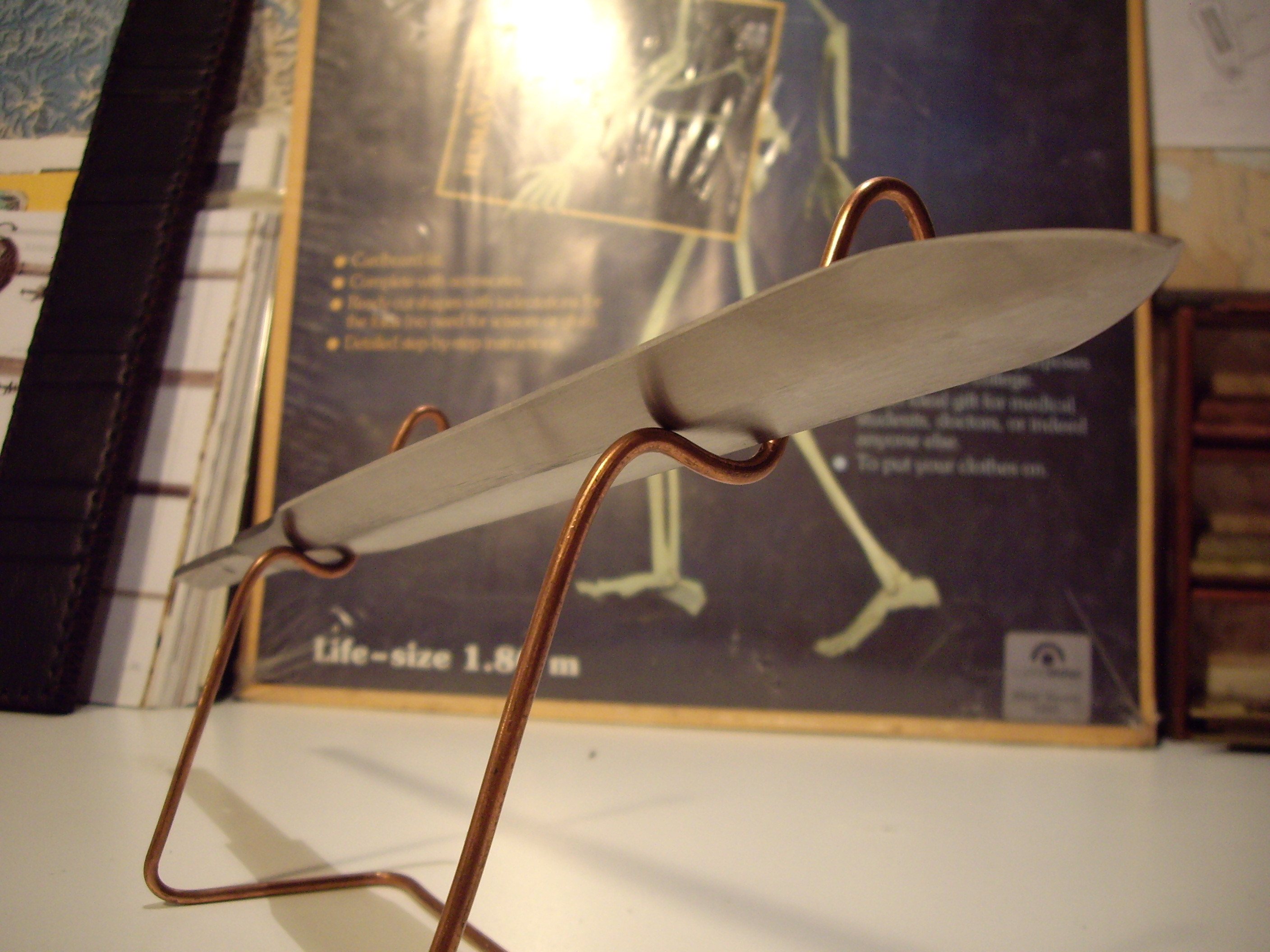

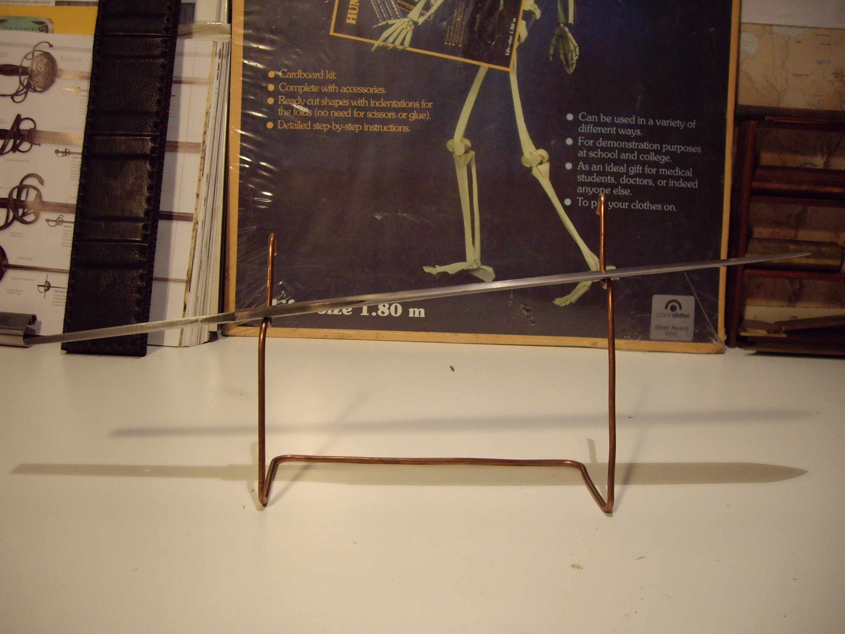

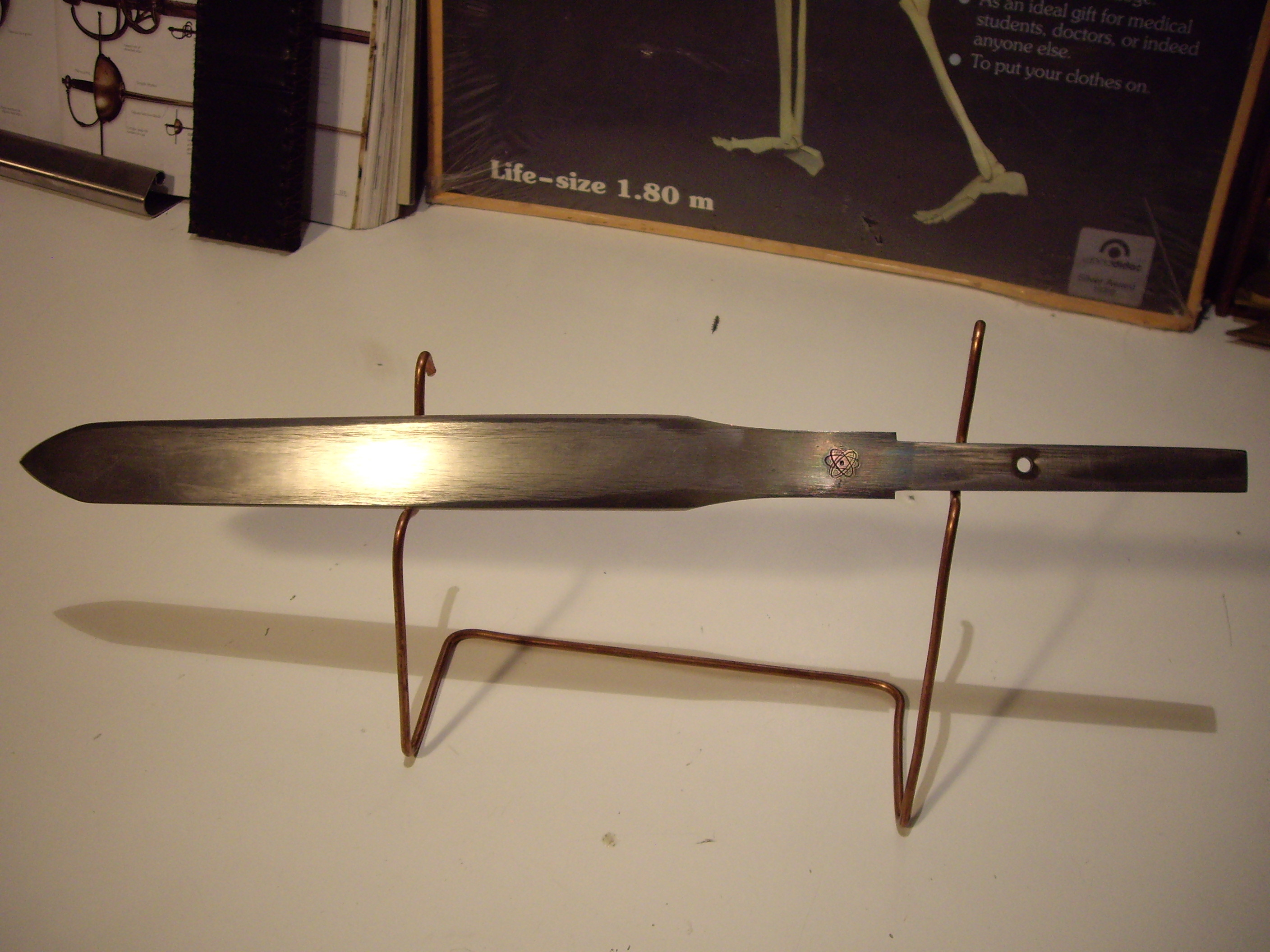

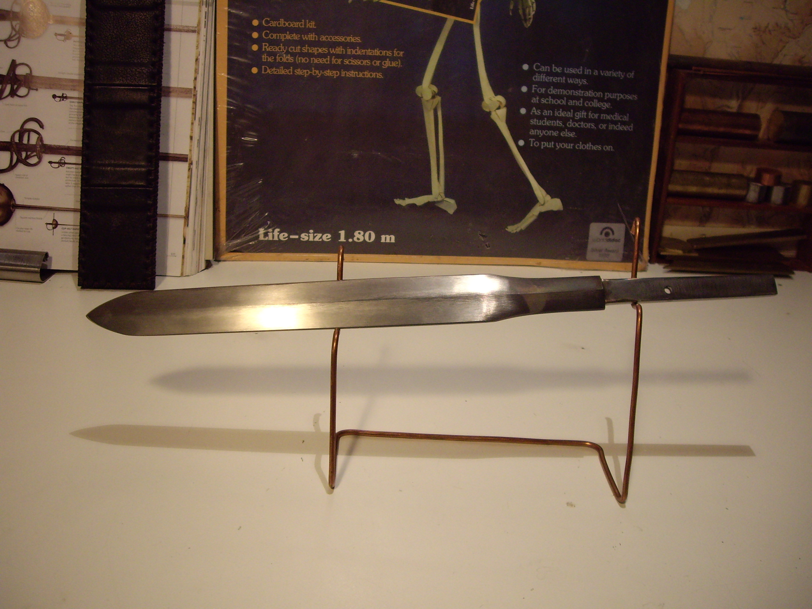

Here is the spear head, for those who wanted to see. It started as a diamond-section, but I decided to grind one side flat, as it seems many Japanese yari were triangular. At some point I started to just ugly it up, so just let it be after the off-center tang hole! :D
Weight is 8.4 oz. Almost 19" in total length, the blade is 13.75" to the tang. It is slightly flexible.

Many Japanese yari were tempered to produce a hamon. Might want to give
that a try. The shape is good. Nice work.

Rich S., I did a few limited experiments at first with using clay during heat treatment for two titanium blades, but there seemed to be no benefit. The best results so far have come from an aggressive through-hardening in a super fast water-based medium, which is how most beta titanium is quenched from precipitation temperatures (I use ice water). There is still hope for incorporating something like that, I think it would have to be a very high "hamon," like as high as a very high grind, with the clay just along the spine and spilling maybe 1/4" down toward the edge, but I'm afraid it would be mostly just for looks. It gets even harder when tempered, instead of softening, something I need to explore further! :eek:
Which brings me to the other possibility for a hamon-like blade effect. During tempering, a clay coating would probably leave a visible line after the heat soak, but I don't want to add a "fake" hamon to a blade that doesn't represent an actual shift in the grain structure of the metal.
I don't think etching will bring out a hamon, since titanium alloys are basically inert to acids. If I can find a good way to beneficially add it to the grain structure, it will have to be polished into visibility. There probably is a way: a hamon between BCC and a blade edge shot through with martensitic alpha prime maybe; the challenge would be to make it visible.

Why is there a need for a distal taper if it's going to be on a pole ??
Would you electro-etch the blade ?
Will anodize pick up different colors as crystal structure ?
