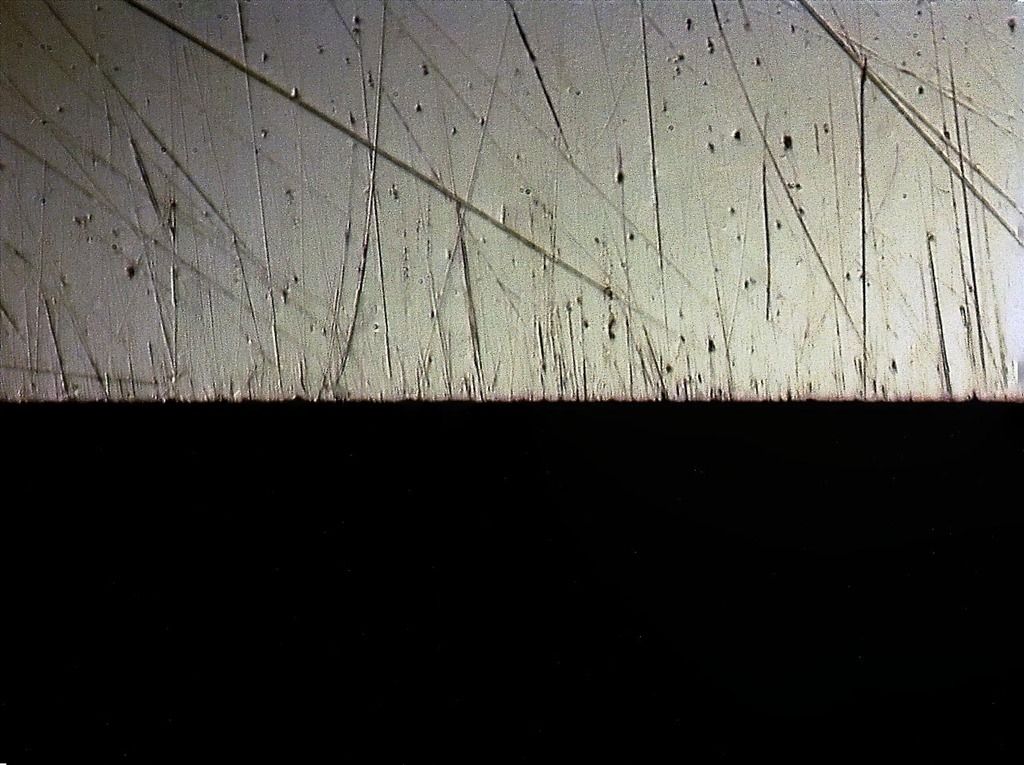

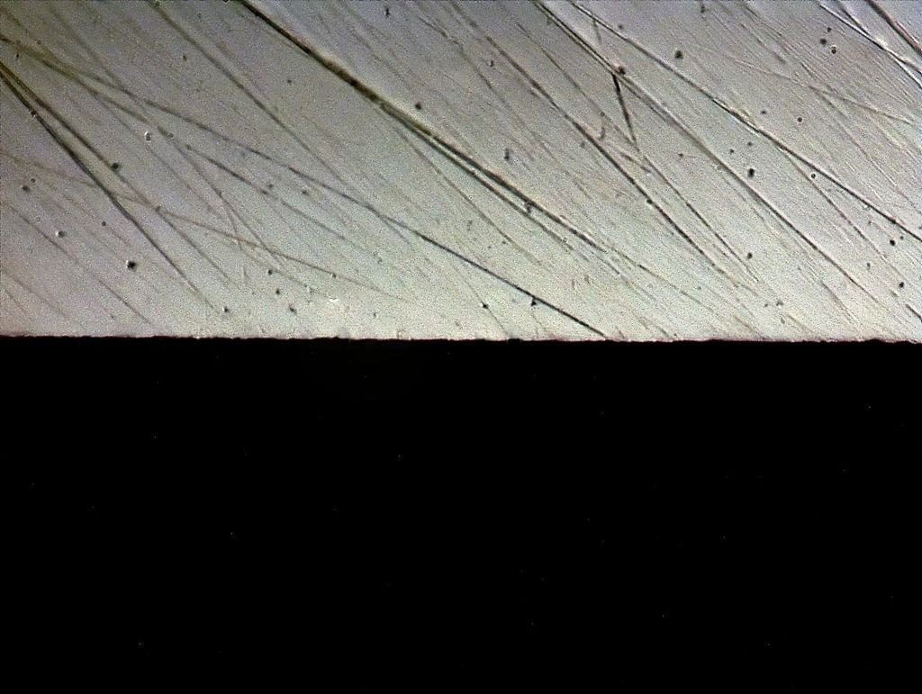

Clearly shows the blown/partially excavated carbides. These are not Vanadium PM steels, but HSS. Still, it clearly demonstrates the possibility if not certainty on some steels of carbide displacement. If anything this would make one want to use diamond abrasive any time the carbide content is significant - I know it changed my thinking considerably.
The DMT EEF is the only fixed abrasive that really did a clean job to the apex, and still some carbides clearly got popped.
HSS with exposed carbides, abrasive used was a Suehiro 20k water stone (Aluminum Oxide abrasive).
Suehiro%20Gokumyo%2020k%20following%20Ozuku%20Asagi%20Raking%20Light.jpg~original

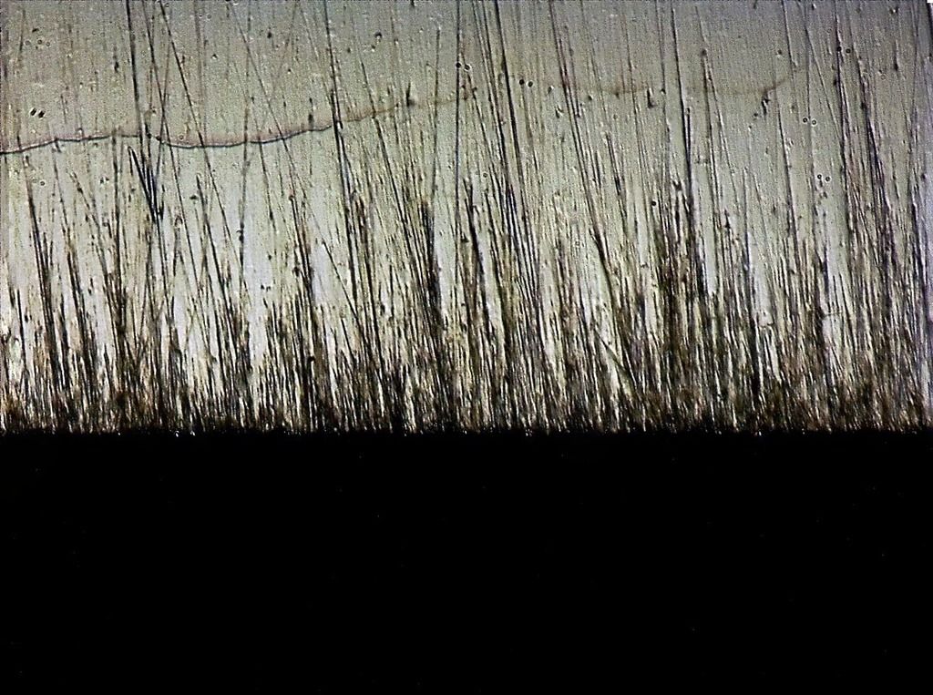

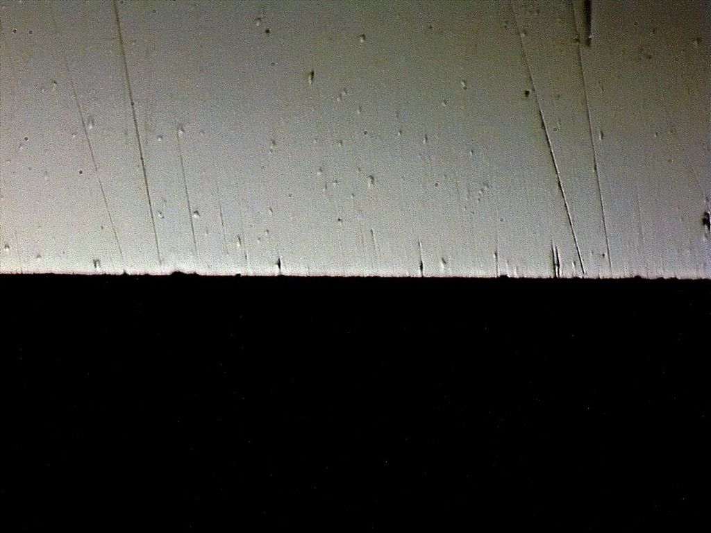

DMT C (325)
DMT%20325%20Raking%20Light.jpg~original

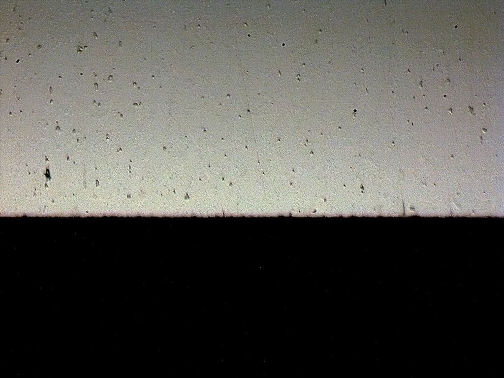

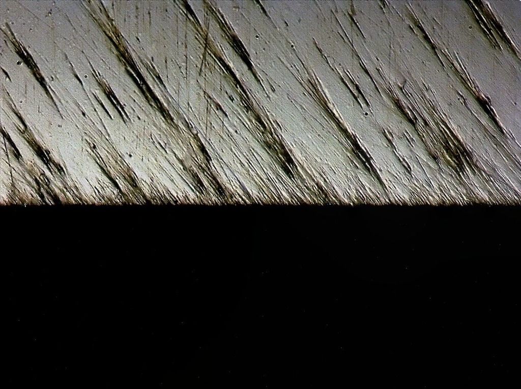

Next, Shapton Pro 1k:
Shapton%201k%20Pro%20Raking%20Light.jpg~original

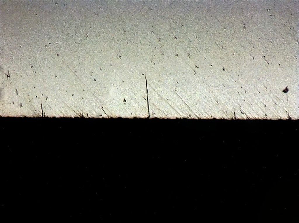

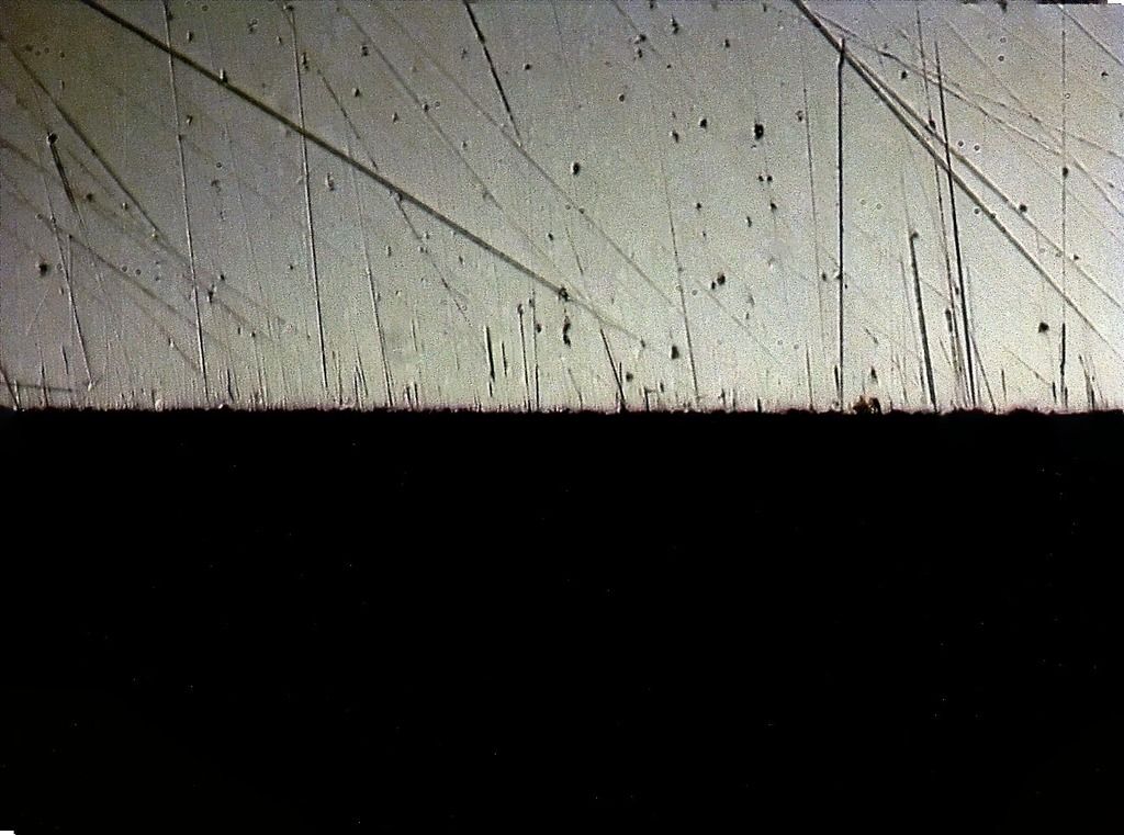

Shapton Pro 2k:
Shapton%202k%20Pro%20Raking%20Light.jpg~original

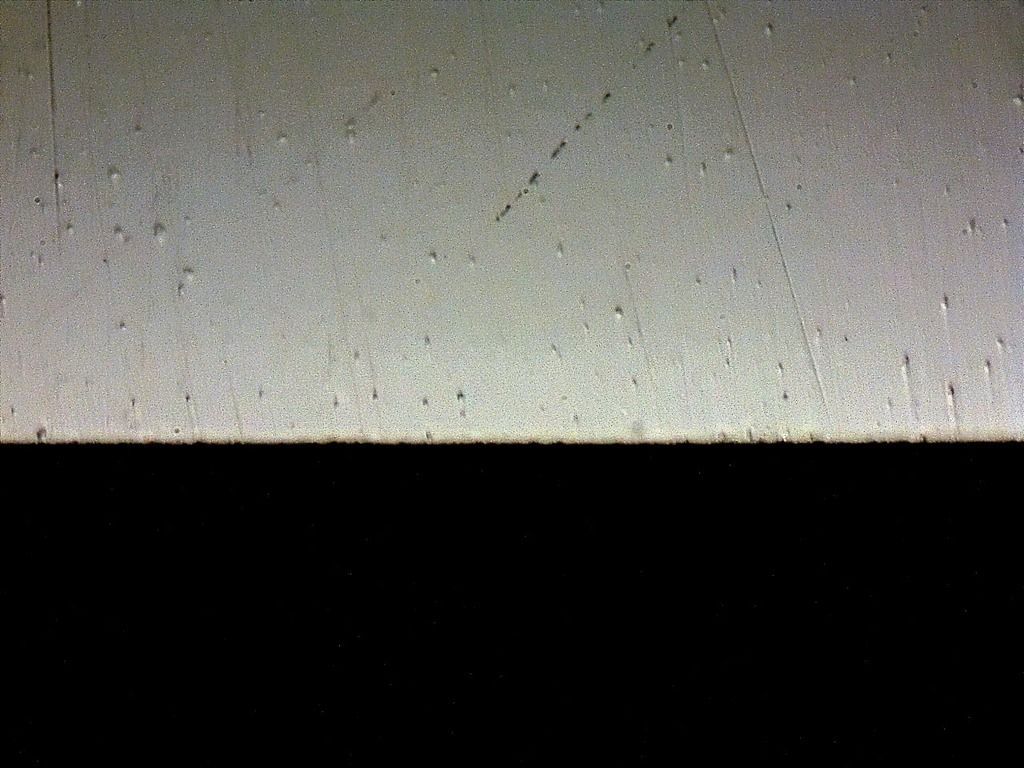

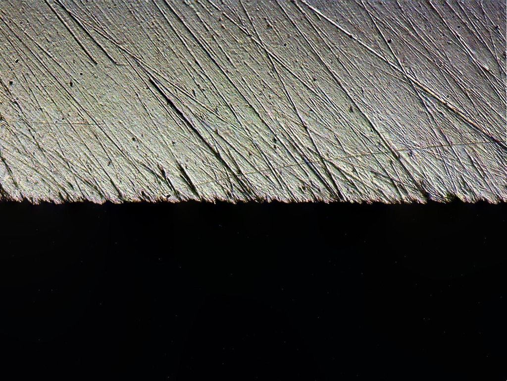

Suehiro Rika 5k:
Suehiro%20Rika%205k%20Raking%20Light.jpg~original

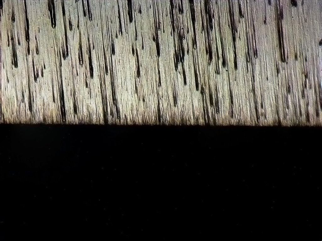

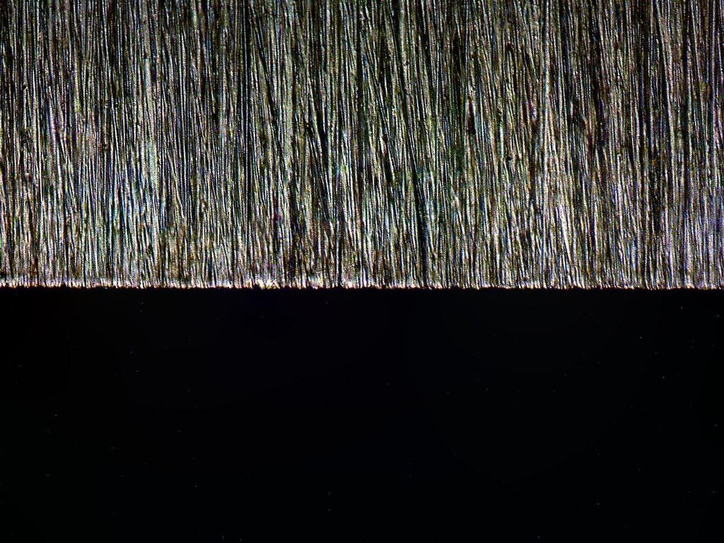

Shapton Pro 8k:
Shapton%208k%20Pro%20Raking%20Light.jpg~original

You do not see the empty depressions and even more critical, all the track marks from excavated carbides? You might claim on some of the stones that they are from the abrasive (despite they appear to have a uniformity of size across a range of abrasive media), but not possible with the Spyderco UF, which appears to have fared the worse of the bunch.
The ones off the Shapton 8k look like a meteor shower.
Admittedly the strop will do a more gentle job, erasing the holes just as soon as the carbides are gone and not grinding them into the surrounding to leave telltale tracks. Clearly, if the carbides wind up proud of the surrounding, at some point they fall out and leave a void that will immediately be subject to the strop erosion.
Even on your image there appear obvious remnants on the lower right side slope, a little below dead center on the apex is a void along the ridge line, just above and to the left of that is a dual depression. If it were a picture of a hillside I think we'd all agree some rocks fell out.

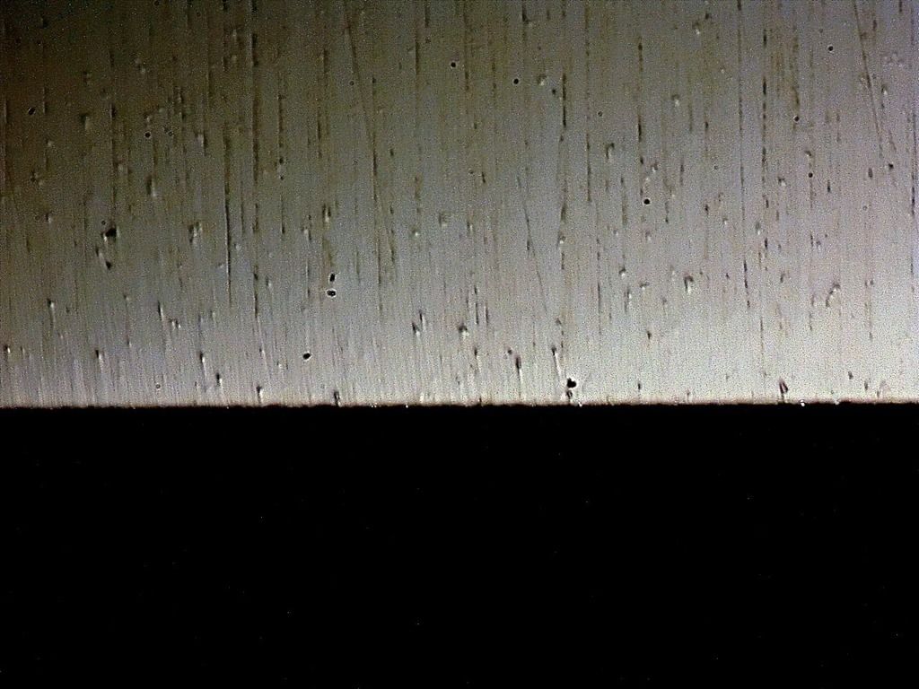

Here is one of my own pics of s30v after being stropped with conventional abrasives. You can see depressions that are not related to any of the visible scratchmarks, they are the expected approximate size of the carbides. Lower right the lighting allows one to see carbides standing proud of the surrounding.
s30v_1000_3_Cal_zps8ed01af1.jpg~original
Honestly Todd, I don't expect to change your mind on this topic, but am putting it out there for general consideration. My own cut testing and anecdotal use has shown a positive change even on non-Vanadium carbide rich steel - using SIC over AlumOx yields somewhat better retention at comparable abrasive size, and using diamond improves that yet again.
