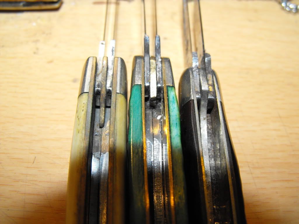

Maybe this will help (and maybe not :o)
The top knife is a Parker Doc's Whittling Knife with parallel, untapered springs. The middle knife is a Hen and Rooster whittler with tapered springs. Both of these have a cut liner, i.e. there is a liner between the blades but not between the springs. The bottom knife is a Case splitback whittler where the liner extends between the springs.

Thanks for the photo of the parallel same thickness springs, but I still don't understand the cut liner. I think I see a catch bit on the top knife ? And I think I see a catch bit on the tapered spring knife ? I understand the tapered scale on the bottom knife in the pic between the springs, I think ? The top whittler knife in the pic isn't very common and kind of a cheap way of building a knife and I had completely forgotten about it's application, it's my Ole age.:o I think there are more whittler spring arrangements than the 3 pictured. I'll fore go any further information on whittlers, and let the experts explain further. As I stated Hell I'm confused.:o
Wow, I guess this wasn't a stupid question! All I know is I'm sure learning something, thank you for the pics & info.
I think by "cut liner", he means it's there to separate the blades, but it's "cut" at the bottom, so it's doesn't separate the springs, is that correct?
The tip of the middle liner is just visible on the top knife, it only sticks out about a sixteenth of an inch. The part that sticks out also wraps around the end of the springs, which is what I believe is the "catch bit" referred to above.

Yablanowitz...those images really helped point out the difference between the different spring configs. You can now see how a catch bit simply is a spacer only between the small blades and a cut liner seperates both the springs and the blades. Master blade's in the center...center liner's in the center..."cut liner" refers to the fact that there has to be a cutout in the center liner for the master blade to fit into the trough.
