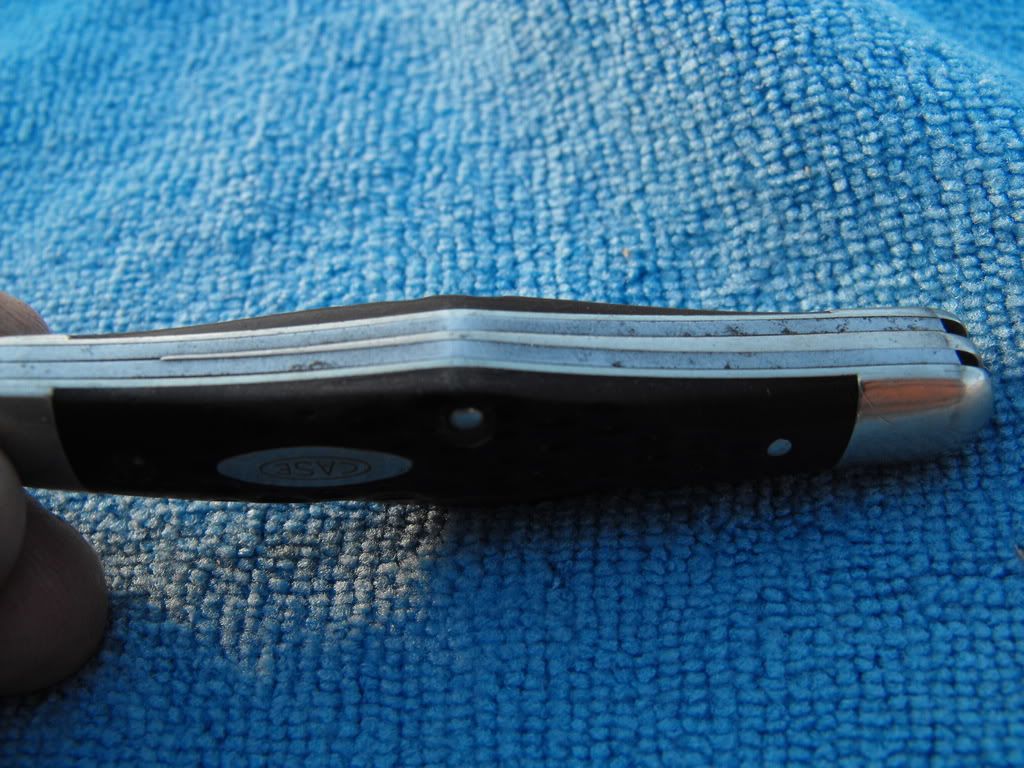

The Hen and Rooster catch bit. you can see how the end of the bit hooks around the springs. I've never noticed it moving, though.

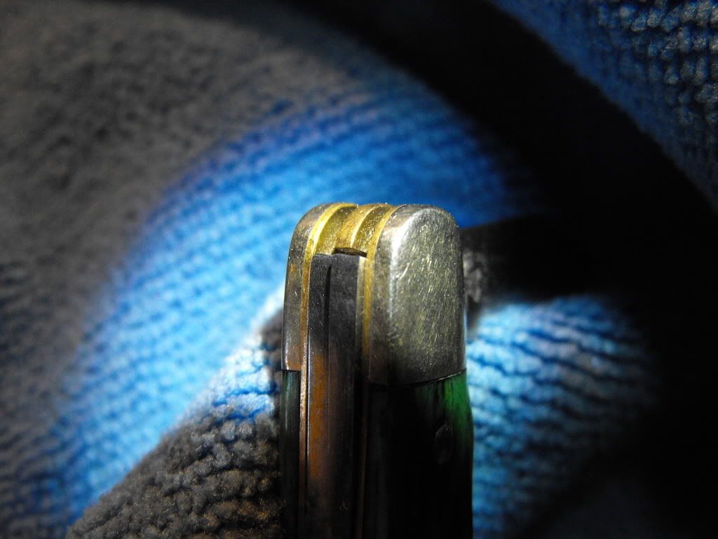

The tapered center liner or cut liner, is held at two points, the pivot of the two small blades and the cener pin. If the liner works its way up to where it could cut your palm, it has already broken.

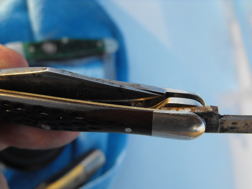

Here you can see why the center liner has to be cut. Note the shadow of the blade on the liner.
