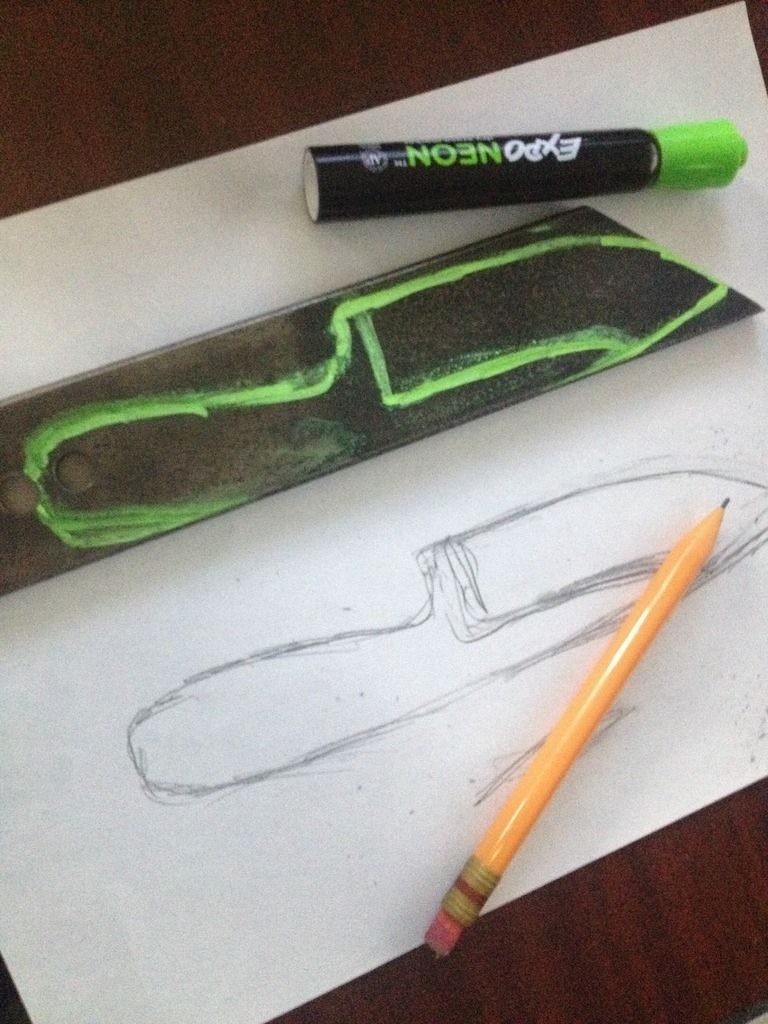

Meanwhile i'm making my first knife to see if i even like making them "pretty sure i will". Here's what i got done so far.

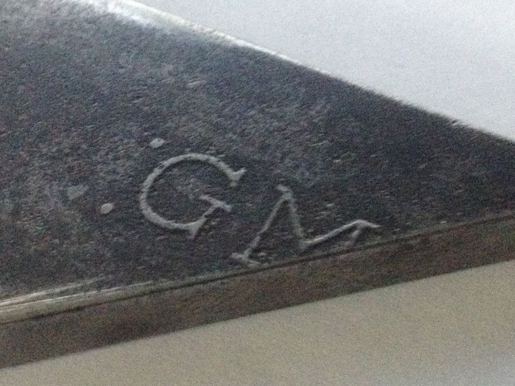

I found a piece of leaf spring scrap and cleaned it up a little. It's a little over 1/4" thick, and it appears it came off a General Motors car so hopefully it's decent steel. Then put my design on it. I didn't really base this design off anything and now looking at it and feeling it, it seems the handle might be to small but we'll see.

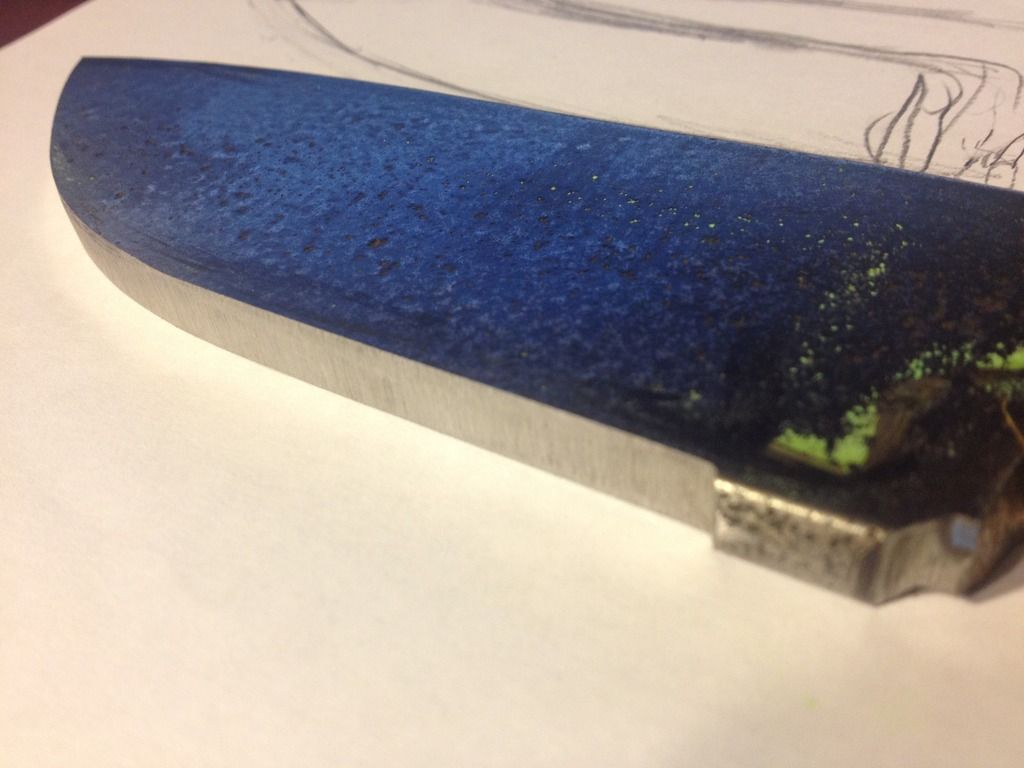

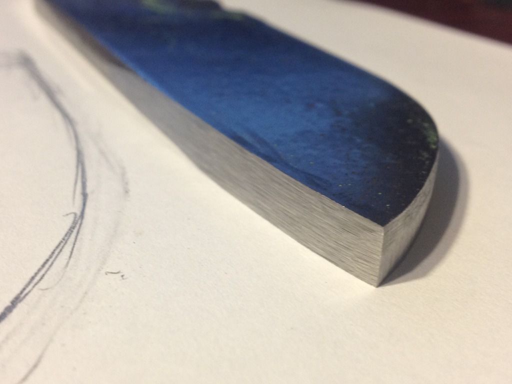

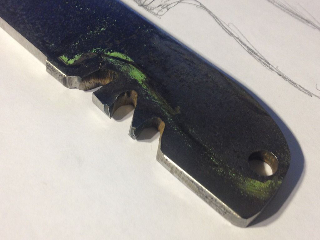

Then i started to profile it, i love the way it came out. I'm just having some trouble cutting my general shape out as you can see on the handle, what tool do you guys use?

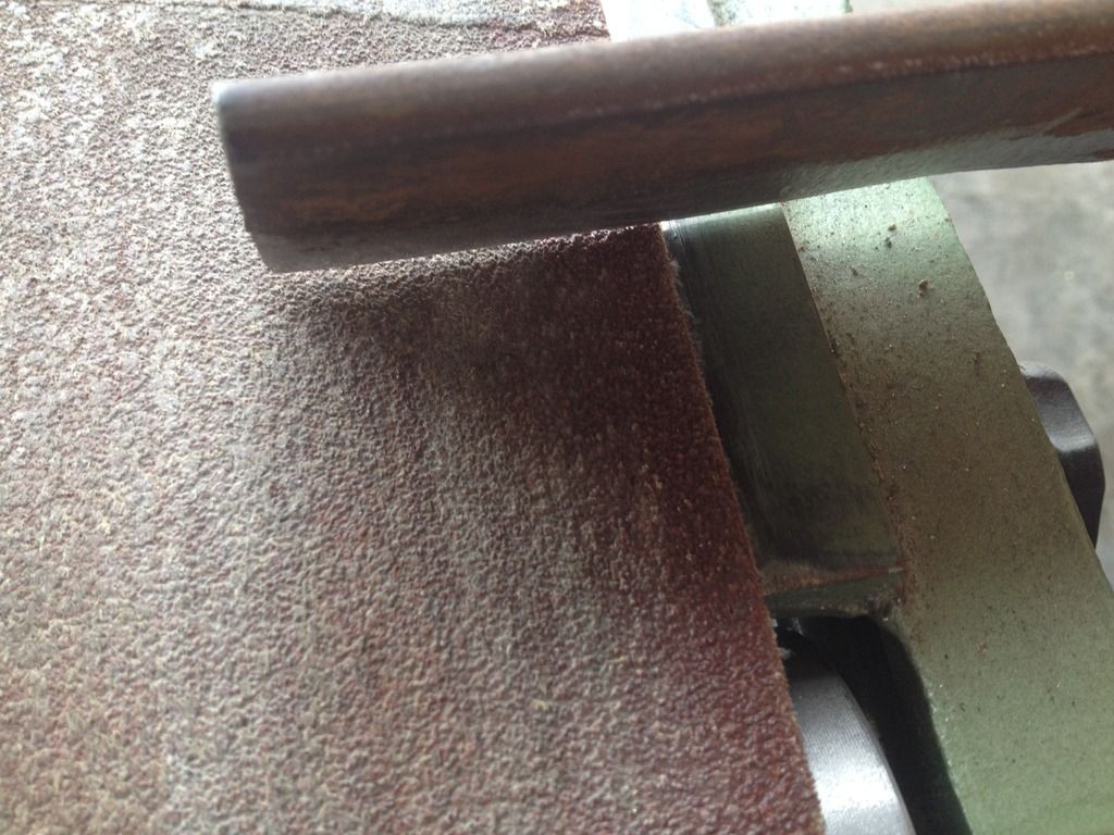

Also unfortunately my sander isn't capable of beveling the knife so i'll need to get a new one before i finish. I did a test piece on another piece of steel and it looked liked the machete from the most recent Rambo film.

It's just poorly designed for blade making.
See those steps on either side, that makes it near imposible to make bevels.
I started grinding knives over 20 years ago and the first knife I ground was on a standard handheld wood sander. I clamped it upside down in a vice and tracked the belt over to one side and started grinding. My knives have come along way sence then. It's funny how your mind plays tricks on you. I remember thoes knives being awesome, but then I found some pictures and wow. But like I tell everyone that gets into this "you have to start somewhere".
Can you track the belt left or right to bring the edge of the belt to the edge of the platten?
