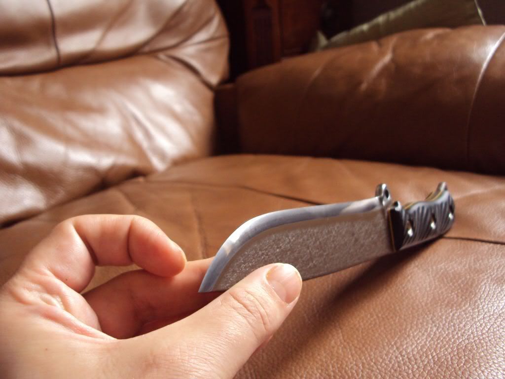

I love my BJ...but it did come with a rather obtuse edge and I agree that the blade profile itself is very thick, especially behind the edge. I thinned out the edge considerably...I mean big time (took it up about .25 inch) with a 1" belt sander and strop... It now has a thin convex blended grind. It is ridiculously stupid sharp now...I love it!

I understand thinning the edge, been there, done that. But ...up about 0.25"...?!?! That can't be right.
It's perfect for my intended purpose for this knife...when I say .25" I mean that the powder coat was removed and polished up that much from the convexed edge. It's still plenty thick behind the edge...and sturdy enough to make kindling and any other general utility task no problem. Cutting flesh, rope, strapping, etc...brilliantly. I'm not one of those guys that intentionally abuses busse knives or wants to use every one of my knives as a chopper or for batoning (which for some silly reason has become the new standard by which every knife is judged). It seems that I'm constantly reading threads where folks expect a single knife to excel at processing lumber, demo work, skinning game, and food preparation...I can only shake my head at this. If I wanted it for chopping down trees, lumber with nails, and other Hard tasks then I would definitely put more angle on the convex...which is what I do for my larger bladed knives.
Here's a pic...it might look thinner than it is...photos can be deceiving.
AH, now I see, literally. 0.25" up on the bevel, makes perfect sense. Looks great, too.

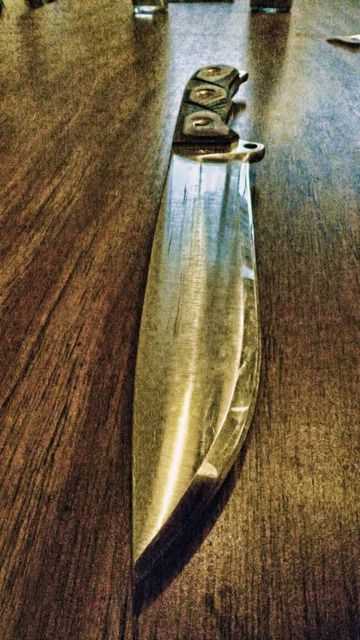

here is the relief grinds most everyone has done, then I took it to a full convex,( which should have come like that in the first place).... the blade performs far superior than what it came, and with the relief grinds, mine were done on a 2x72 220 grit-320-then SB belt. this one has been sold on the forum, and my other 2 are the same way now,
