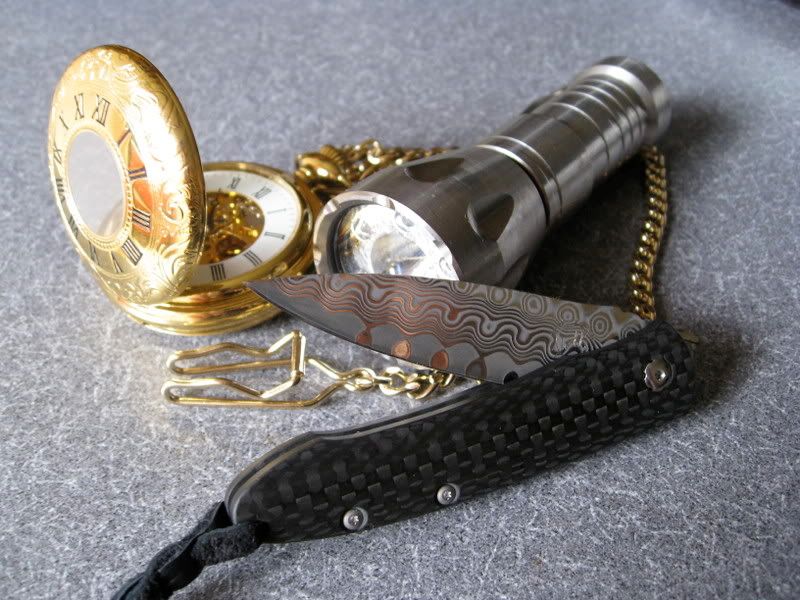

Carbon Fiber!!
^lol at internet police.
Baba did buck do the CF? That looks GREAT. I might just need another 110.
This thread needs MOAR SUPERHAWK
No Sir!!! SealsKnives.com Did both the CF 110's as well as several other Hot Redos for me. Dons a great guy!!! Thanks for the kind comments!!! ~baba~

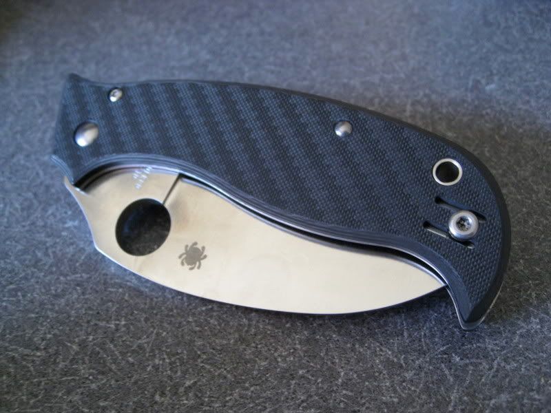

Carbon Fiber is now my preferred handle material on a folder. Here's why: Extremely tough.

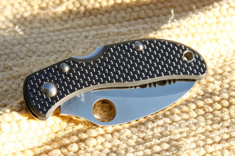

There is my humble contribution....a modified Mora a friend gave to me......however it is actually carbon fiber/kevlar weave.....:D
