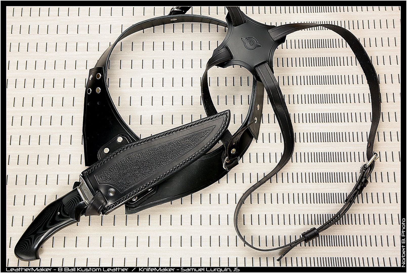

Joe, Thank you for that. I love the 8-Ball shoulder rig. It seems that either scout or sash is more versatile with sash being the most versatile. Would you agree with that?
Thanks Man With No Name, I had seen that video.

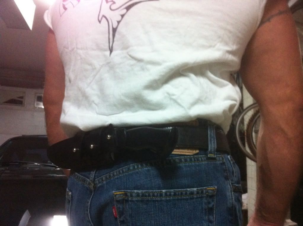

,any remember years ago I went as far as to carry a 9 1/2 inch Bagwell on trips around the world
in the bush open carry sash style cross draw is the ticket
than when wanting to conceal you could rotate it behind the hip and even IWB behind the hip only having to contend with hiding the handle
I was the biggest proponent and was having over sized studs made and the great Paul Long made me scores of stud sash sheaths
for a big blade over say 8 inches sash is how many carried blades fro centuries and can be very secure if you have enough blade length to make it secure meaning a lot or weight as in blade length through the belt
But for edc and normal life it’s hard to deal with

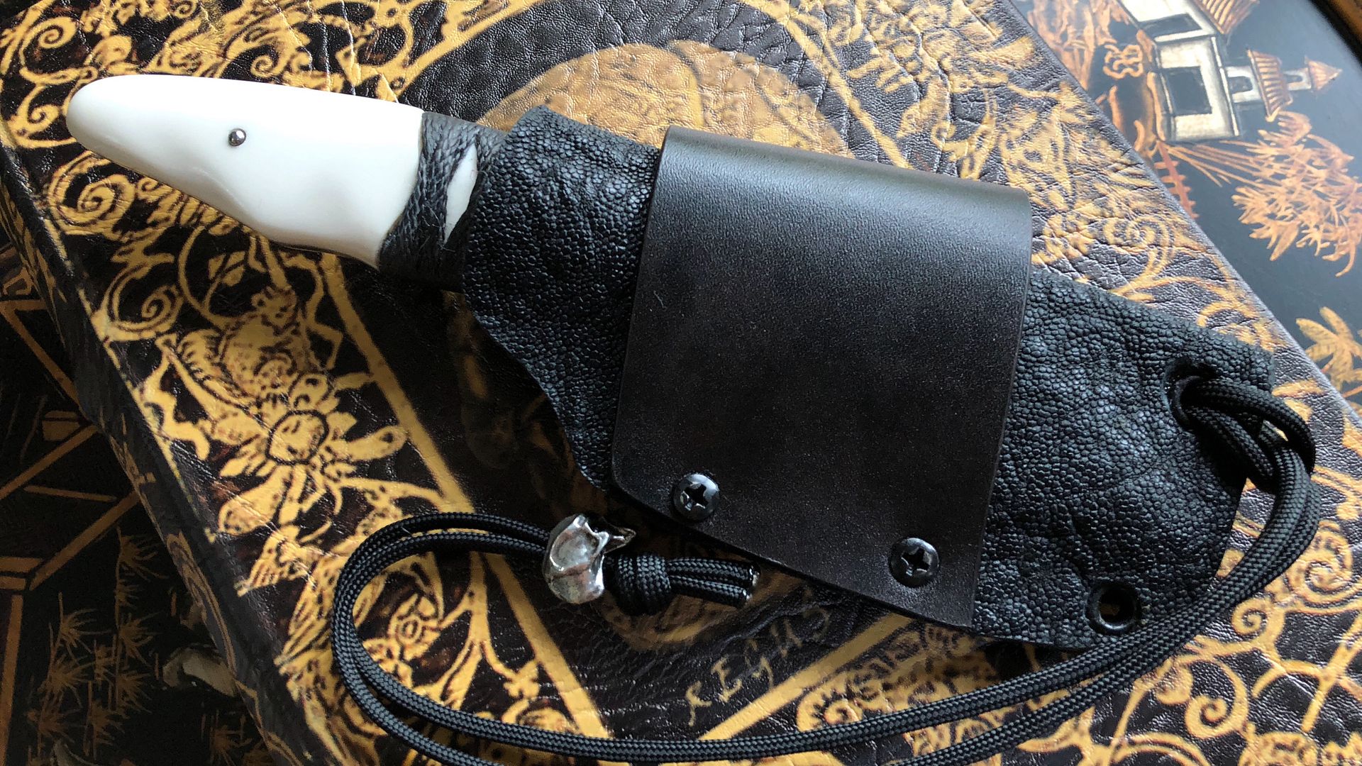

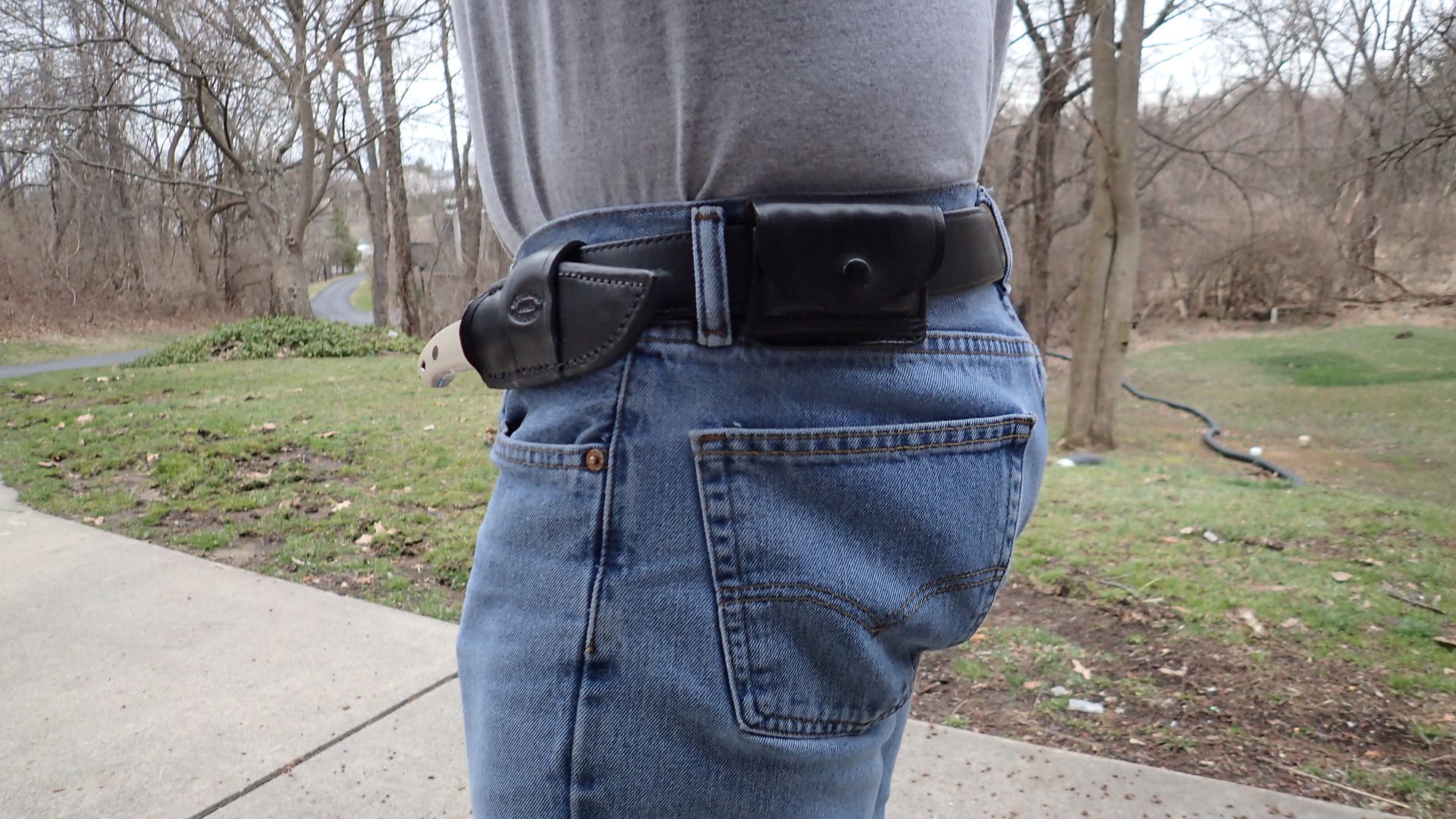

These are 3 to 4 inch blades carried in horizontal cross draw sheaths
see that problem with say carry with 5 or 6 inch blades is that you don’t have enough blade length to make it really secure
You can’t free float it and expect it to stay put if your really active
kwaikens fair better do to their flatness and friction fit sheaths that lend themselves to static lines

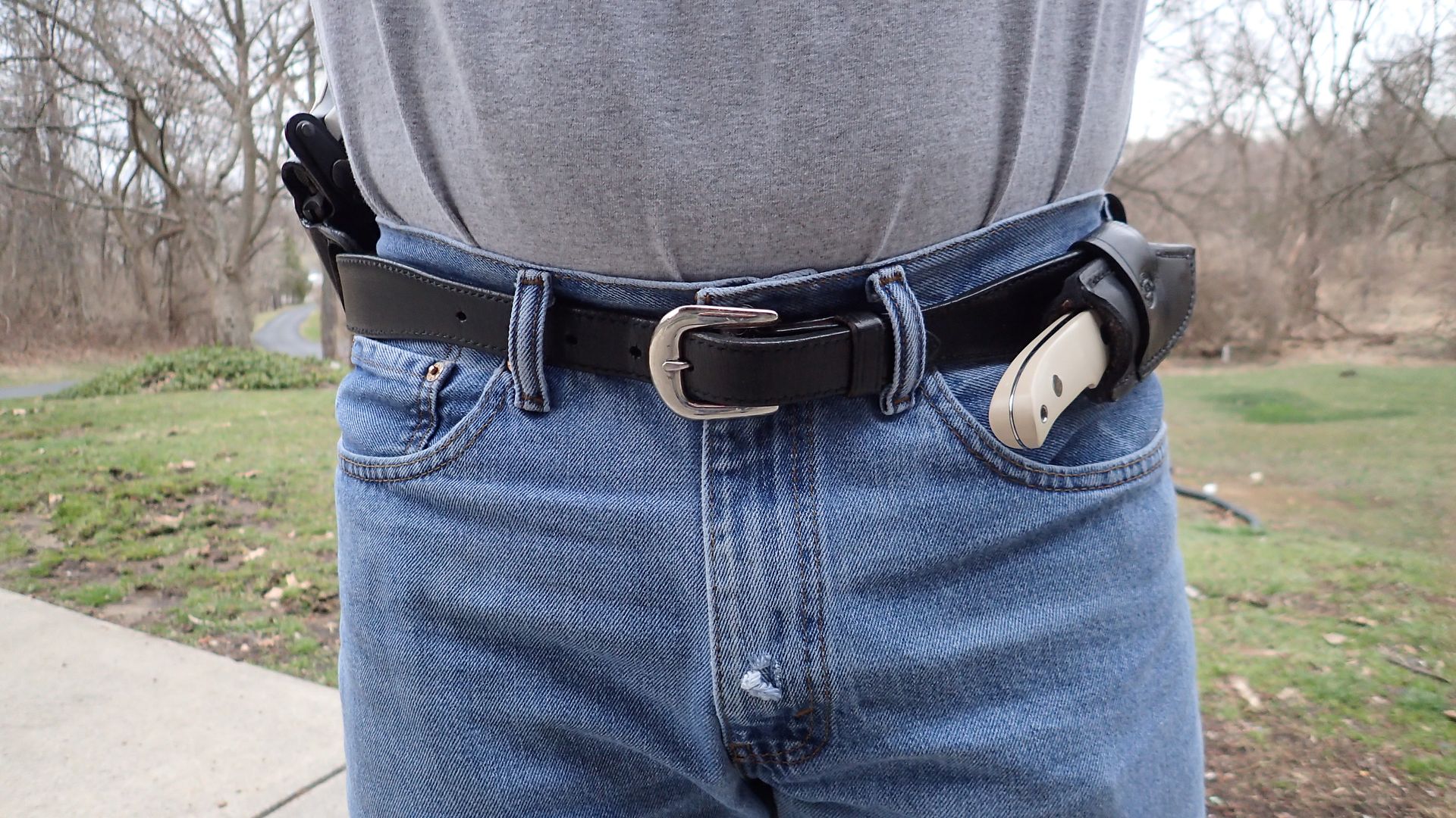

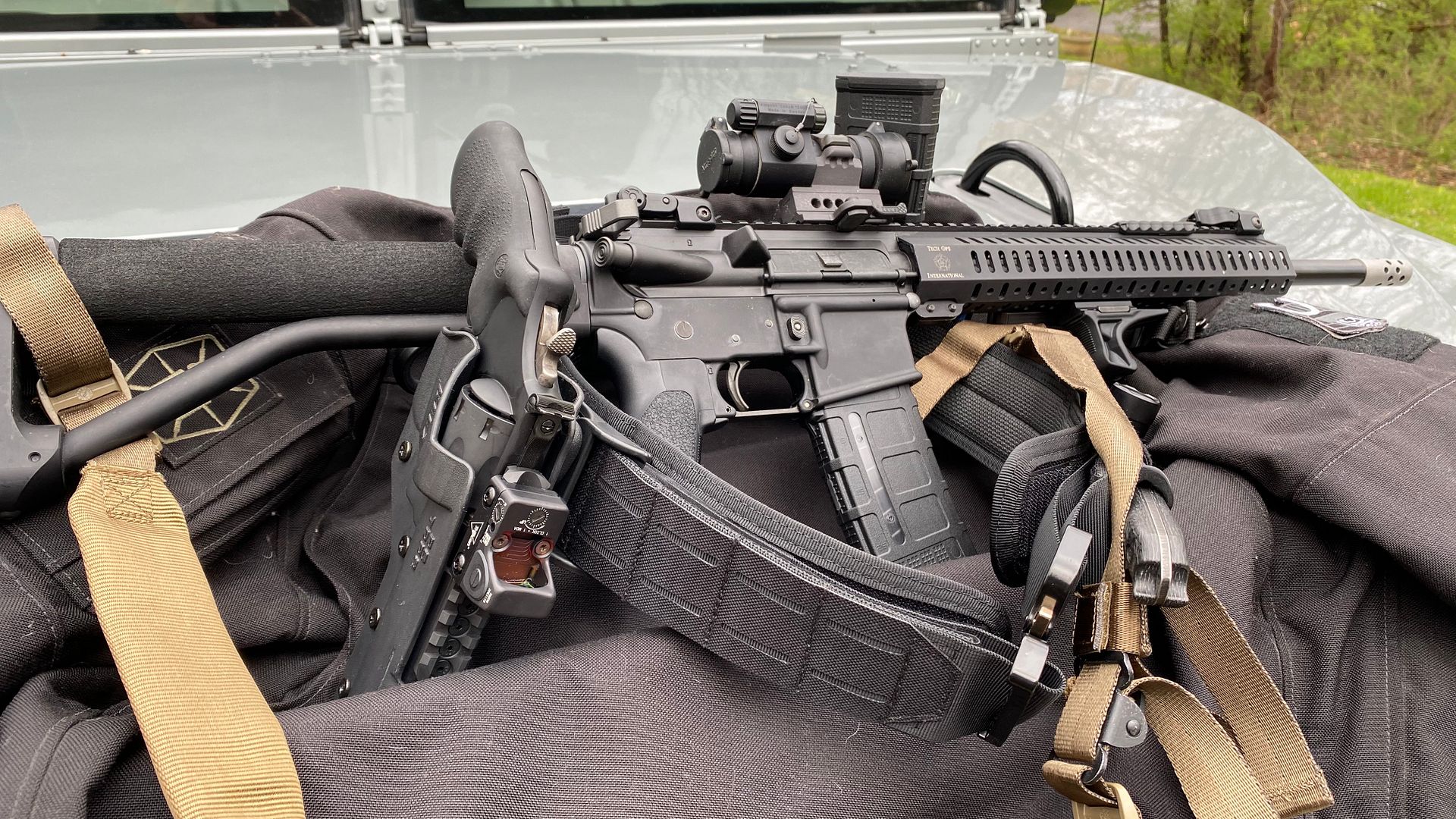

pictured above where you see the small loveless style NY special from TK is pretty much my everyday attire with a cover garment
even on say a full battle belt like this I’ve gone to a small blade worn horizontal crossdraw

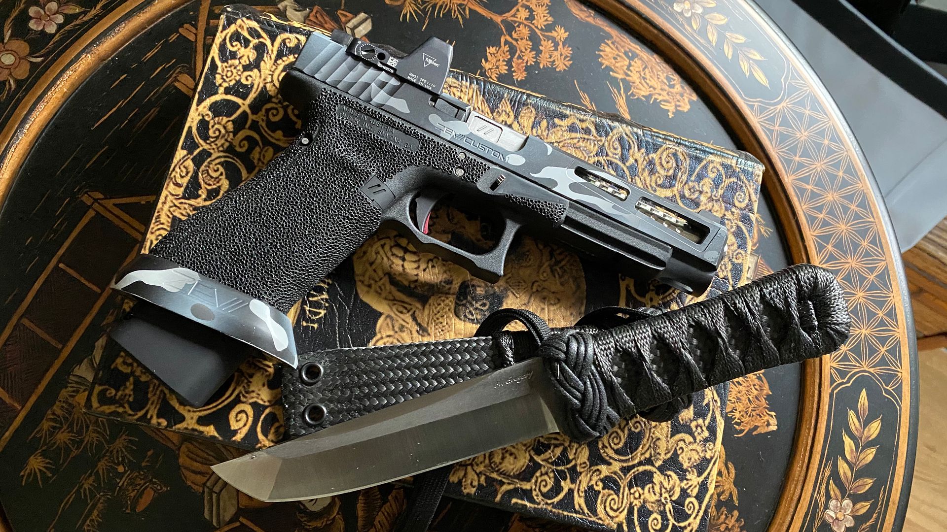

To be honest I don’t see the value in a 6 inch bladed knives these days especially as a protection knife or as you mention bodyguard role Most serious guys are carrying guns and smaller designs think Blood Shark size etc

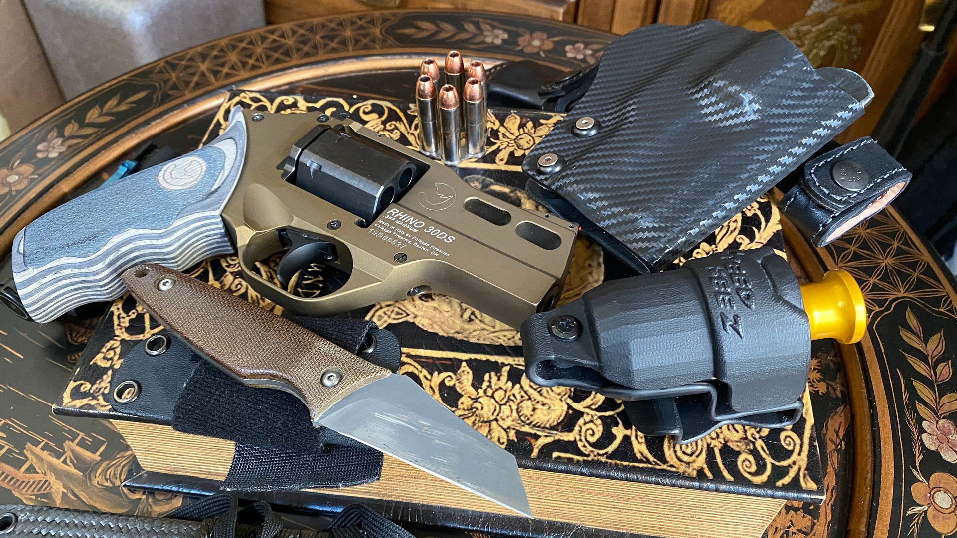

these are my primary carry knives these days
john Gray wharnie
Or a Yojimbo on a horizontal sheath

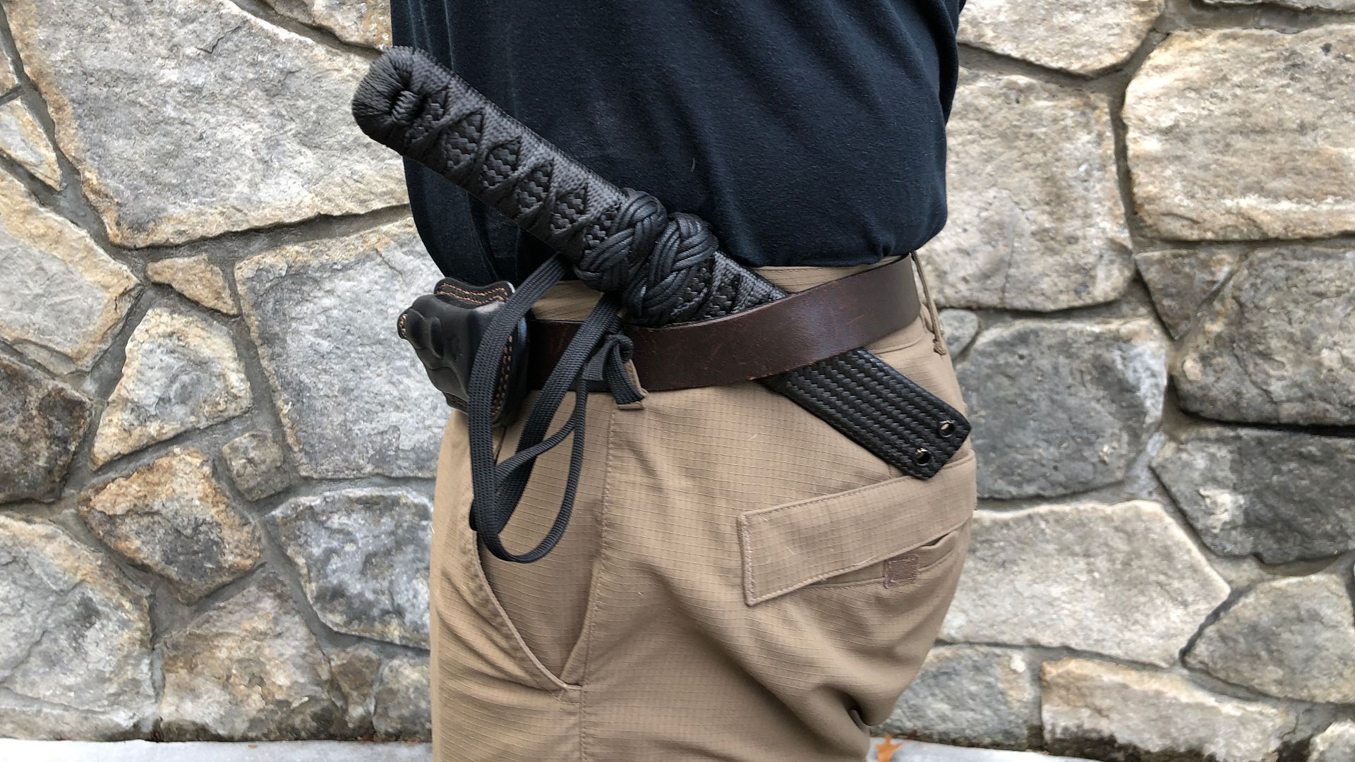

If I want to go with a bigger blade it’s usually a Kwaiken worn crossdraw sash style connected to a static line but it’s hard to conceal
no one notices the Small Wharnie worn horizontal crossdraw
the Kwaiken is noticeable

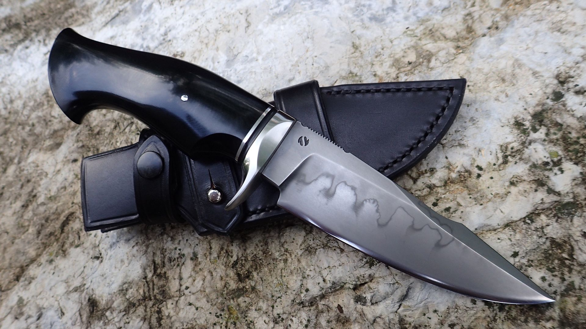

Thanks guys. This is the knife.
Thanks, Dave.
Does that knife have a guard?
Is that sheath just slid behind the belt? The belt doesn't go through the sheath, correct?
Lovely knife Marc. A real looker!!
One consideration, is if you do a sheath that allows horizontal carry, being easily able to remove without having to unthread or take belt off.
That knife is in the middle category.
I have made sheaths for my self, which were both horizontal and vertical (Hstrap on pouch style sheath. They likely would not work too well for that width of guard, or blade width.

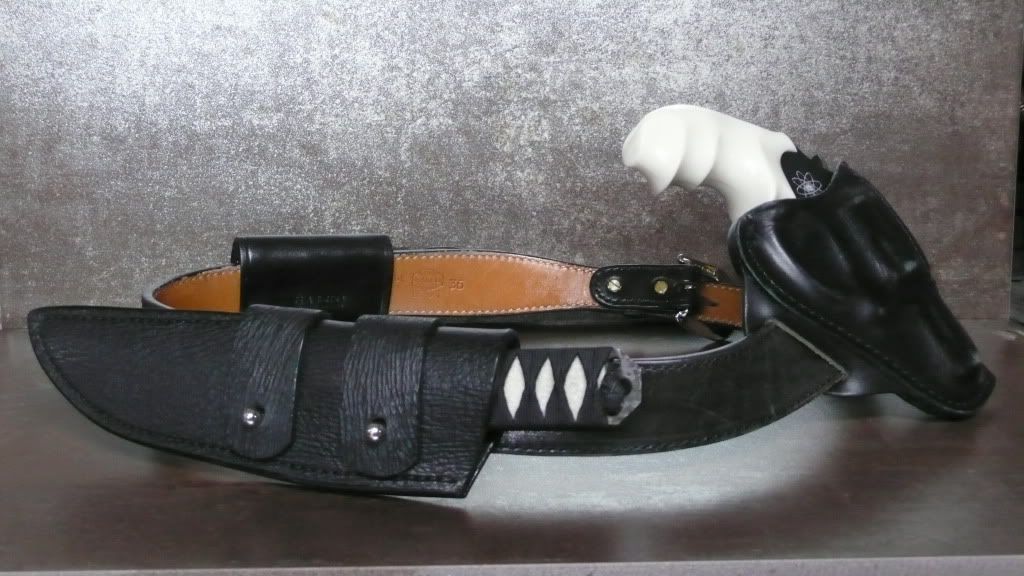

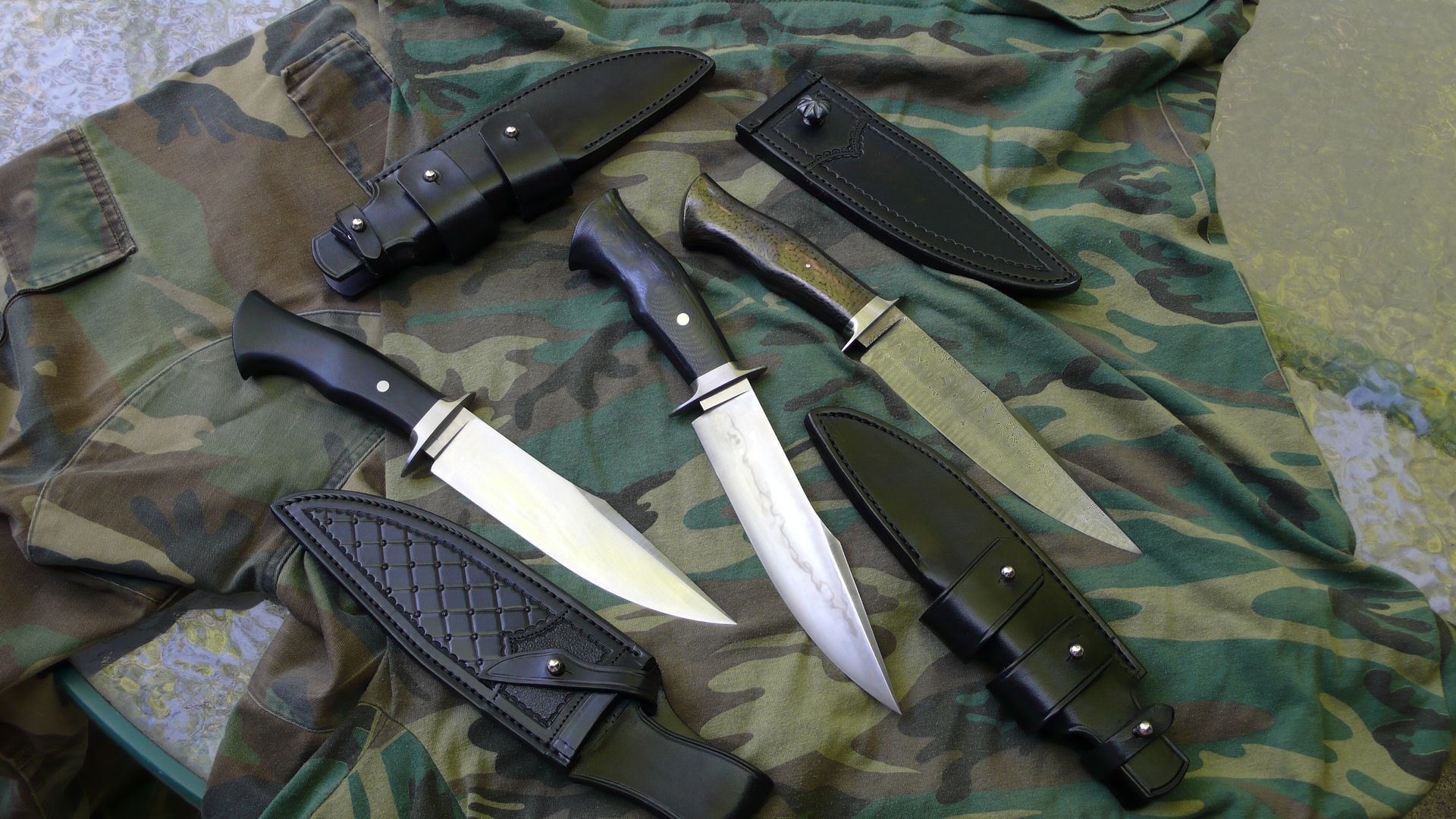

What is the length of the blade to the far right in your last picture? That one is sash?

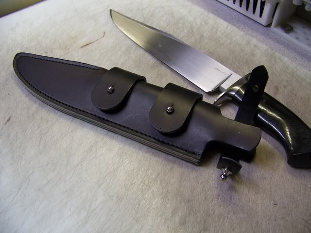

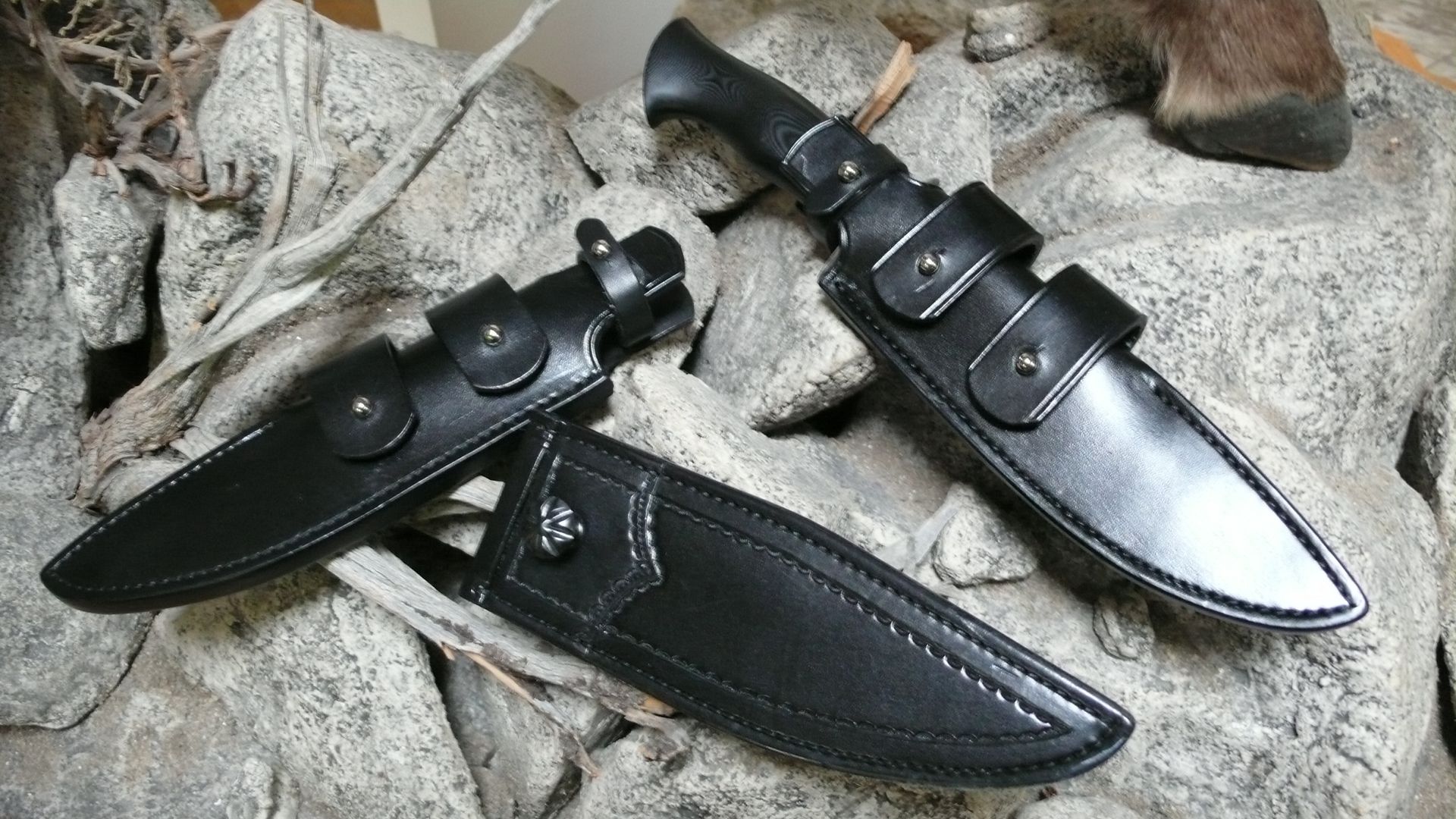

these are all the same they are the WHEELER FIGHTER run we did a few years ago
They are roughly 7 1/2 inch blades and just getting long enough that they work well in sash carry due to their guard imho you can sash carry smaller blades thaT are guardless in a pouch type sheath because you can slide them deeper in but in guarded knives you need blade length to get them to carry well

the best way to carry that sized knife concealed is sash with a stud and a static line
