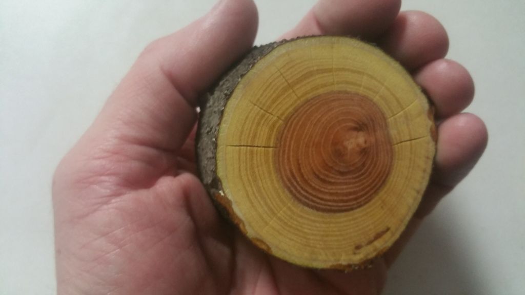

I have a question for you seasoned carvers. I just trimmed up my...what I belive Honey locust tree in the back yard and want to carve a spoon for my wife from it.
Here is a picture of a small cross grain cutting I made with my Silky Gomboy. Notice the cracks that appeared in it after drying on counter overnight.
My question is do the cracks occur when carving a spoon with the grain? And if so is there a way to prevent it?
Thanks
"Just trimmed" explains the problem. In a campsite where one was making a spoon to get through a weekend, using green, just cut wood would be no issue. Making something you hope to last however, is a problem. Wood needs to be "dry," before being used in this way. "Dry" in this case is a relative term and is a condition that needs to be, based on the surrounding relative humidity. There's a great book "Understanding Wood" by Bruce Hoadley, http://www.tauntonstore.com/underst...-070490.html?gclid=CPqGjfmezcsCFZSGfgod8-wEcQ. That explains all this stuff. Its the Bible.

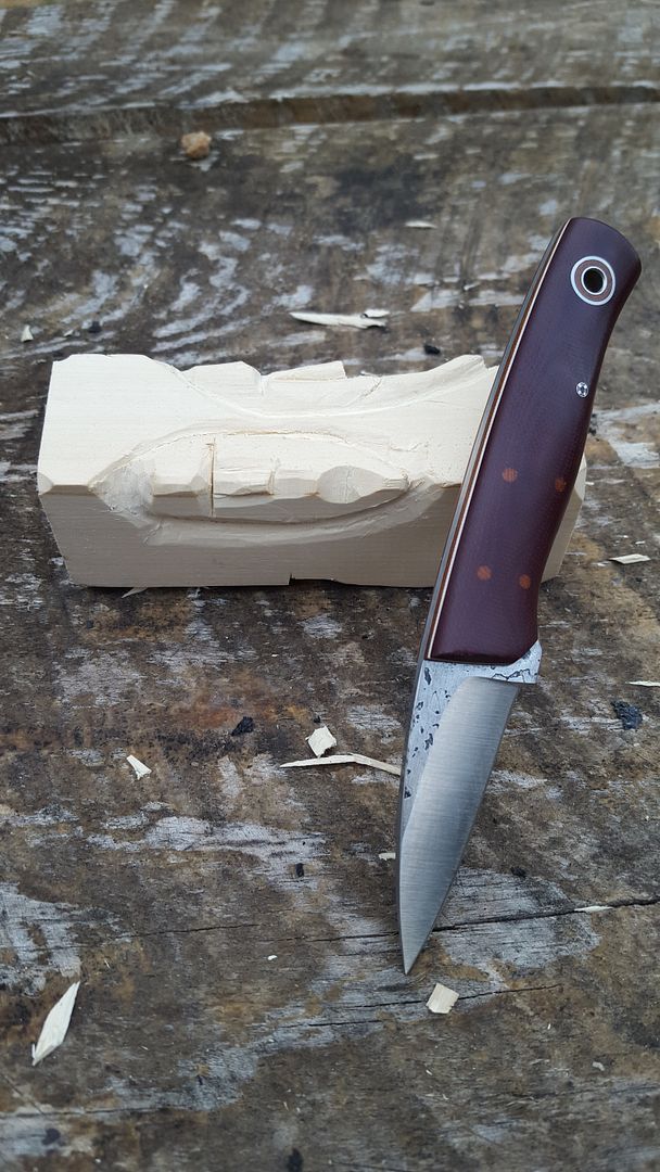

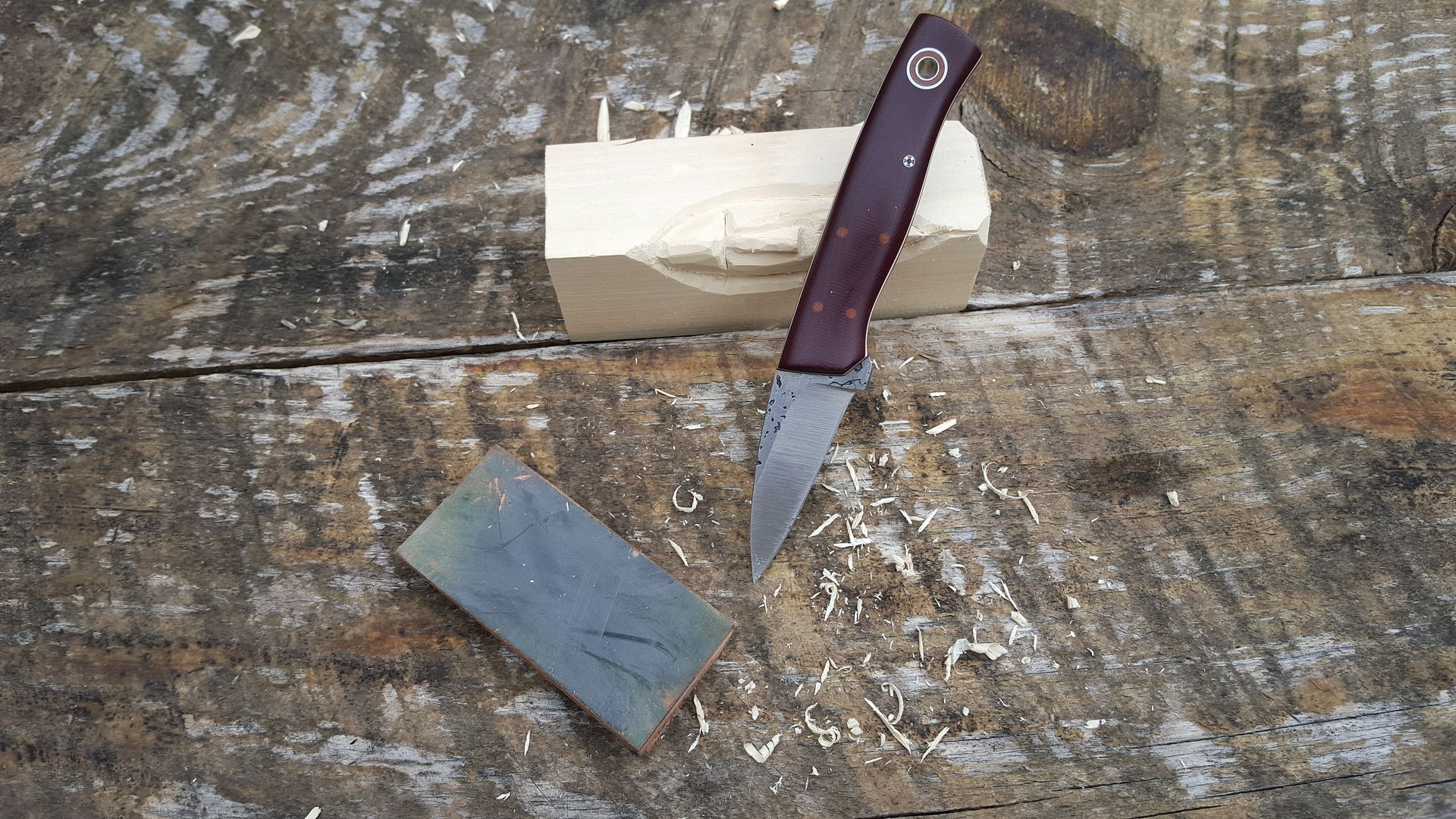

My first attempt at carving. Something got lost in translation from to YouTube video to the wood. So I strategically placed my EDK that I used.
second attempt
