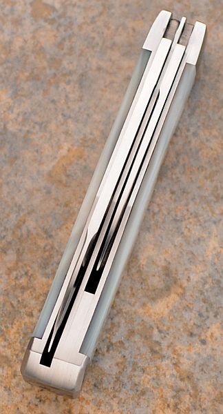

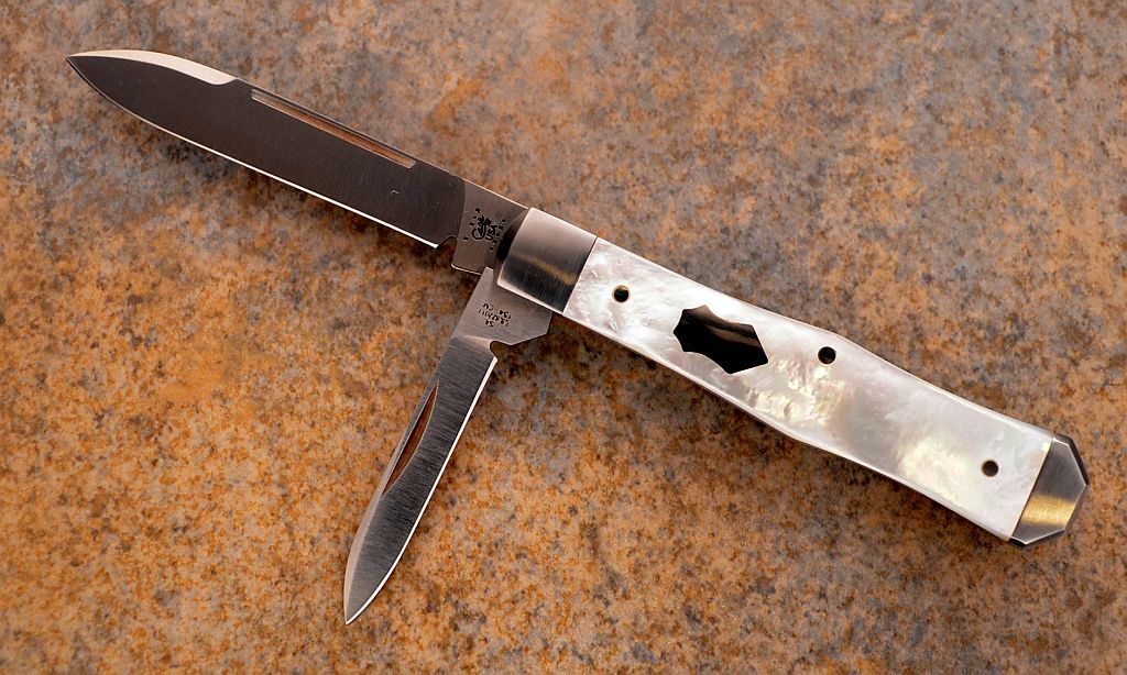

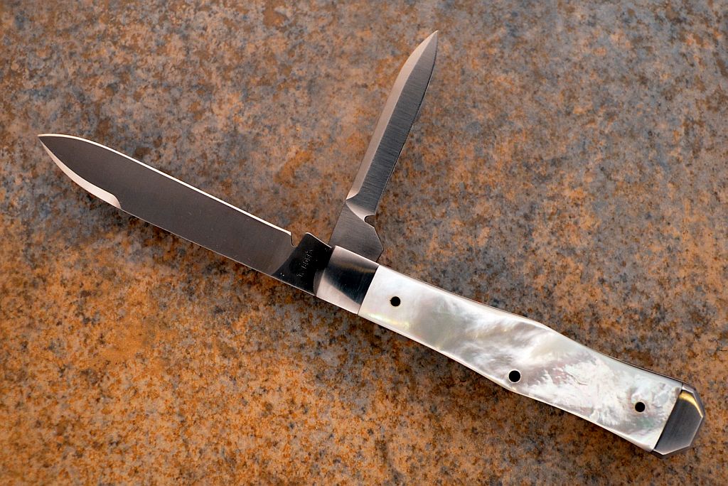

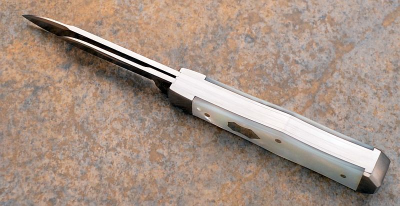

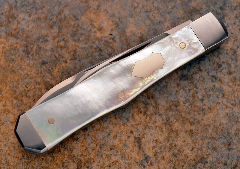

Tony had a few of the collabs lying around for signing, etc. and I found this one exceptionally worthy of shooting. MoP isn't very easy to shoot and get the "fire" that you see in real time but I hope you get the idea. Case uses some very fine MoP on their knives.
That one looks nice!!
