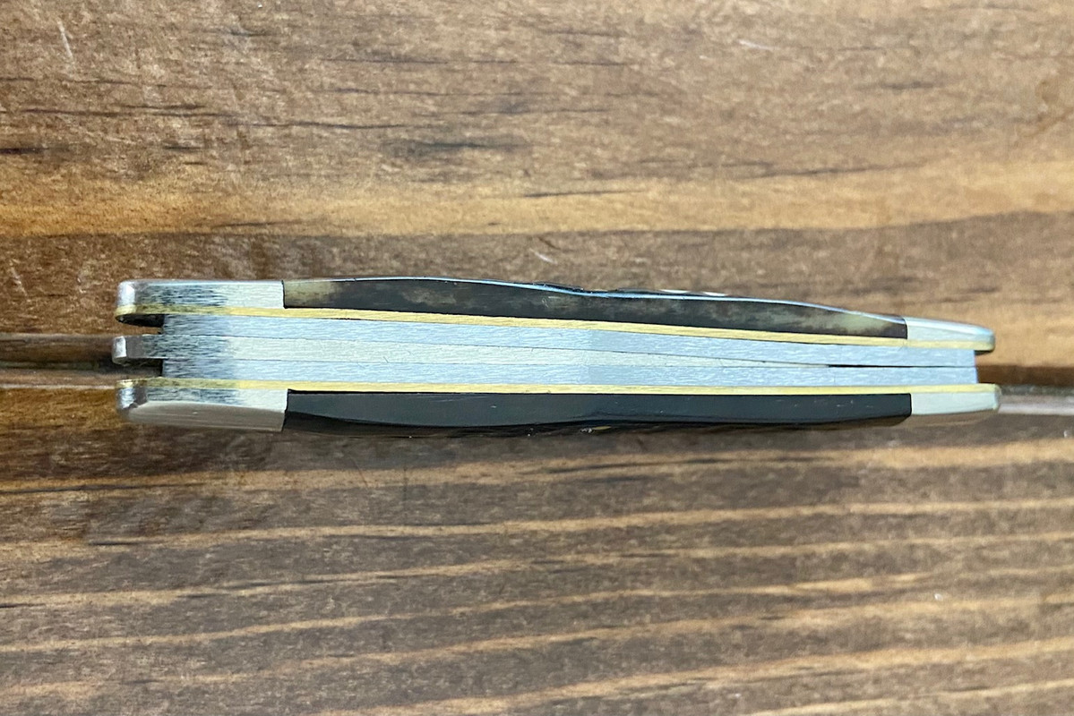

Not to nit-pick, I'm just trying to help... hope you understand. :)
A typical stockman has two springs, not split springs.
A split-springs have a tapered wedge between them, while two-springs lay side-by-side, sometimes with a liner between them.
Here's a split spring with the tapered wedge... Whittler
Here's a two spring with a liner... Jack knife
