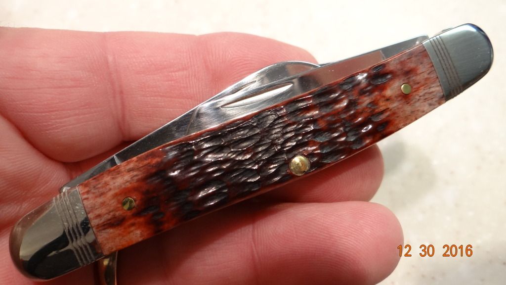

The top picture is of all 8 of the Rogers Jigged Walnut Bone that I now have after receiving the last 4 today. Notice that one of them stands out as different in color . They all are fine in F&F and function and not blade rub in any of them.

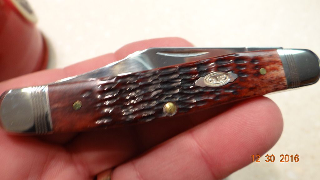

This is the one that stands out .

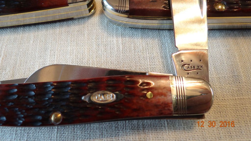

Notice that the Tang Date Stamp shows a blade made in 2015 even though the knife was supposedly made in 2016 . All others are date stamped 2016.
I Will Not be sending it back . It has a story to tell . I just wish that I knew all of it.
