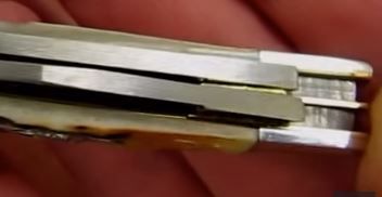

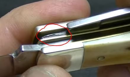

Good point. I guess what I'm hoping -- and (perhaps hastily) assumed from the video I posted -- is that the new 154CM trapper won't show the tell-tale signs of tumbling like you see on this example (screen-shot taken from this video):
To me, if Case would get rid of that flaw it would be a very welcome improvement.
As you can see in this screen shot of the new trapper, it sure looks like they did ..... at least a bit:
-- Mark
I thought the tumbling rounded the tips and edges. They do look a bit more crisp on these knives. They might be left "as ground" after the machining.
If I understand correctly, you've circled the run up in the first photo. Are you talking about the roughness of it? I didn't think that was from tumbling. GEC doesn't tumble their knives and the run up is sometimes pretty rough. Or maybe you mean that it's smoothed by the tumbling? The very corner just outside the circle is rounded over. I suspect that's from the tumbling.
I was thinking the same thing. That just looks like they didn't get all the slag cleaned up after the blade was cut out.

This has been discussed before. The rough run up on sometimes seen on 420HC blades (both Case and other brands) has nothing to do with the tumbling process. Case makes 420HC blades by fine blanking them. The metal sometimes tears a bit during the process and that section of the tang is not cleaned up. Because it has no affect on fit or function.

I'm pretty sure that the line isn't a scale surface or a tumble defect...just a sheared surface from where they are stamped out of sheet metal. The super steel probably has a cleaner break.
Sent from my XT1585 using Tapatalk
GEC and Queen knives have that same look on the tang, so it's not a Case thing. It's just how the knives are made. I wish people would quit highlighting that as some sort of manufacturing defect from a particular brand. I don't have all of my GECs out but I just took a look at a #15 and two #12s and they look "worse" than that Case photo.
The only knives I own that don't have tangs that look like that are Victorinox, Buck, my one Canal Street, and a couple of much older Case knives.

It takes a bit more to process 154CM compared to their other steels. For once, it's can't just be stamped out. It's likely laser cut, or cut out by water jet, both of which take a bit more time.
