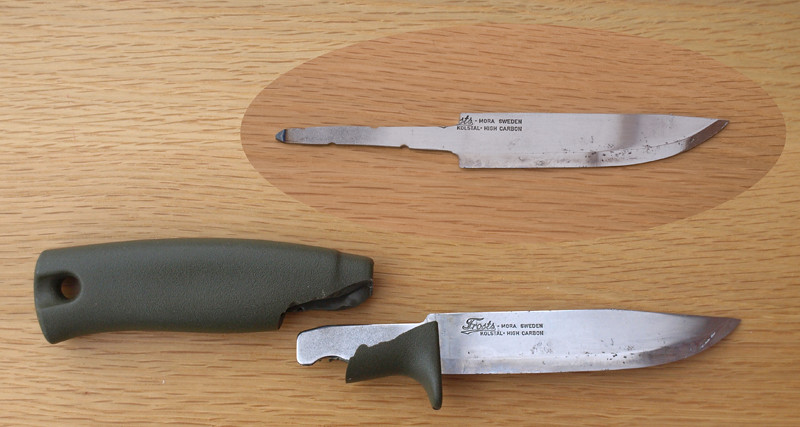

1/8" thick steel is not stiffer than a 1/2" aluminum and steel laminated together. Nor is FRN as stiff as aluminum:

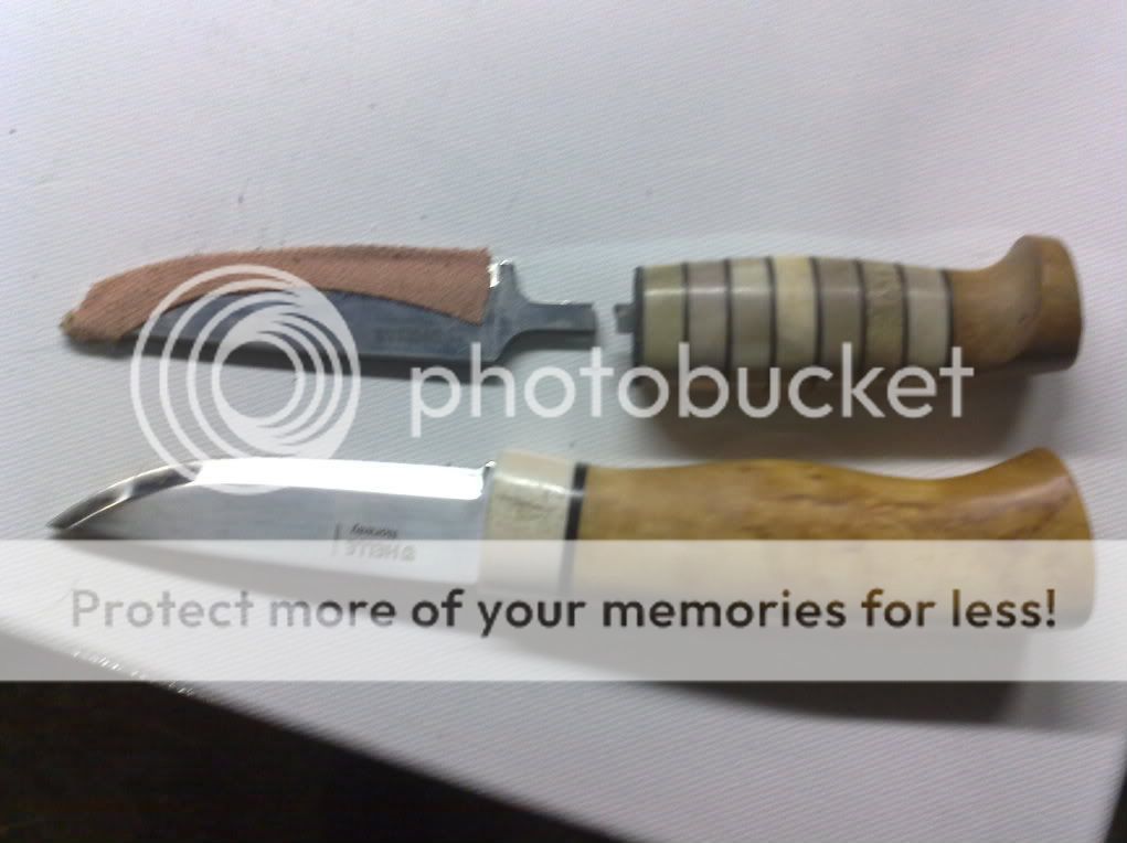

This is what happens when your handle material does not support the underlying tang:
On full tang knives the handle doesn't carry the load, so the knives weak point is often the the narrowest part of the tang or the furthest forward pin hole in the tang. The strength of full tang knives is entirely dependent on how many holes there are, where they are and what support the scales can provide to prevent the tang from flexing.

Every example you provided was not failure due to the material weakness of steel, but rather failure due to structural design of the blade. Those failed at holes or thin hidden tangs. These are textbook examples of design elements causing stress concentrations in a piece under load.
