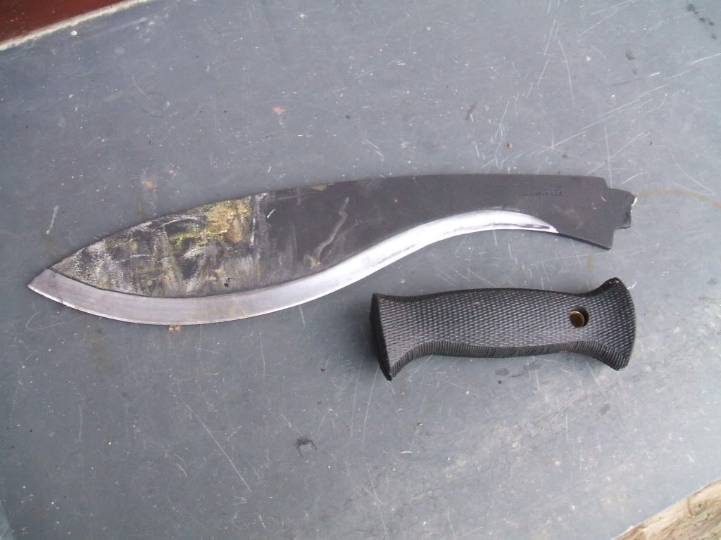

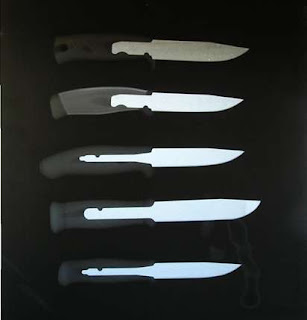

Those pics illustrate a point I've been making - the weekest point on those blade is the narrow part of the tang located 1" behind the ricasso. Soft plastic/rubber handles don't support that area, allowing it to flex. Busse's use very thick stock, so it isn't really an issue. But if you want a 1/8" stock knife blade, the weakness becomes more of a factor.
It was an issue for this similarly made Cold Steel Kukri, though. That tang didn't fail in front of the handle, but well inside it:

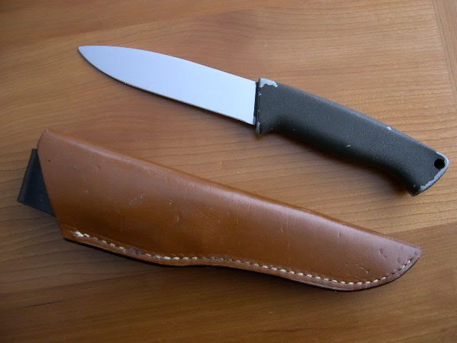

I've always wanted a Gerber ArmorHide A475 (not my pic)
But I also rarely see a Mora with broken tang despite the plastic handles. (again not my pic)
Indeed, one must wonder what great efforts it took to break the CS kukri-machete presented. I rarely see broken hidden-tang Bucks or even Kabars despite their enormous prevalence (the odd Kabar here or there vs. the millions about), broken SRKs or Randalls, etc. much less broken Bussekin. What i present to you is that whatever force is required to bend/break that steel tang is MORE than enough to bend/break the aluminum handle trying to support it unless that section of handle is ~2X thicker than the piece of steel being bent. If the fracture in the tang is due to impact-shock at an inclusion in the steel, again the aluminum doesn't help. While i have no doubt that the cast-in-place design will sell (those Gerbers sure did) I am not convinced it will lend any noticeable superiority in handle strength over a more comfortable material like plastic/micarta/wood where the tang provides the necessary strength, not the handle around it.
