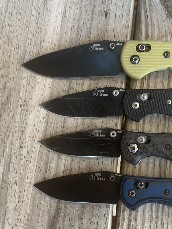

After debating back and forth I finally decided to circumcise my Mini Grip. Was looking forward to doing a little tinkering and rekindle the love I had for this guy years back when I bought it. Goal was somewhere between a 550 sheepsfoot and a 940 blade. I used a $30 dremel with little cutting disk, spritzed with water every few seconds and checked with a bare finger to ensure it wasn't getting to hot. Finished up on a belt sander to smooth any little burs and match the grain on the spine as close as I could. Ended up very pleased with the results!

I like it. Looks like a stout little blade now.
Stout is about the perfect way to describe it! I figure I took off about 9/32" or so of total blade length dropping it from the reported 2.91" down to 2.625" so while the shape makes it look a little stumpier it didn't lose all that much length.

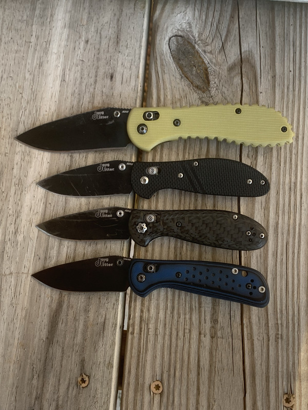

Benchmade 945 Mini Osborne with a MagnaCut blade.
And today I added a set of titanium scales, new clip, and a full set of blue anodized, titanium hardware... Pivot, screws, thumbstud, stop pin, standoffs.
I'm pretty pleased with how it turned out. :)
