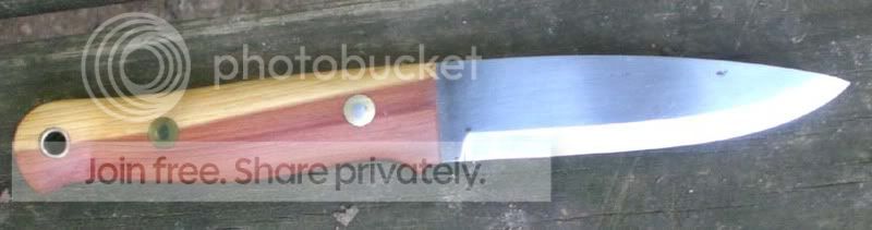

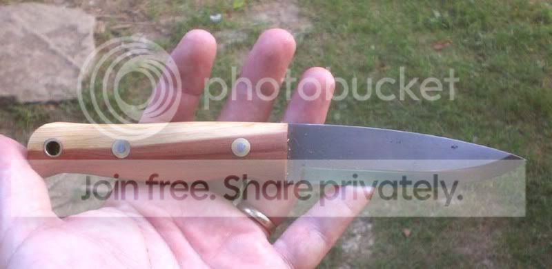

With some sort of finish it should be fine. I rehandled a knife with a scrap 2x2 that I'm assuming is Fir, which is pretty soft, but other than imprints from my ring, it's holding up just fine, even for fishing, but I sealed it with linseed oil and pine pitch.
Well I think I would leave it plain, a coating or stabilization won't make cedar any harder or dent resistent. Like you said HD if something happens to them, changem out. And you could put a notch in the handle and make another cedar dowel and the knife would make a base for a fire/bow drill. I see pics of you working on the pharm and I think by using it it would finish well with several coats of sweat and the oil from your skin. Pat
Not sure how it will hold up but I had this Bushcraft blade that I put too thin scales on so I thought I'd change the scales. Tried this cedar. We'll see. I think I maybe need to put some sort of coating on it but I like the way it looks.

use some Pentacryl to fill the cells and pores of the cedar, then tung oil the outside and buff with 0000 steel wool.
Hey maybe it'll get dinged and take on character like old pine floors. I really like those above all other flooring. You may be onto something HD.
A coating will not give any significant dent resistance on soft wood but stabilization forces resin deep inot the structure of the wood and makes it a new substance. Done properly it is roughly the same as the process used in Micarta and G-10. The wood is no more the same wood you started with than Micarta is still a pile on canvas or paper.
An epoxy based resin will bond the pourous wood fibres together. This matrix gives you a thick, hard outer crust depending on penetration.
